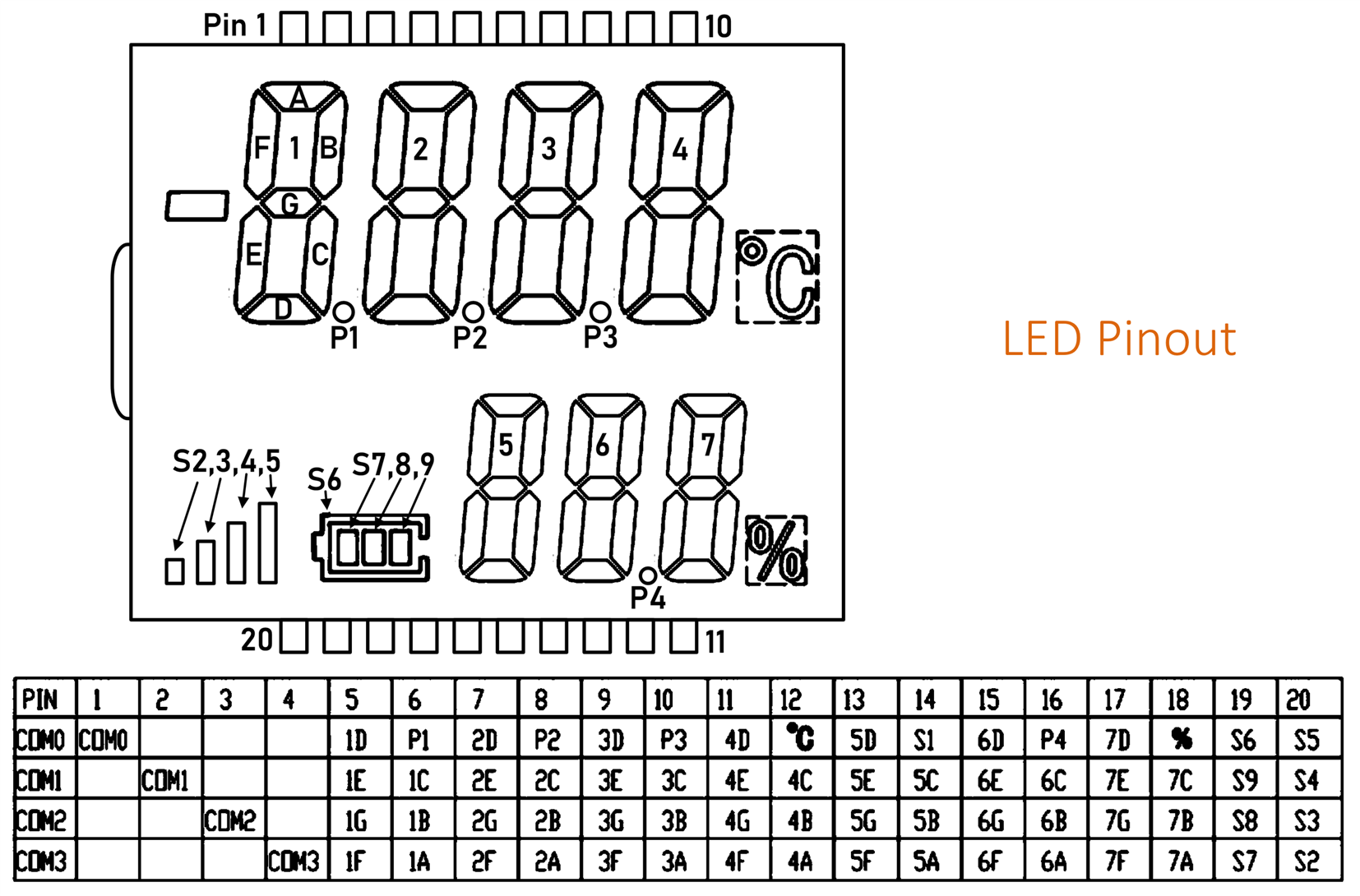

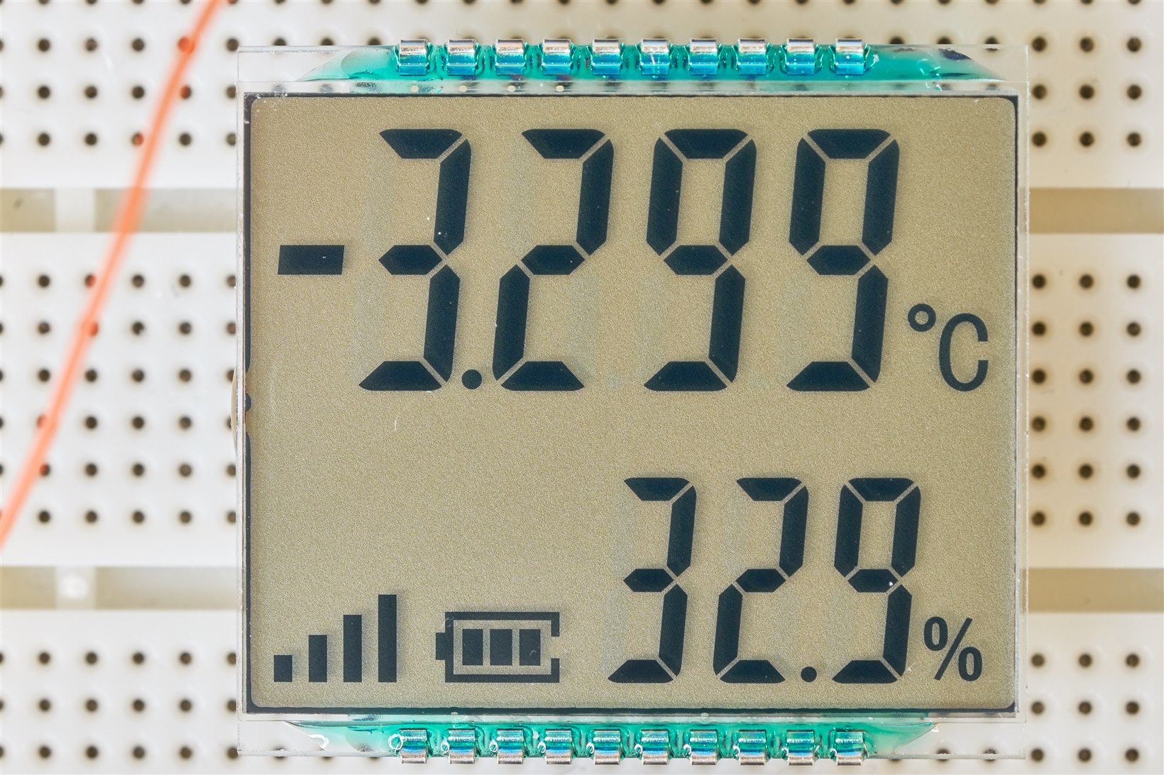

I was interested in finding a large segment LCD that could be read from several meters away, with dual number fields, so that things like (say) voltage and current could be displayed simultaneously, or time and temperature, or temperature and humidity, and so on.
The display I used has digits at the top and bottom, which are 14 and 11 mm high respectively, and I can read them from a distance. I also liked that there were signal and battery level indicators that could come in handy.
The display comes in two compatible variants; one with a fully reflective backing sheet and another with a slightly translucent one for optional backlighting. The photo below shows the variant with no backlighting.
Please read the earlier blog for more detail on interfacing, configuring, and coding for segment LCDs with Renesas RA microcontrollers. This blog post merely shows how to pick almost any arbitrary segment LCD and get it working with the microcontroller. With LCDs with multiple fields, such as the one here, it is desirable to have functions that can update portions of the LCD without re-writing all the data for the rest of the display, so I figured writing a blog for such a scenario would be interesting.

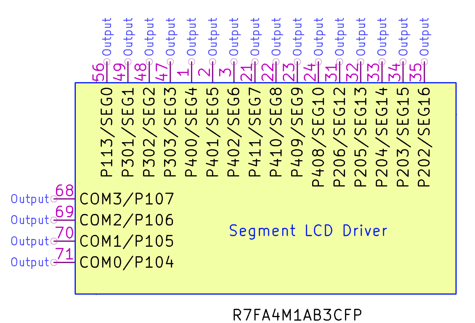

LCD Connections
The LCD is wired up to the Renesas RA4M1 microcontroller in a similar way as described in the earlier blog post. The only difference is that the LCD used in this blog post has 20 pins (4 COM and 16 SEG pins) versus 12 pins (4 COM and 8 SEG) in the previous one.
Here are the connection details for the GPIO pins configured for Segment LCD driver output for the TQFP 100-pin RA4M1 chip:

Summary
It’s fairly straightforward to add larger segment LCD screens to the Renesas RA family microcontrollers. The code allows for independent control of the two groups of digits, and the battery and signal strength level displays.
Since there are lots of wires connected to the LCD (20 pins), it would be worthwhile creating a circuit board.
