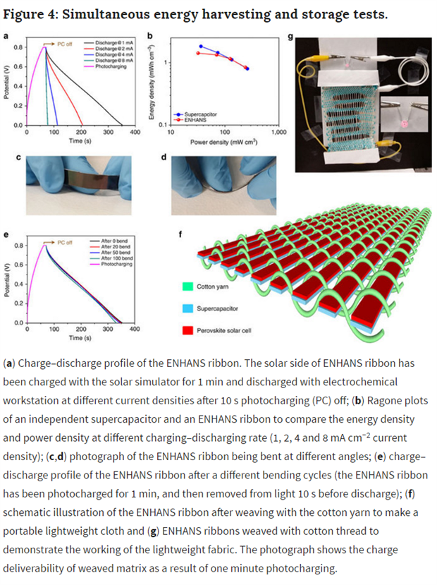

A team from the University of Florida took inspiration from the popular franchise for a new type of wearable tech. The solar panels are integrated into the woven fabric (image via University of Florida)

Rather than using chunky batteries, the team created solar power clothing with the ability to store the sun’s energy. They achieved this by making filaments that can be crafted into textiles, which then give them the ability to store and use the sun’s energy. The filaments are made out of flexible copper ribbons equipped with a solar cell on one side and an energy storing layer on the other side. It's a type of "supercapacitor" material. Which is genius, since the cap' can efficintly gather all energy generated from the solar cells quickly. With an entire shirt, let's say, all made of supercap material... the surface area of said capacitor would be enormous. The energy density they claim is 1.15mWh/cm^3 (and a power density of 243 mW/cm^3).
During the testing phases, the team sewed them into a square piece of yarn, which can then be sewn into jackets or other outwear to get energy to power devices, like phones. This new tech improves on the major limitations of solar cells. Traditional cells are limited in their portability since they have to store the energy they produce in battery or have it flow into a power grid.
