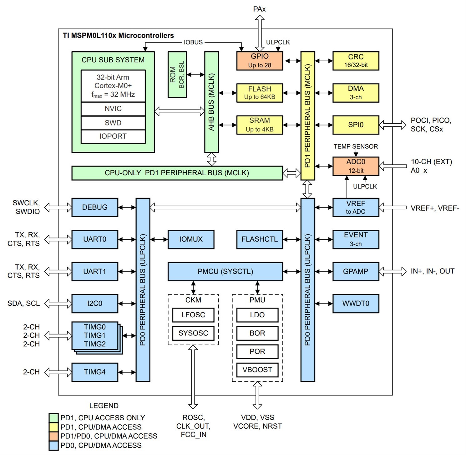

I was browsing the Texas Instruments (TI) website, and noticed they had some very low-cost, very basic ARM Cortex-M0+ microcontrollers. I was keen on finding something low-power, small (but hand-solderable), and cheap. I aim to eventually use such a chip for interfacing to simple sensors for a few possible projects (one requires some sort of low-accuracy current sensor, and another requires an presence sensor), so all I require is a basic built-in ADC, I2C, SPI, or perhaps UART, and either control an output, or send text to an I2C LCD display, or perhaps write to external SPI storage.
In the end, I decided to order a few parts from the TI MSPM0 L-Series, which they class as low-power, and I found a 28-pin variant which has a fair amount of general-purpose input/output (GPIO) connections.
The microcontroller doesn’t have any particularly remarkable features, other than the very low power consumption and cheapness, and the fact that it doesn’t require many components at all, not even a crystal oscillator. Just a few decoupling capacitors are all that’s technically required.
(Image source: Microcontroller PDF Datasheet)

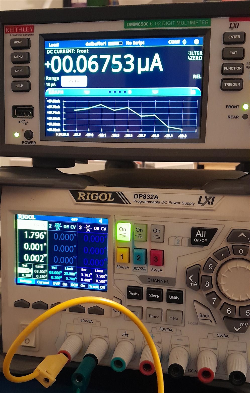

In shutdown (with GPIO wakeup capability), current consumption is apparently 61 nA, which seems pretty low. RAM can be maintained and timers can be running in a ‘standby’ mode, where current consumption is 1uA, which also seems reasonable.
One more thing I really liked; it has an in-built bootloader that can accept firmware over the serial (UART) port, so that no separate programmer device is required for in-the-field updates. You could just attach it directly to a PC and program it up.

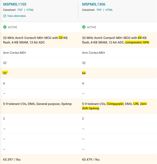

The particular part I went for is the L1105 (the full name is MSPM0L1105TDGS28R), which has 32 kByte of Flash memory and 4 kByte of RAM, but there is a pin-compatible L1106 upgrade part with 64 kByte of Flash if needed.
In terms of major downsides, there’s no ability to add a crystal oscillator if you need such precision. Interestingly, as a compromise, the chip can use an external 0.1% tolerance 100k resistor in order to create a reasonably precise internal oscillator, but it won’t compare with a crystal, of course. I would have liked an accurate RTC, but I suppose that could always be an external I2C peripheral chip, perhaps with a separate backup battery.

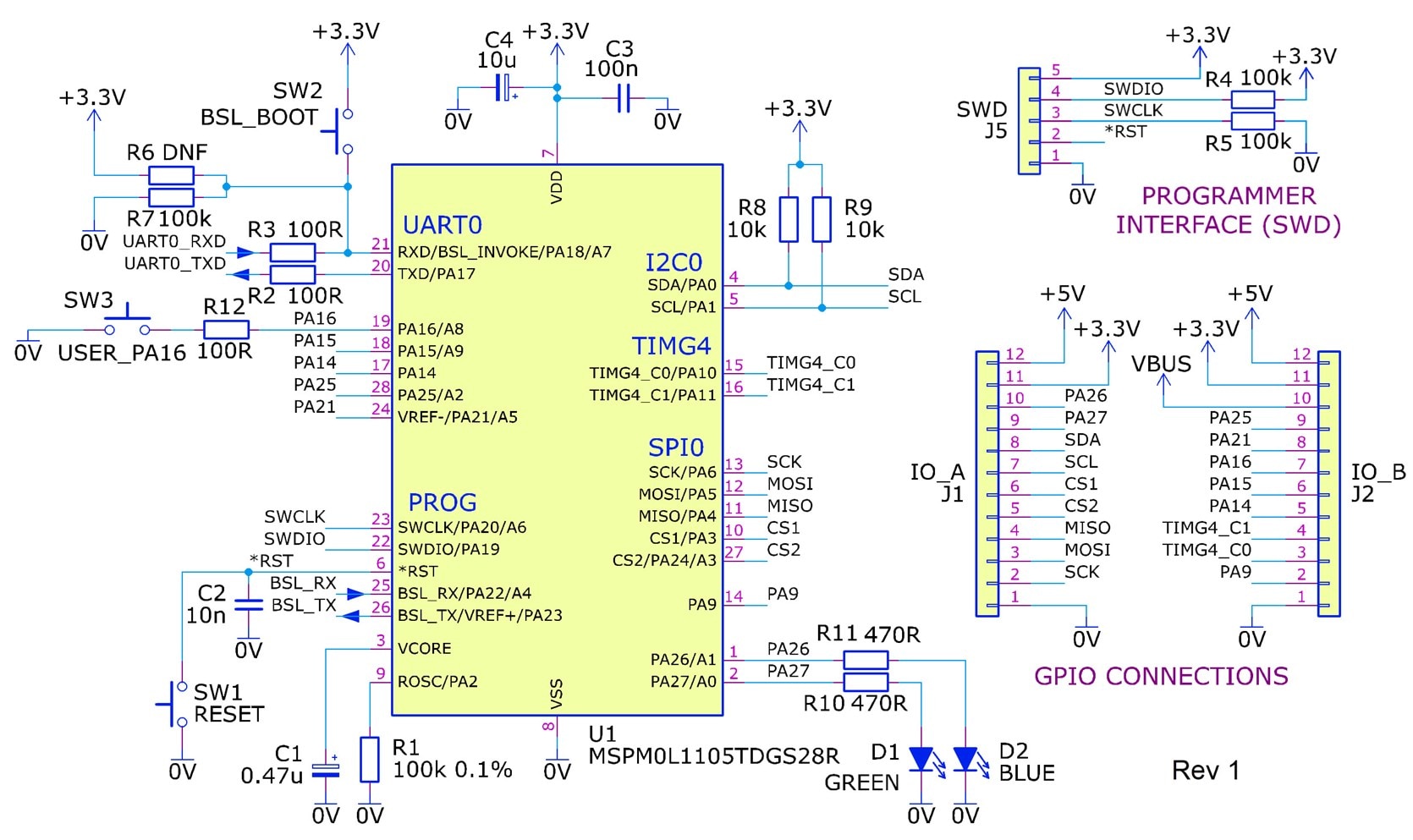

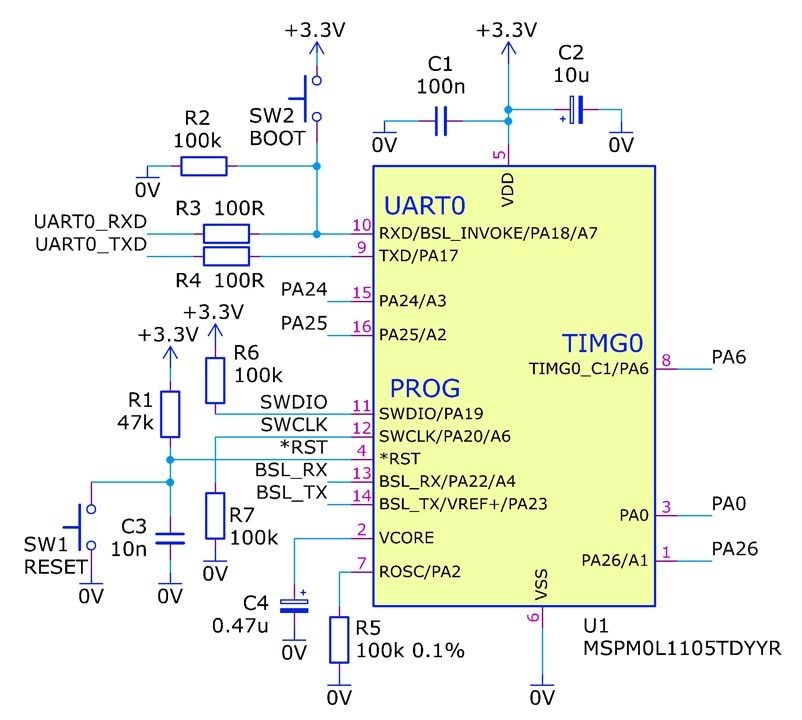

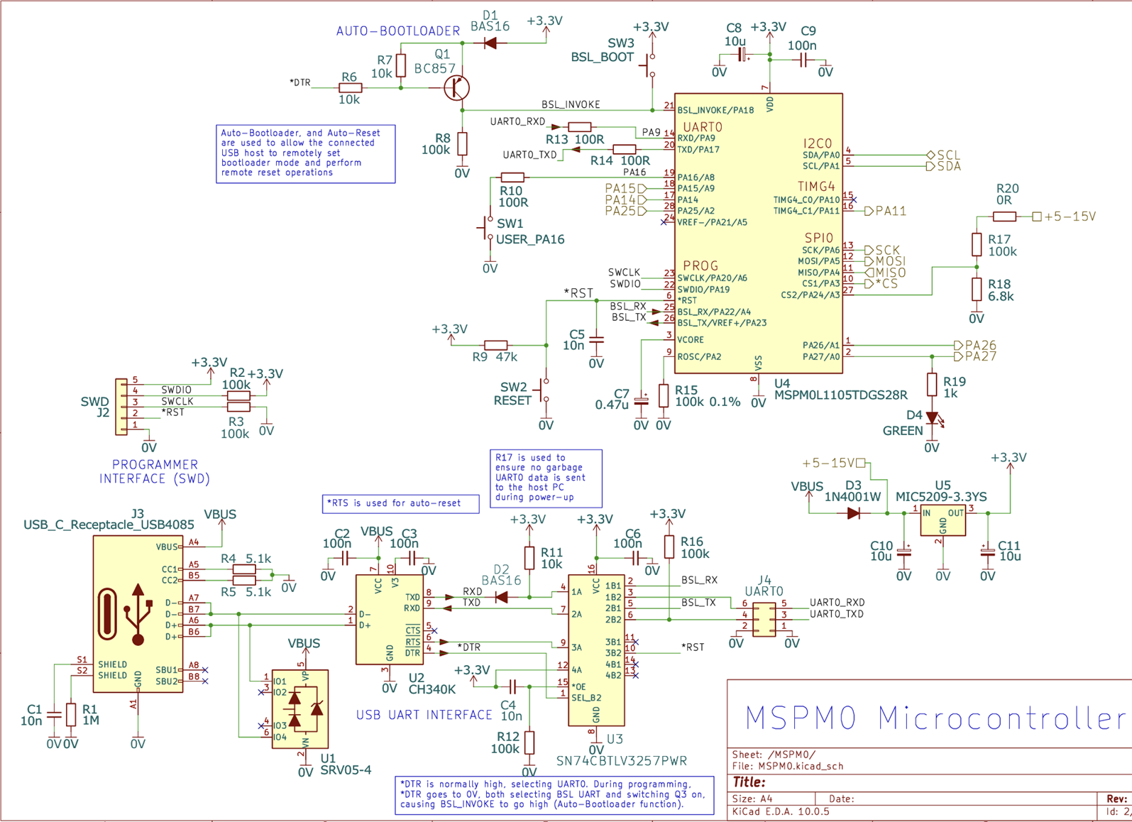

1. Microcontroller Core
The core of the circuit is shown below (click to enlarge).
This doesn’t do much, other than breaking out most of the microcontroller connections to 0.1” pin headers. I took a reasonable guess at how the pins might be used, and so some are labelled with I2C and SPI connection names. A couple of pins are useful for timer-based input/output capabilities; for instance, one could use them for attaching a rotary encoder. As a simple user interface, the circuit has a single button (SW3) and a couple of LEDs attached to GPIO pins; it’s up to the user to write code to make use of that button and the LEDs.
There is a 5-pin header, J5, that can be used to attach a traditional SWD JTAG programmer device if required.
The BSL_RX and BSL_TX connections are used for uploading firmware via serial. To enable this, there is a BSL_BOOT button that needs to be held down during a reset. There are some non-populated resistor pads attached to the BSL_BOOT switch, because I’m unsure if that pin floats, or if the user may wish to permanently set that to a particular level.

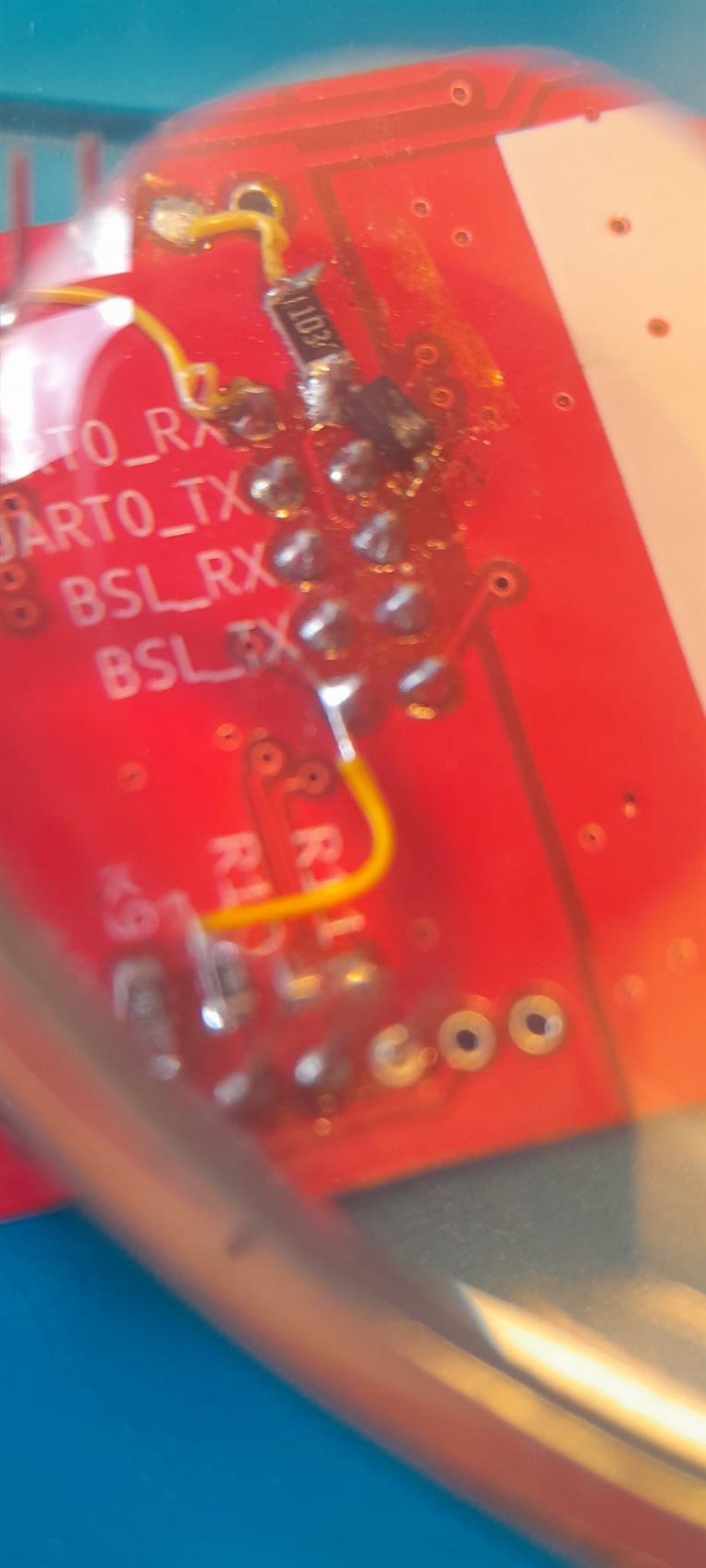

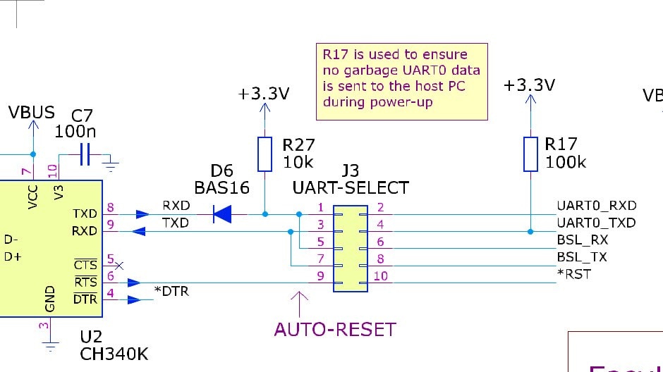

Note: It was later discovered that this Rev 1 circuit is missing a 47k pull-up resistor, from the *RST pin (pin 6 on the microcontroller) to +3.3V. It was easy to patch onto the underside of the PCB.

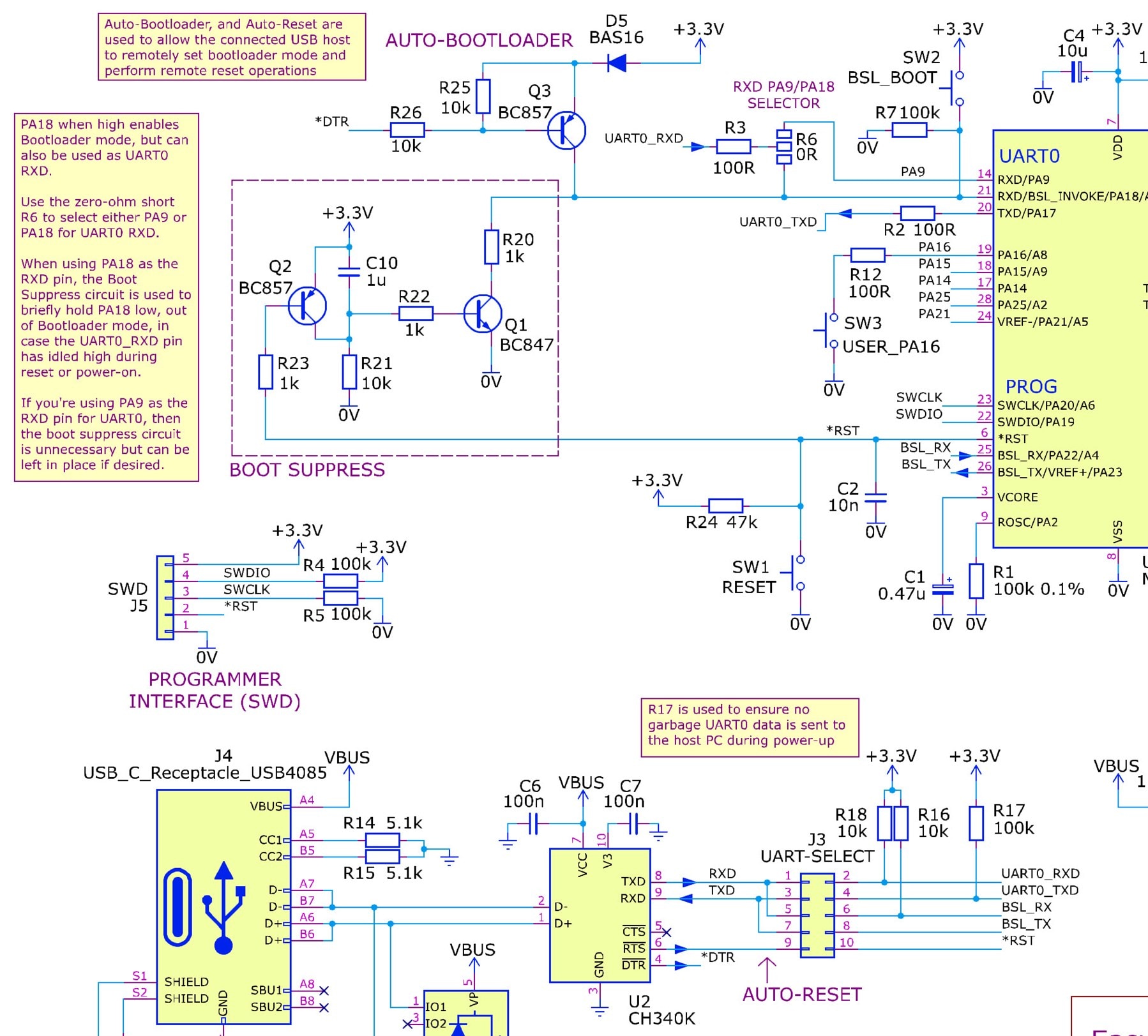

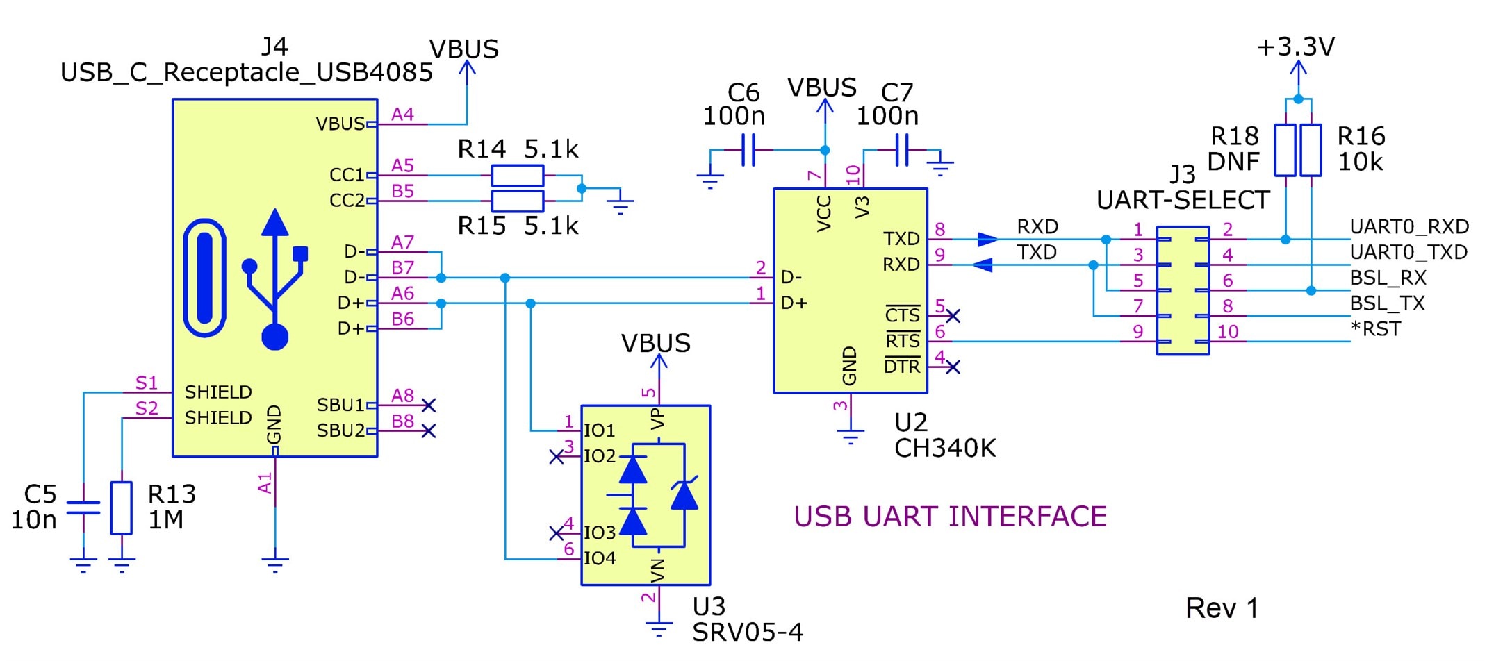

2. USB UART

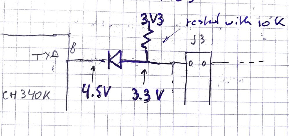

Since I was keen to use the serial bootloader, the dev-board contains a USB-UART adapter. It’s based around a CH340K USB-UART chip, which I’ve never used before. The chip is a little unusual in that it uses pull-up resistors on the UART side if the chip is powered from 5V and not from the (lower) microcontroller voltage; that’s the reason for R16 on the right side of the circuit (R18 is not fitted, otherwise the microcontroller will always start in bootloader mode!). After some discussion with Jan Cumps  it's likely R16 is not needed, so it could potentially be removed (depending on if the RX pin is floating or not on the microcontroller). The microcontroller reset pin is wired through a jumper on J3 to the RTS line, in case it is possible to automatically reset the board from the PC (if you're using the official TI app, UniFlash, then it's not possible, and the jumper needs to be removed). You would still need to manually press the BSL_BOOT button (although, if the microcontroller is new from the factory with the Flash erased, then for that first time the BSL_BOOT button doesn’t need to be pressed).
The pin headers labelled J3 are used with shorting jumpers to redirect the USB-UART from the BSL pins to alternative pins for UART0. This is so that the same USB-UART can be used for general program serial input/output, too.

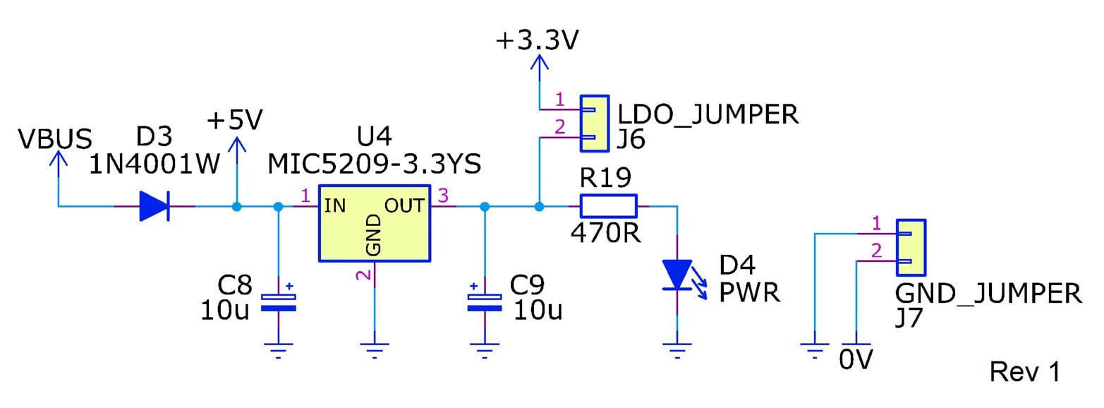

3. Voltage Regulator
The final bit of circuitry is a 3.3V regulator, which can be powered either by the USB connection or from a 5V labelled connection that is exposed on the GPIO pin headers. The two shorting jumpers can be used to separate the power to the microcontroller portion of the circuitry from the rest of the board. By removing the shorting jumpers, you could wire in a separate power supply if desired, or attach current measurement circuitry.

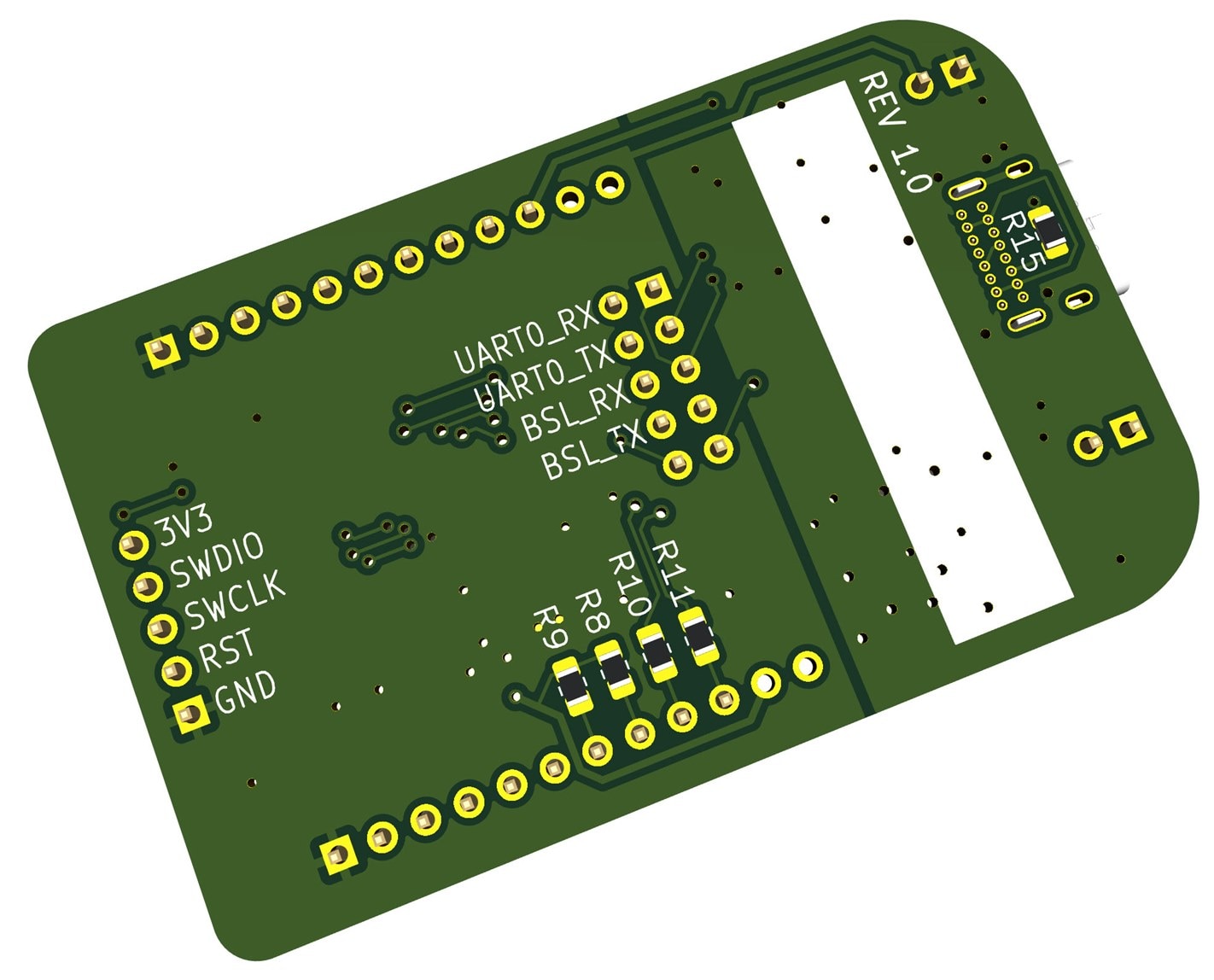

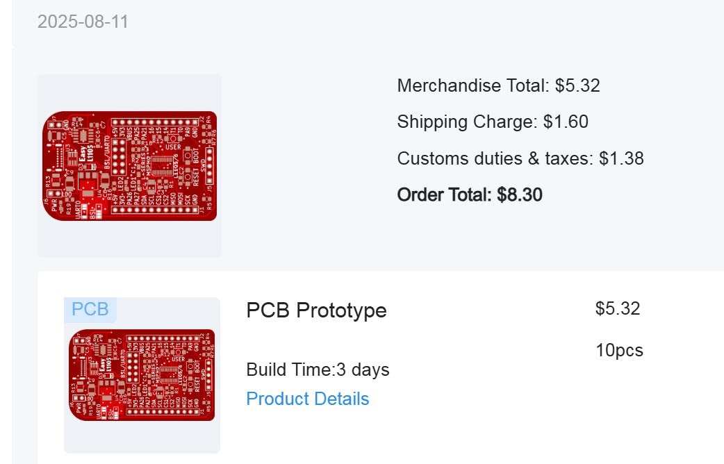

Circuit Board

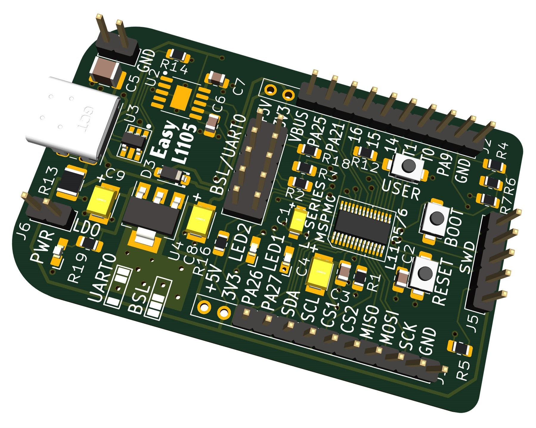

An approximate render of the circuit board is shown below; it is about 60 x 40 mm.
Underside:

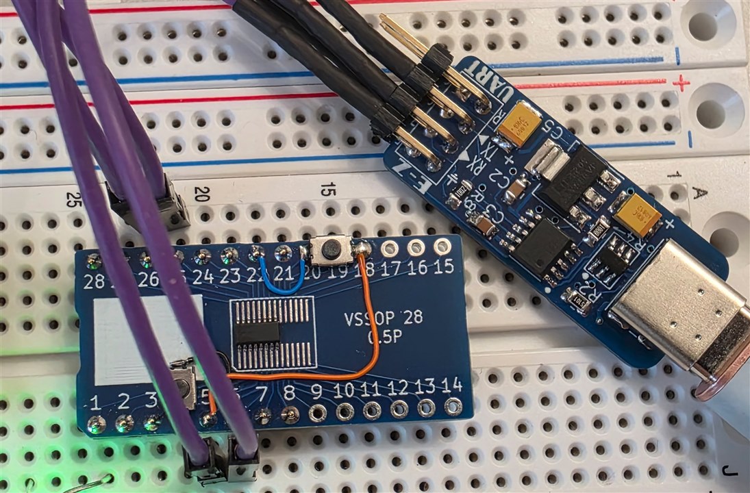

    Maybe worth mentioning how I'm soldering this. Apologies for the low-quality photos, they were taken with mobile phone. I used a small bent-conical tip, but it's not that critical. First step, apply…

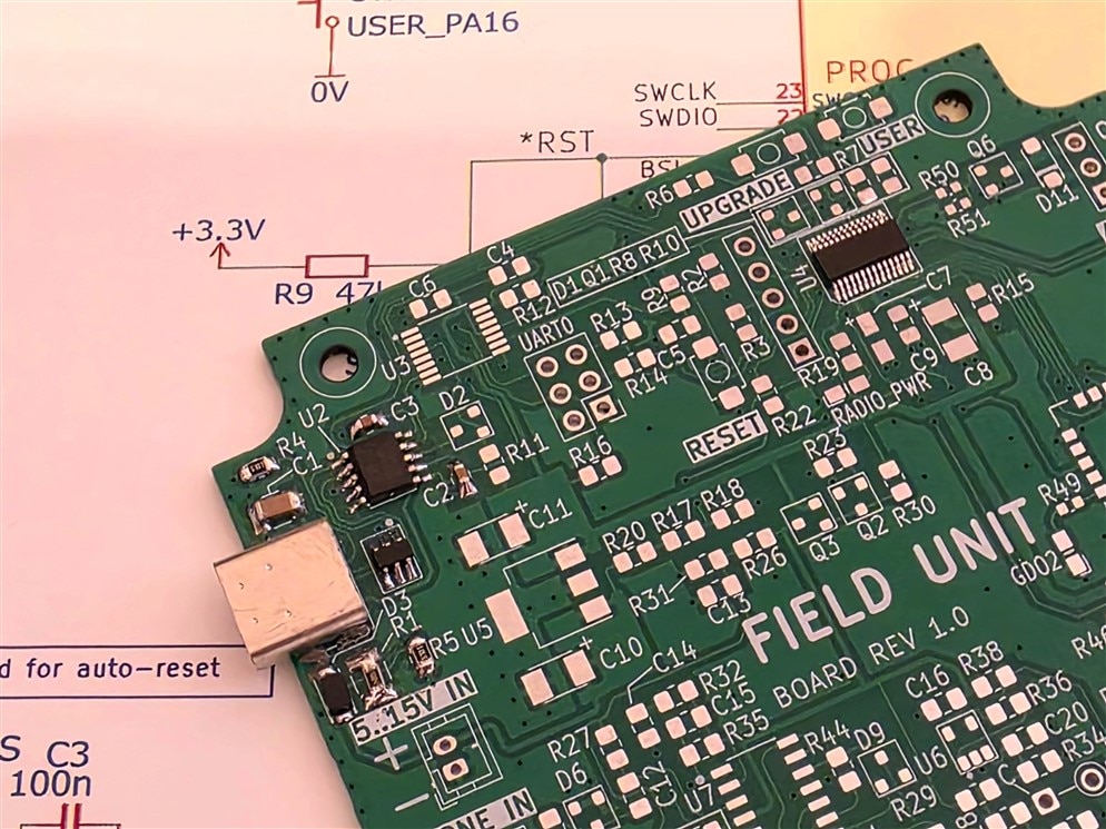

    shabaz 4 months ago +1
    Finally upgraded the PCBs for EasyL1105 and miniL1105, to revision 2.0! Gerber files are here . The EasyL1105 board is now a tiny bit longer, because the components were squashed up otherwise. This board…

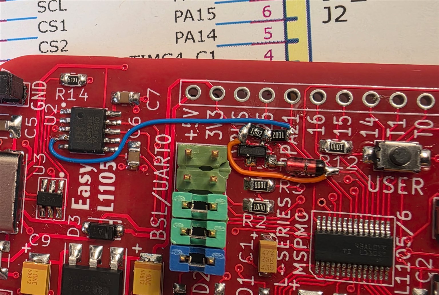

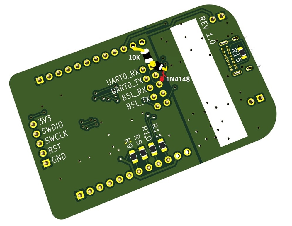

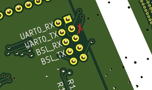

    shabaz 1 month ago in reply to shabaz +1

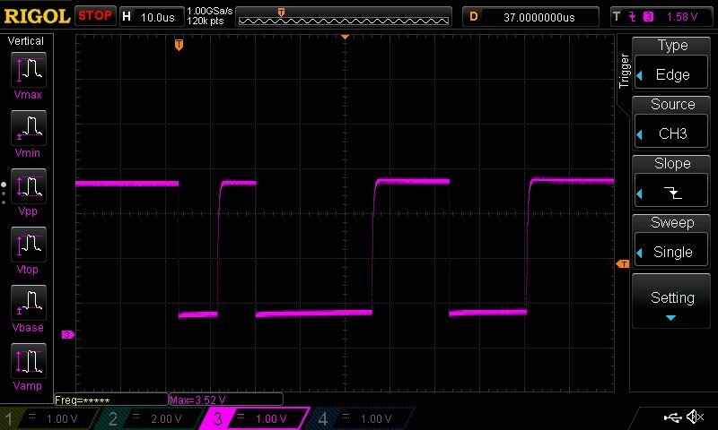

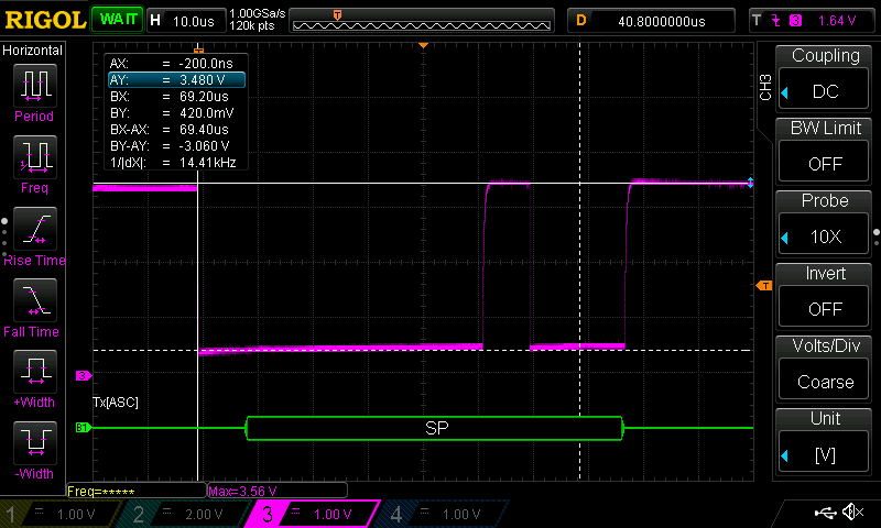

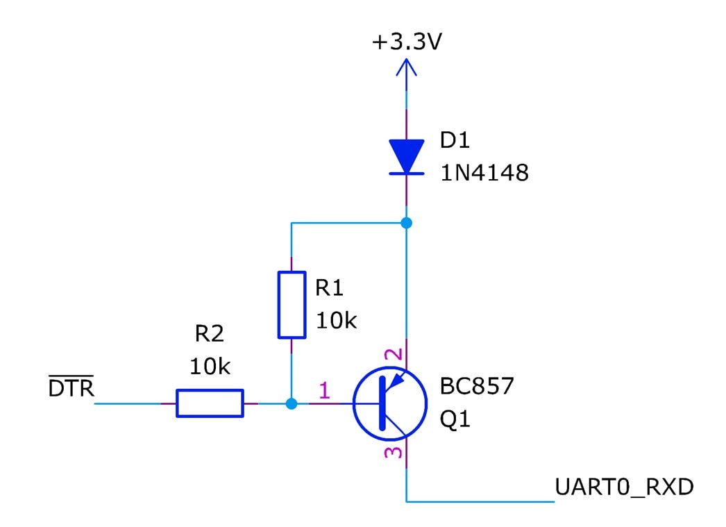

    So close, yet so far! I messed this up. This is the faulty circuit: I made a semi-fix by moving *RST to pin 11 of U3. It is still not great, but works to an extent. With this semi-fix, the bootloader…

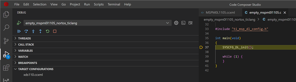

    I've been trying to set up a development environment, it's going to be a two-pronged approach.
    The two prongs are Keil, and plain GCC via command line (so that it can be used with VS Code, or any desired code editor/IDE).
    I'm ignoring TI's CCS because personally I don't like it.
    I've not used Keil much before, but it's not as bloated as CCS, and has a very traditional IDE feel like before Eclipse got too huge.
    It took a while, but I've got a simple project created in Keil, and it builds, although whether it will work I have no idea until I build up a board.
    The source code is simply this:
     * main.c
    #include "ti_msp_dl_config.h"
    #define LED1_PIN   DL_GPIO_PIN_26
    int main(void)
        SYSCFG_DL_init();
        DL_GPIO_enablePower(GPIOA);
        DL_GPIO_initDigitalOutput(LED1_PIN);
        DL_GPIO_writePins(GPIOA, LED1_PIN);
        while (1) {
    If that works, then an LED should turn on. This uses TI's DriverLib which is fairly reasonably documented here (click on Modules to see the areas of functionality that it covers).
    DriverLib is a basic API, it's still fairly low-level, it mostly just allows you to abstract away from register addresses, and the functions are not complex. This is good, because the microcontroller does not have a lot of memory, it would not be nice to use libraries with excessive features.
    I'll now try to get that same code to build using GCC and then document the steps somewhere, and then (probably in a few weeks when the boards arrive) focus back on the serial bootstrap loader feature.

    Done, although it was very tight with some of the parts, and the silkscreen etc.
    Anyway, the Gerber files are at the same GitHub repo. I'm keen to use this, since I don't have a preferred very-low-power microcontroller choice these days, so this might be it.
