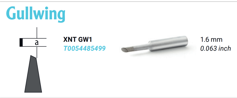

    shabaz over 1 year ago +1
    Maybe worth mentioning how I'm soldering this. Apologies for the low-quality photos, they were taken with mobile phone. I used a small bent-conical tip, but it's not that critical. First step, apply…
