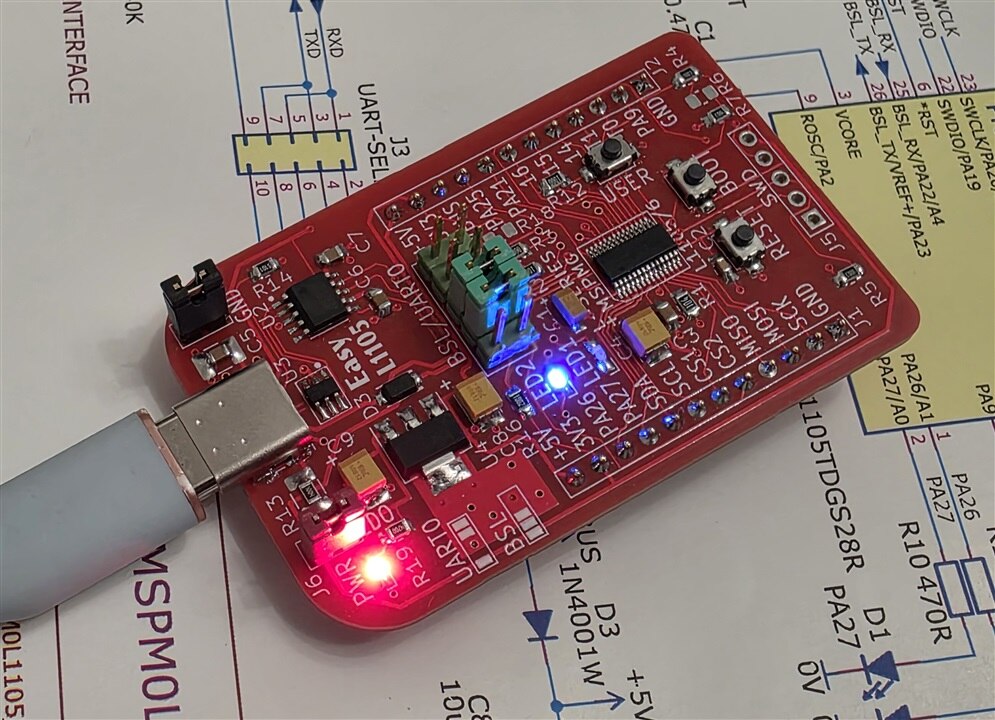

Circuit Board
An approximate render of the circuit board is shown below; it is about 60 x 40 mm.
Underside:

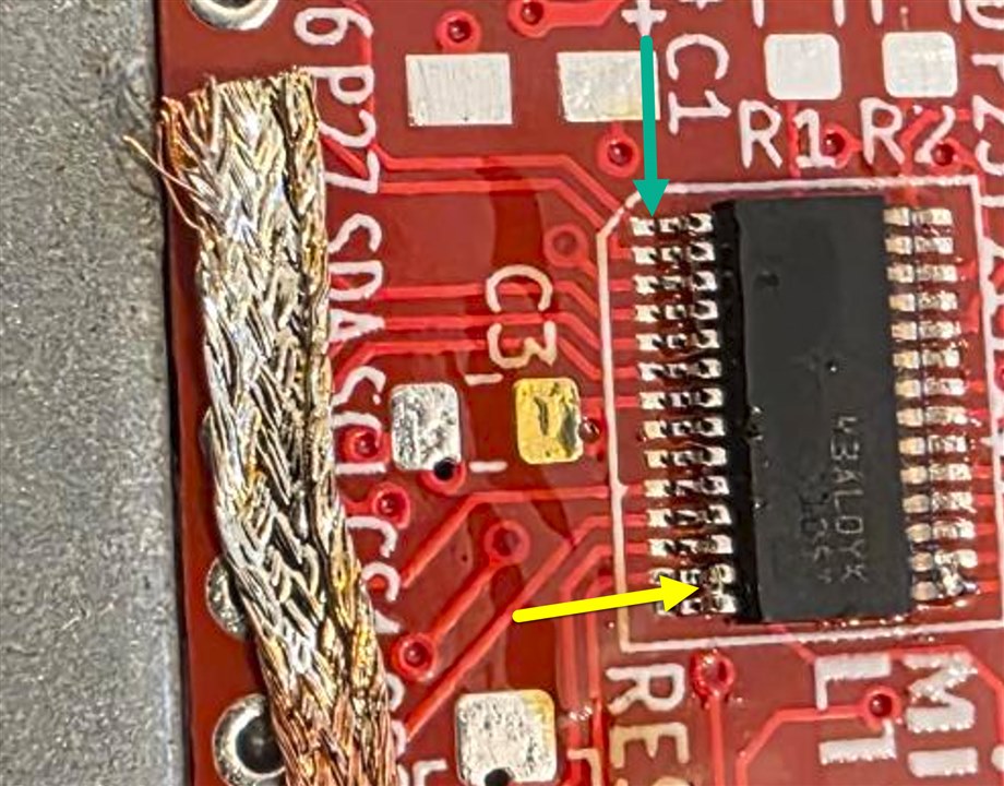

    Maybe worth mentioning how I'm soldering this. Apologies for the low-quality photos, they were taken with mobile phone. I used a small bent-conical tip, but it's not that critical. First step, apply…

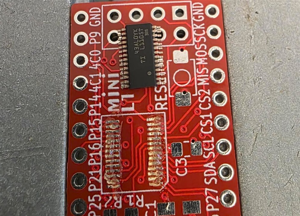

    shabaz 11 months ago
    Since I had some 16-pin MSPM0L1105 parts too, I decided to confirm that they worked the same way.
    I don't have a PCB for them, but using 0.5mm pitch generic breakout board Gerber files,  I soldered it up.
    Works fine! (I tested using the same app_L1105.hex file, and the same Python code programmer as used with the larger 28-pin part.

    To do this, an addition needs to be made to the board, because I didn't anticipate this auto-boot feature originally.
    It basically just inverts the unused *DTR output (which is 5V logic) from the CH340K chip. Diode D1 eliminates current in the backward direction, otherwise it would mess up with any current measurement.
    This is the board with the addition:
    Maybe it's not worth manually soldering as I did, as it merely saves a few seconds of button-pressing effort, but it would be worth adding to a future revision of the board.
