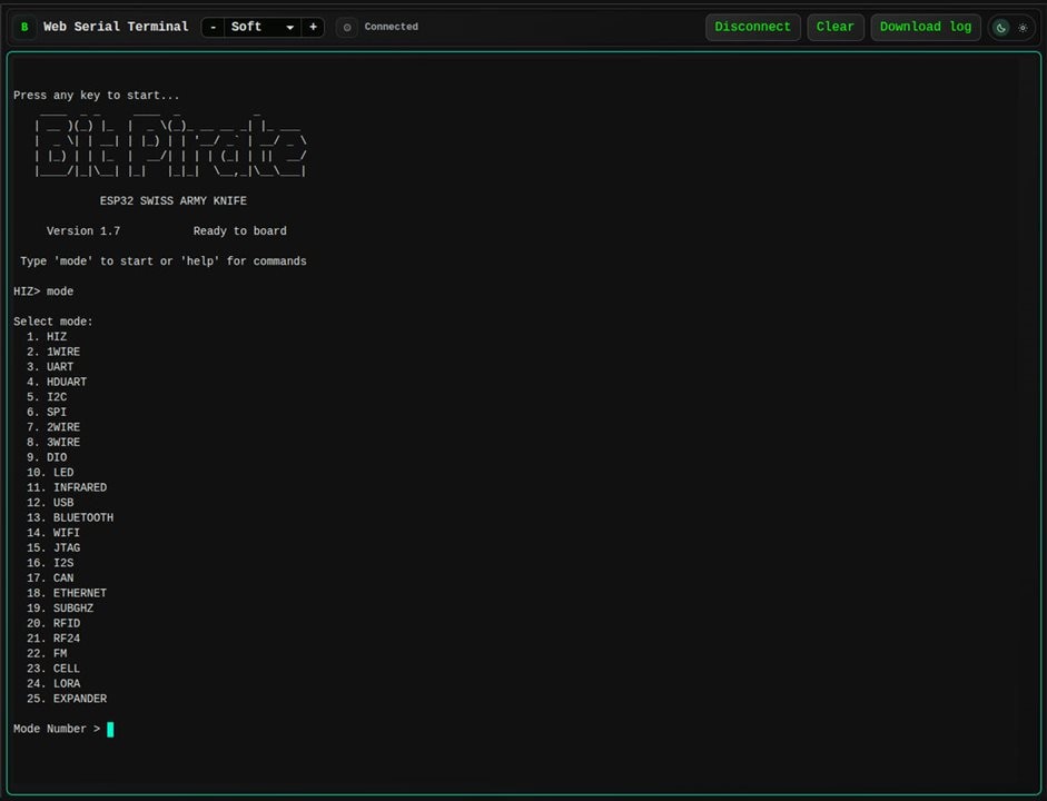

One Firmware, Many Hardware Interfaces
At its core, ESP32 Bit Pirate provides a command-line interface for interacting with connected hardware.
Instead of repeatedly writing and flashing custom Arduino sketches, users can connect a compatible ESP32-S3 board and immediately start exploring different communication protocols.
The firmware supports I2C, SPI, UART, 1-Wire, CAN, JTAG/SWD, GPIO, infrared, Wi-Fi, Bluetooth, Sub-GHz, LoRa, RFID and several other interfaces.
Depending on the hardware, it can be used to inspect communication buses, identify connected devices, dump EEPROM and flash memories, capture signals, interact with radio modules or automate experiments.
The same firmware can be accessed through USB Serial, a Wi-Fi web interface or dedicated browser-based tools.
All supported boards share the same firmware functionality, although some features require additional hardware modules.

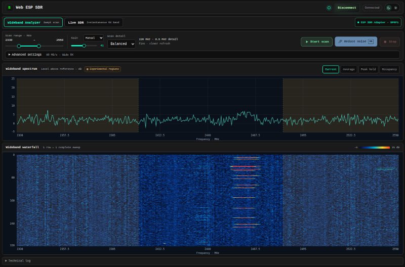

New: Using the ESP32-S3 as a Software-Defined Radio
One of the most interesting additions in version 1.8 is the experimental ESP SDR adapter.
The ESP32-S3 contains a 2.4 GHz Wi-Fi radio, but its capabilities are usually exposed through the standard Wi-Fi and Bluetooth software stacks.
By accessing the radio hardware at a lower level, it is possible to capture raw I/Q samples and use them for basic software-defined radio experiments.
ESP32 Bit Pirate now provides a dedicated USB adapter that streams these samples to a browser-based SDR interface.
The Web ESP SDR application includes live spectrum and waterfall visualization, wideband frequency scanning, peak detection, occupancy tracking, adjustable receiver settings and signal calibration.
Two main operating modes are available:
Live SDR provides a real-time spectrum and waterfall around a selected center frequency, allowing users to inspect nearby RF activity.
Wideband Analyzer sweeps across a configurable frequency range, combining measurements to visualize activity over a much broader portion of the spectrum.
The interface also includes frequency references for common Wi-Fi, BLE, Zigbee and nRF24 channels.
The most reliable operating range remains the standard 2.4 GHz ISM band (2400–2483.5 MHz). Experimental tuning outside this range is possible, but reception quality, frequency accuracy and receiver behavior are not guaranteed.
It is important to understand that the ESP32-S3 is not a dedicated wideband SDR receiver. Out-of-band signals may also produce harmonics, images or other artifacts.
Nevertheless, it is an interesting demonstration of what can be achieved using the radio hardware already present in a low-cost microcontroller.

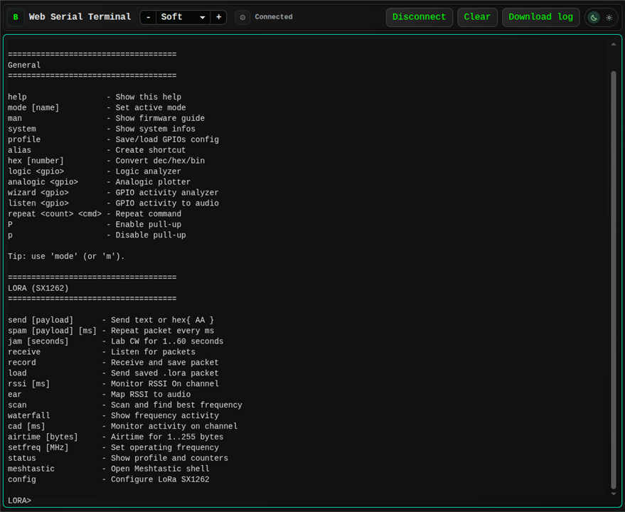

LoRa and Meshtastic Analysis
Version 1.7 introduced support for SX1262 LoRa transceivers, expanding Bit Pirate's capabilities beyond its existing Sub-GHz and 2.4 GHz interfaces.
The dedicated LoRa mode allows users to transmit and receive packets, inspect signal strength, scan frequency activity, perform Channel Activity Detection and visualize radio activity.
Radio parameters such as frequency, bandwidth, spreading factor, coding rate, preamble and transmit power can be configured directly from the interface.
Received packets can also be recorded and replayed with their original radio configuration.
A dedicated Meshtastic analysis shell was introduced alongside these capabilities, allowing users to inspect, send and receive Meshtastic packets.
The objective is not to replace a conventional Meshtastic node, but to provide a convenient interface for debugging and experimenting with LoRa-based communications.
Boards such as the Heltec WiFi LoRa 32 V4 and Heltec Vision Master T190 can take advantage of their integrated SX1262 transceivers without requiring additional radio modules.

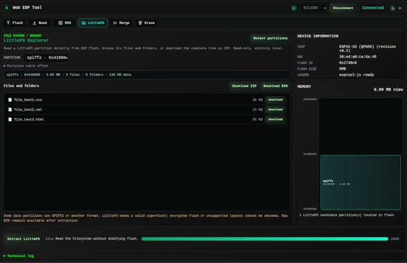

Firmware Extraction and Analysis Directly in the Browser
The browser-based toolkit continues to grow alongside the firmware.
In version 1.8, the ESP Tool gained support for extracting NVS partitions and LittleFS filesystems from ESP32 devices.
NVS extraction allows users to inspect stored configuration data and recover readable keys and values.
LittleFS extraction provides access to files stored inside compatible flash partitions.
These features complement existing tools for SPI flash programming, logic analysis, ESP32 flashing, STM32 and AVR programming, and direct GPIO/I2C/SPI control.
Another useful component is the Python Scripting Lab, which uses Pyodide to execute Python directly in the browser while communicating with Bit Pirate through Web Serial.
This makes it possible to automate hardware experiments, bus scans and data collection without setting up a local Python environment.
The idea behind these tools is to make common embedded debugging workflows accessible through a browser, from connecting to a device and extracting firmware to inspecting the resulting data.
