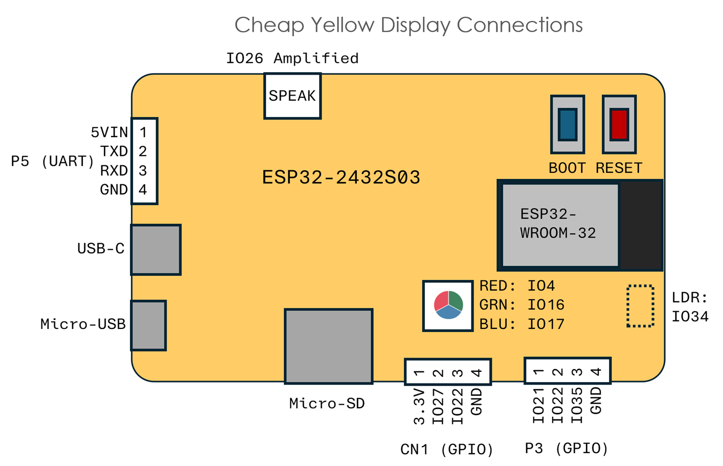

CYD Features
The CYD diagram here shows what’s on the board, and it can be used as a pinout reference when coding.
The component side has an ESP32 module (PDF Datasheet) with approximately 4 Mbyte Flash, and about 520k RAM, 2.4 GHz wireless LAN capability, and Bluetooth Low Energy (BLE).
There is also an RGB LED, a 1W audio amplifier, Micro SD card socket (very useful for logging or configuration files for projects) and very few spare GPIO connections brought out to a couple of connectors.
The board I purchased had both USB-C and Micro-USB connectors, but they are attached to the same signals, so both must not be used simultaneously.
Power entry can come from either the connector labelled P5, or either of the USB sockets. Software can be debugged using the USB Serial interface present on the USB connectors, or using an external USB-UART adapter connected to P5.
There are boot and reset buttons, which are needed during device programming.

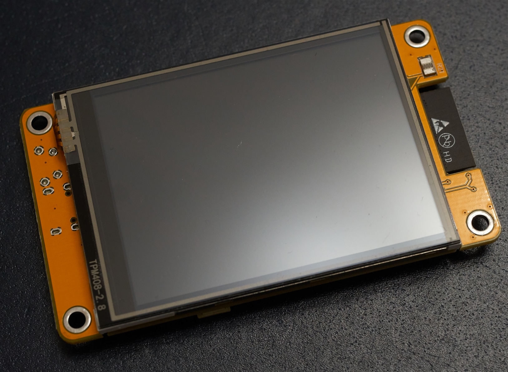

The other side contains just the TFT touchscreen, and a little light sensor (Light Dependent Resistor).

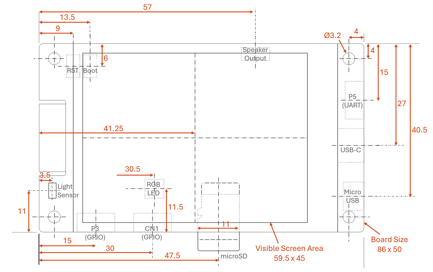

Board Dimensions / Technical Drawing
The overall board is 86 x 50 mm, it's a standard 1.6 mm thick PCB. The 70 x 50 mm TFT screen has a 4 mm height above the board surface. Visible area is 59.5 x 45 mm.
On the other side of the board, most parts protrude 4 mm or less from the board surface, except the Reset and Boot buttons and the speaker connector which are all approx. 4.8 mm tall.
Click the image to enlarge (all measurements are likely only accurate to within a millimeter, and may vary since not all CYD boards may be identical).

The 2.4” 240 x 320 resolution TFT screen is very basic, the contrast is quite poor, but that’s to be expected at such a low price. I think it is very good value for money, and the board can be used for user interfaces (for example).
The board I purchased has space for an additional Flash chip to be installed, but that was not fitted on the board; the only Flash memory present is that inside the ESP32 module.
CYD Connections Reference
There isn’t an official schematic, but it’s possible to figure out the connections. Here they are!
Note: all connectors are Molex PicoBlade (1.25 mm pitch), sometimes known as JST 1.25 (even though JST doesn't manufacture them!).
RGB LED
There is a large RGB LED near the ESP32 module. The GPIO pins need to be pulled low to turn on the LEDs.
GPIO# Connection
4 Red Cathode
16 Green Cathode
17 Blue Cathode

UART and BOOT pin
The serial interface connects to both the USB connector (via a CH340C USB-to-Serial converter) and to a board connector P5, through 100 ohm resistors. A supplied cable can be used.
ESP32 Signal Name Description
RDX0 ESP32 Board Rx, and P5 pin 3 (Blue wire)
TXD0 ESP32 Board Tx, and P5 pin 2 (Yellow wire)
The detail for connector P5:
P5 Pin Description
1 5V Board Power Input (Red wire)
2 ESP32 Board Tx (Yellow wire)
3 ESP32 Board Rx (Blue wire)
4 GND (Black wire)
The ESP32 boot pin is GPIO#0, and it is connected to a push-button to the left of the ESP32. It may need to be held down, while tapping RST, when programming the board. The boot pin is also connected to the CH340C chip to try to automate the boot control from the PC during device programming, but it didn’t work for me, and I had to use the push-button.
Audio Output
One pin (GPIO26) is wired to an SC8002B audio amplifier IC, which is a 1W 8-ohm bridge-tied-load amplifier, wired to a 2-pin connector labelled SPEAK. The connection is through an RC filter. GPIO26 can be operated in a DAC mode (peripheral signal name DAC_2) or perhaps PWM could be performed (no idea).
Spare Input/Output Connections
A few GPIO pins are brought out to two connectors, called CN1 and P3.
CN1:
CN1 Pin Connection
1 3.3V
2 GPIO27
3 GPIO22 (also present on conn P3)
4 GND
P3:
P3 Pin Connection
1 GPIO21
2 GPIO22 (also present on conn CN1)
3 GPIO35
4 GND

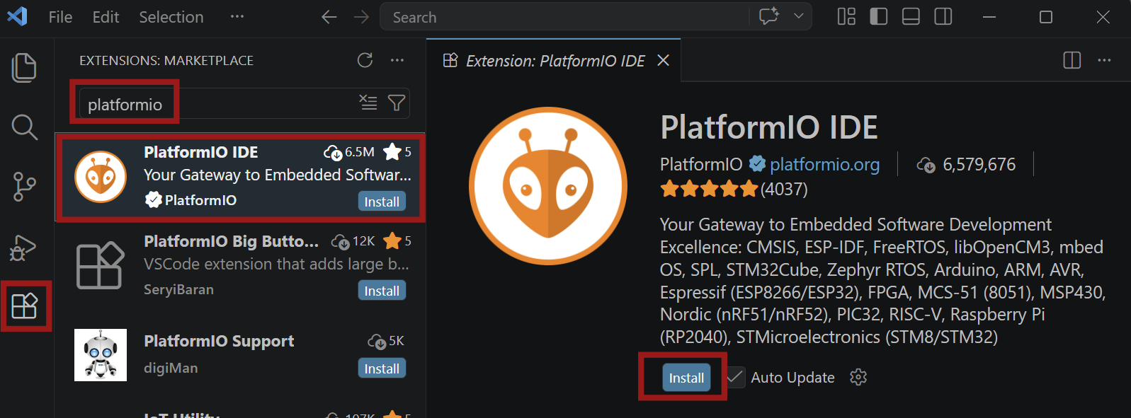

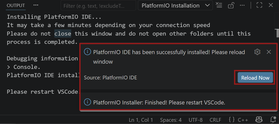

Install VS Code, and PlatformIO Extension
To get going with the CYD, first install VS Code. Then, install the PlatformIO extension by following the steps shown in this screenshot:
Then, restart VS Code!
Later, you might see Installing PlatformIO Core messages at the bottom-right of the VS Code window at some point, such as when a project folder is opened. If you see that, let it complete, and then click Reload Now.

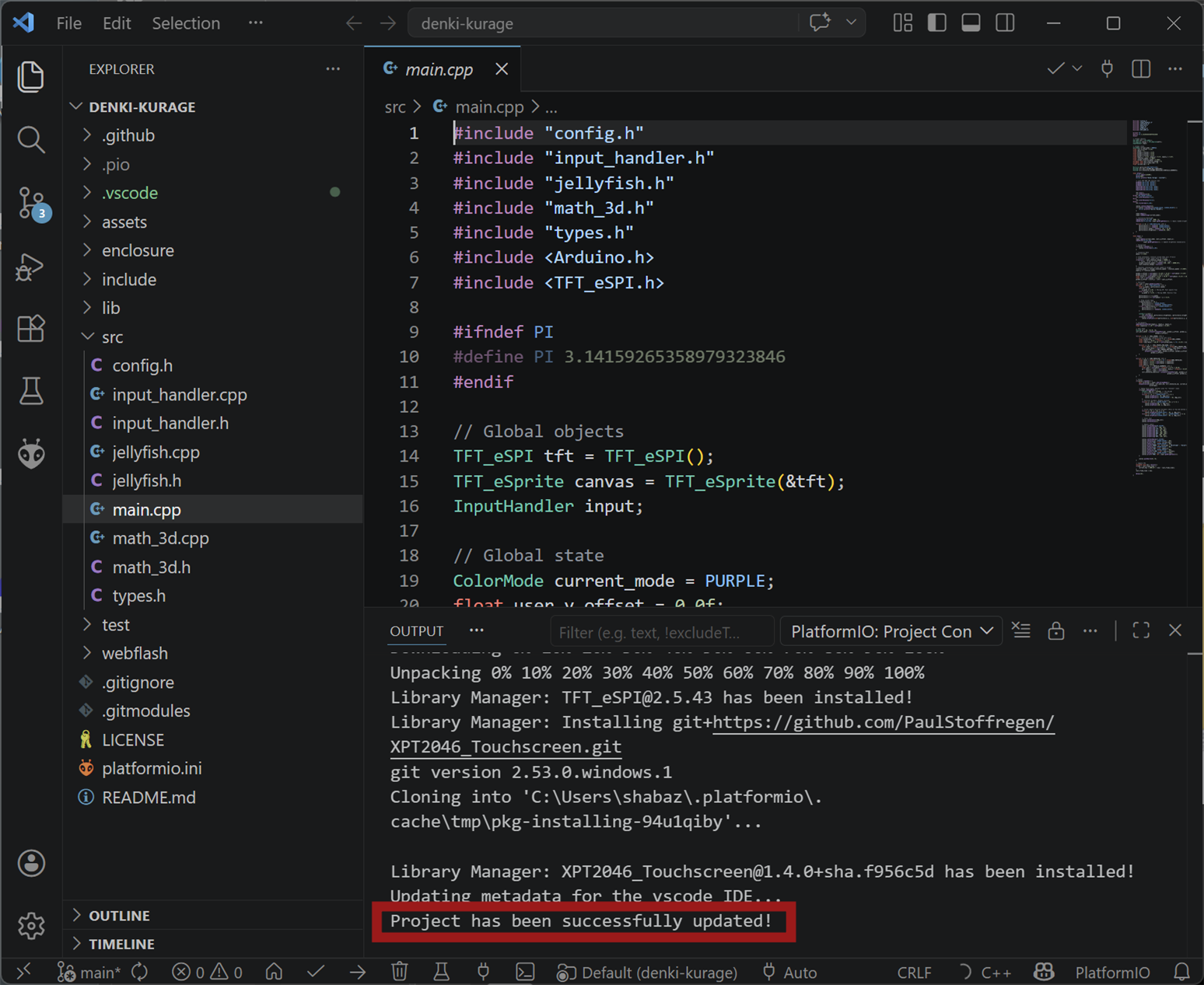

Go to File->Open Folder and select the downloaded project folder denki-kurage. Click to trust the folder if prompted.
You can view the code, by clicking on the left side explorer view, for instance, click on src and select main.cpp. The code will appear in the main pane.
You should see a load of messages appear in VS Code at the lower-right, regarding PlatformIO performing project configuration operations. It may take a quarter of an hour or so to complete, even on a fast PC, and it may well sit at 100% for quite a while, seemingly doing nothing, but let it complete. I wasn’t impressed by PlatformIO’s poor status messages and the crazily long install time.
Eventually you should see this:

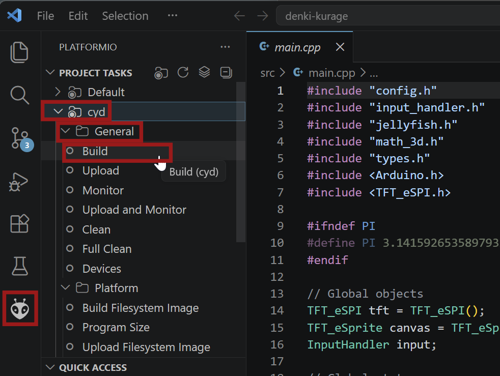

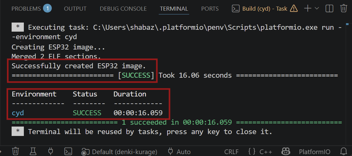

Click on the PlatformIO icon on the left side icon bar, it looks like an alien head. Then click on cyd->General and then select Build.
You should see a load of messages appear at the bottom, followed by Success messages.

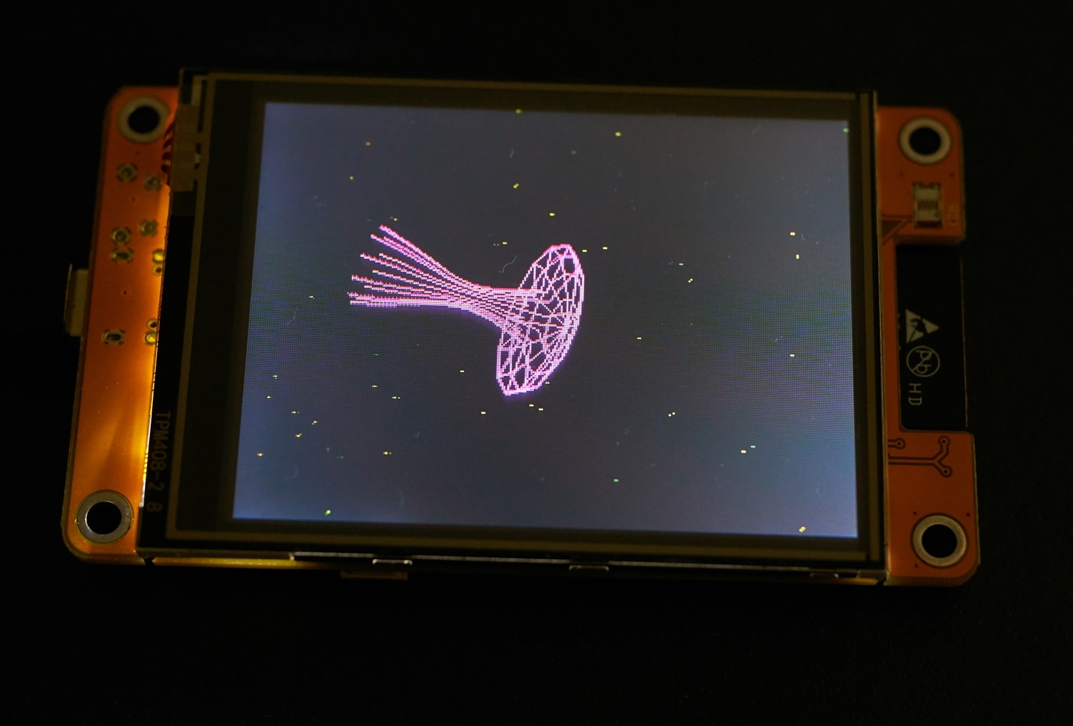

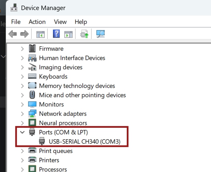

Plug in the USB cable into to the board and into your PC. You should hear a Windows device installed sound after a few seconds. Windows Device Manager will show a port installed, in my case, it was COM3 but the number will vary.
The display on the board should be lit up, and may display an image that is part of any factory firmware that may be in Flash memory.
Look at the back of the board, and locate the two buttons. The top one is labelled RST (Reset) and the one below it is labelled BOOT. The plan will be to click on Upload in VS Code, and then when you see a Connecting… message appear, quickly press down BOOT, and while holding it down, press and immediately release RST. Then you can release BOOT. What this does, is essentially ensure that BOOT is pressed during a board reset.

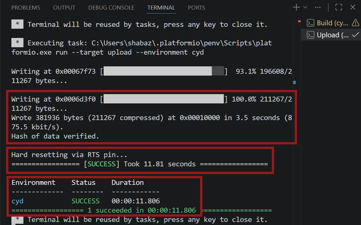

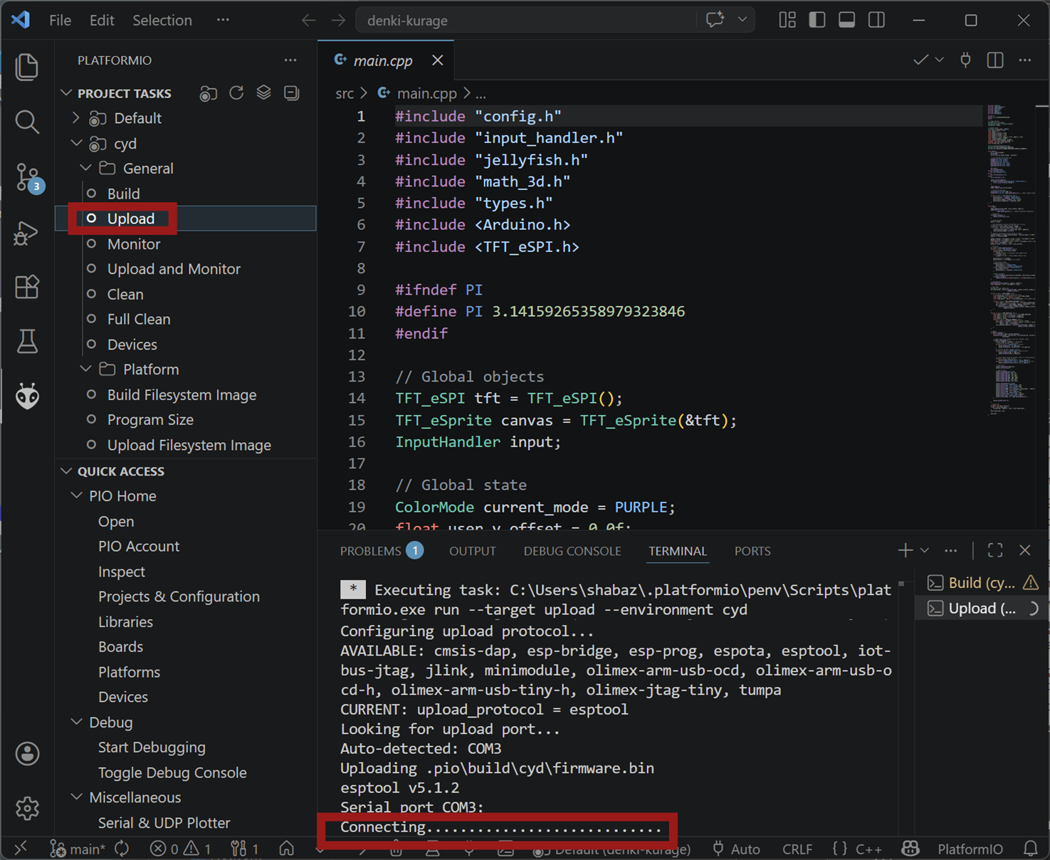

Click on cyd->General->Upload, and notice the Connecting… text at the bottom:
Now, as soon as that text appears, hold down the lower button (BOOT), then tap the top button (RST) and then release BOOT. You should see some uploading messages appear, followed by Success messages:
Take a look at the LCD on the board, and a jellyfish should be present! Tap the jellyfish to change its colour.
The jellyfish happened to be on a white background which I didn't like, so I edited the src/config.h file, to add the following line:
#define CYD_INVERT_DISPLAY
After that, I re-built and re-uploaded the firmware, and all was well.

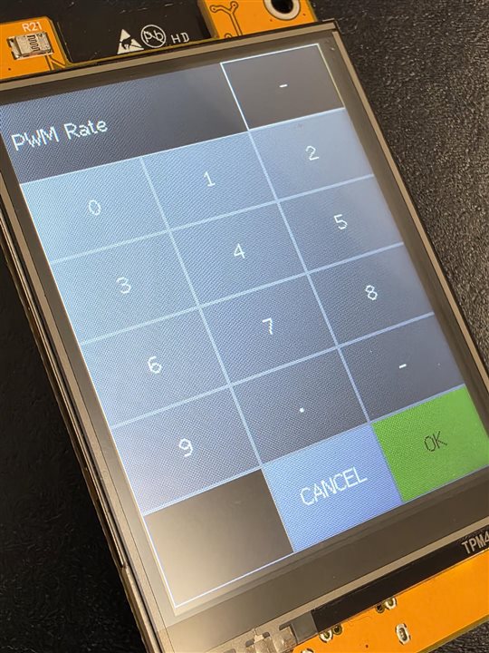

    shabaz 5 months ago

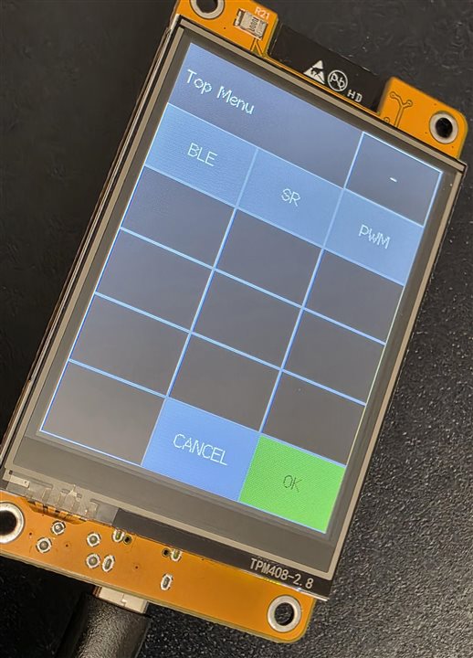

    The menu is slowly coming along..
    There are just three types of things to tap on:
    (a) plain buttons,
    (b) buttons with a built-in value display, and
    (c) buttons with on/off slider.
    All the above can be individually dimmed as required, if (say) if an admin password is not entered.
    For almost zero additional code, the menu code is reused to provide "MsgBox"- type functionality (see Status in the video) by simply removing the Cancel button.
    Poor quality handheld video:
    Another option could be to use LVGL, which apparently "ESPHome" uses, and then menus can be created with config files (I believe). It might be more heavyweight in terms of resource consumption though.
    shabaz 5 months ago
    Despite planning to rely on BLE for config, I realized that a minimal on-screen menu might be occasionally helpful for projects, for instance, to switch BLE on or off, or to enter a passkey to enable BLE or whatever.
    I'm sure menu systems must exist for the CYD, but I figured it would be worth starting from scratch, to ensure very little Flash and RAM is required, and to try to keep it very general, for flexibility.
    This uses C arrays, for storing each menu detail. There is a class called MenuSystem, with a displayMenu method, e.g.
    menu.displayMenu(MENU_TOP,  "-") would show the following:
    So, if the user was to (say) press on the PWM button, then menu.displayMenu(MENU_PWM, "-") would be called (the "-" can be replaced with a default value so the user can see what's currently configured). And no backspace, just cancel to keep the code simple.
    (The minus button shouldn't be there, that was a mistake in the array of button names for that particular menu).
    The code allows up to 12 arbitrary buttons per menu, which is just enough for numeric, but of course insufficient for full text extry (I think that would be tedious to enter on such a small screen anyway, so it would be better to just use the BLE menu option, then do the rest on the mobile phone.
    Once this is working I'll put it on GitHub.
