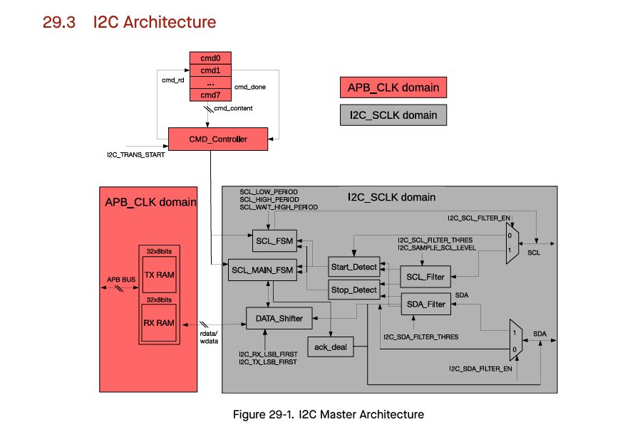

Before going deep into the working of I2C, let's have a look at the I2C hardware block in ESP32 devices. The ESP32 series of devices have dedicated hardware block for I2C peripheral. These peripherals are divided into master and slave blocks. In this tutorial the focus is on ESP32 as master devices only. As you could see in the following block diagram of I2C peripheral there are several things in the peripheral block. One of them is command controller that controls the I2C device commands. These commands are then sent over the I2C bus. The FSM (Finite state machine) will fetch these commands from the list and send them over to the bus. Similarly as you could see in the following block, there is start/stop detector, data shifter, and acknowledge detector. The block has 32x8 bits of separate memory for TX and RX data that can store the data from the transmit and receive operations.

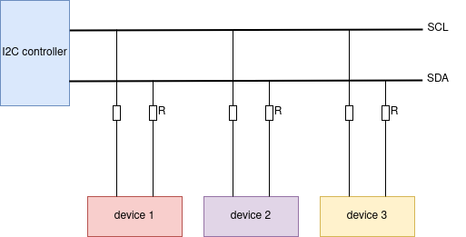

The I2C API in ESP-IDF is designed to work with master/slave I2C device function. The ESP32 can act as master, or it can act as slave to other master such as other SoC or microrontroller. The most commonly used function is I2C master. In this the ESP32 device will communicate with other slave device such as sensors based on I2C protocol. The figure below shows the wiring between the master (controller) and the slave (device) functions. Sometimes pull-up resistors are required to pull the device line status up by default if the peripheral lines are not in use. The ESP32 has internal pull-ups that can be enabled in software to avoid external pull-ups.

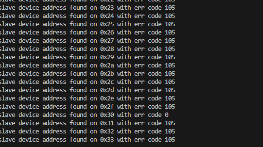

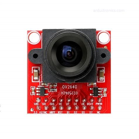

For this tutorial I have create a simple I2C scanner that can scan available I2C slave devices on the I2C bus. I am using a camera module that has OV-2640 camera module that uses SCCB interface compatible with I2C communication.
The SCCB interface requires some extra pins for functioning. Such as MCLK, Reset, PCLK. The MCLK is a master clock and can be supplied with clock of 24 MhZ. For that reason, I am using LEDC (PWM) interface available in ESP-IDF. This will create the required signal on MCLK pin.
Then the I2C will be able to find the camera module on the I2C bus. The camera has the device address of 0x30 and as you could see from the output console that the I2C probe function finds the device on that particular address.!

    printf("Start\n");
    for(int i = 0; i<=127; i++) {
        ret = i2c_master_probe(bus_handle, slave, -1);
        printf("slave device address found on 0x%x with err code %x\n", slave, ret);
        vTaskDelay(50);
        slave = slave + 1;

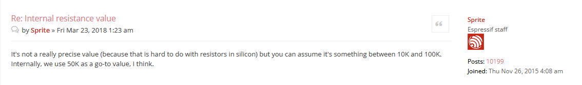

    I may be wrong here because the Espressif Data sheet is a bit lacking and the information I found on the web is quite old but it looks as if the I2C relies on the standard GPIO internal week pullups which are any where between 10k and 100k.
    This will not provide good I2C compatibility.
    The snippets below from the ESP forum suggest that Espressif recommend the use of external pull ups.
    Large variations in chip internal pull up resistor values are normal.
    You should be looking for an RC time constant of about 1us (rough estimate see the I2C spec for details) so with a 100k pull up the maximum capacitance that can be tolerated is of the order of 10pF.
    The first chip I checked claims a maximum pin capacitance of 10pF so you would expect an interface between 2 chips or even 3 to work at 100kHz rate with a typical internal pull up if all three chips were 10pF.
    With the generally recommended 4k7 pull up you would be 100% confident.
    Resistors are cheap - debugging time is expensive and pcb re-work costs horrendous and there is the added bonus that the pull up resistors make good places to attach probes for when you need to look at the I2C bus with a scope or logic analyser.

    I have just copied that image from ESP-IDF documentation. I think they show this for the resistance faced by signals from the wire of I2C.
  • michaelkellett
    michaelkellett over 1 year ago
    Why are you showing resistors in the signal lines to the I2C devices in your diagram. ?
