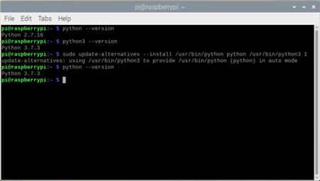

Software Setup

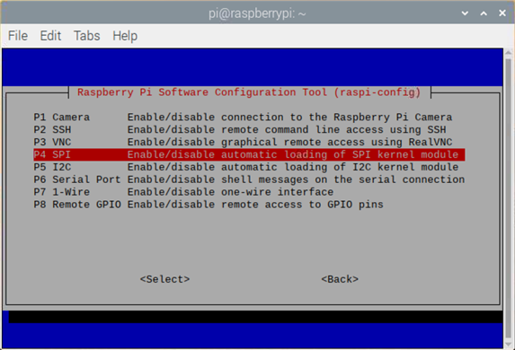

Firstly, you need to enable SPI and Serial Port on Raspberry Pi. Open a terminal, then type:
sudo raspi-config
In the menu, select 3. Interface Options then select P4 SPI and enable it. Select Interface Options again, then select P6 Serial Port. The first thing that appears, the login shell, can be left disabled. You only need to enable the serial port hardware in the second prompt.
Next, you change the default Python version to Python 3.The recommended Raspberry Pi OS comes with both Python 2 and Python 3 preinstalled. Check the Python version with the following commands:
python --version
python3 --version
If the preinstalled Python 3 3.6 or before, you need to install a newer version through commands:
sudo apt-get install python3.x
where x is the version number. For example, we use Python 3.7 in this project (as this is the version preinstalled on the recommended Raspberry Pi OS). So, you will type sudo apt-get install python 3.7
To change the default python version to Python 3, run the following command:
sudo update-alternatives --install /usr/bin/python python /usr/bin/pythonn3 1
Now Python 3 should appear as the default interpreter.
python --version
The last step is to install the required modules. For this, just type the following commands in the terminal:
sudo pip install designspark.pmod

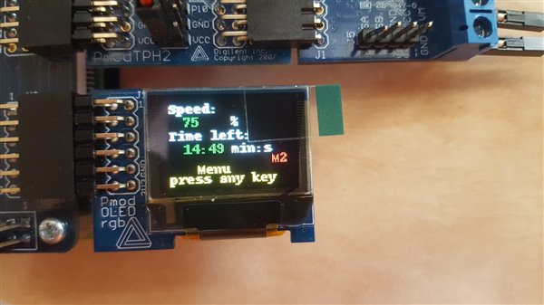

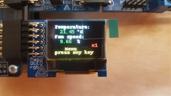

The controller sets the speed of a fan according to temperature (mode 1),
or lets the fan run with a constant speed for a given time (mode 2).
Temperature is measured with Pmod TC1.
The motor is driven by Pmod HB3.
The user interface is realized with Pmod OLEDrgb and Pmod KYPD.

def action_M1():
    """ this is done in mode 1 """
    # get average temperature
    average_temp = 0.0
    for _ in range(settings.TEMP_AVG):
        average_temp = average_temp + TC1.readCelcius()
    average_temp = average_temp / settings.TEMP_AVG
    # calculate the speed from the temperature
    average_temp = average_temp - settings.TEMP_MIN
    max_temp = settings.TEMP_MAX - settings.TEMP_MIN
    if max_temp <= 0:
        max_temp = 1
    speed = 0
    if average_temp > 0:
        speed = average_temp * 100 / max_temp
    # limit the speed
    if speed > 100:
        speed = 100
    elif speed < 0:
        speed = 0
    # set the speed of the motor
    if settings.MOTOR_REV:
        HB3.reverse(speed)
    else:
        HB3.forward(speed)
    # display data
    display.data_M1(average_temp, speed, settings.TEMP_MIN,
                    settings.MODE)
    return
def action_M2():
    """ this is done in mode 2 """
    # calculate stop time
    stop_time = datetime.now() + timedelta(minutes=settings.TIME_RUN)
    # set motor speed
        HB3.reverse(settings.CONST_SPEED)
    else:
        HB3.forward(settings.CONST_SPEED)
    # wait but check buttons
    try:
        # if the time didn't expire, continue
        while datetime.now() < stop_time:
            # display data in every iteration (the time will change)
            display.data_M2(settings.CONST_SPEED, stop_time -
                            datetime.now(), settings.MODE)
            # check for keypress
            if keypad.KYPD.getKey() != None:
                raise keypad.KeyPressed
            pass
    # on keypress, stop the motor and exit
    except keypad.KeyPressed:
        HB3.forward(0)
        return
    # stop motor
    HB3.reverse(0)
    try:
            display.data_M2(0, stop_time - datetime.now(), settings.MODE)
            pass
        HB3.forward(0)
        return
    return

def data_M1(average_temp, speed, min_temp, mode):
    """ display data in mode 1: temperature and speed """
    with canvas(OLED.getDevice()) as draw:
        # clear the screen
        draw.rectangle(OLED.getDevice().bounding_box,
                       outline="black", fill="black")
        # dislpay the temperature
        draw.text((5, 0), "Temperature: ", fill="white")
        draw.text((15, 10), "%.2f" % (average_temp + min_temp), fill="green")
        draw.text((50, 10), "\xb0" + "C", fill="white")
        # display the speed
        draw.text((5, 20), "Fan speed: ", fill="white")
        draw.text((15, 30), "%.2f" % speed, fill="green")
        draw.text((50, 30), "%", fill="white")
        # display current mode
        draw.text((80, 38), "M" + str(mode), fill="red")
        # display some text
        draw.text((25, 45), "Menu", fill="yellow")
        draw.text((5, 52), "press any key", fill="yellow")
    return
def data_M2(speed, time, mode):
    """ display data in mode 2: speed and remaining time left """
        # clear the screen
        # display the speed
        draw.text((5, 0), "Speed: ", fill="white")
        draw.text((15, 10), str(speed), fill="green")
        draw.text((50, 10), "%", fill="white")
        # display the time left
        draw.text((5, 20), "Time left: ", fill="white")
        _, remainder = divmod(time.seconds, 3600)
        minutes, seconds = divmod(remainder, 60)
        draw.text((15, 30), str(minutes) + ":" + str(seconds), fill="green")
        draw.text((50, 30), "min:s", fill="white")
        # display the mode
        # display some text
    return
