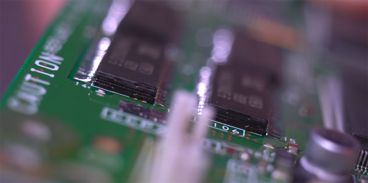

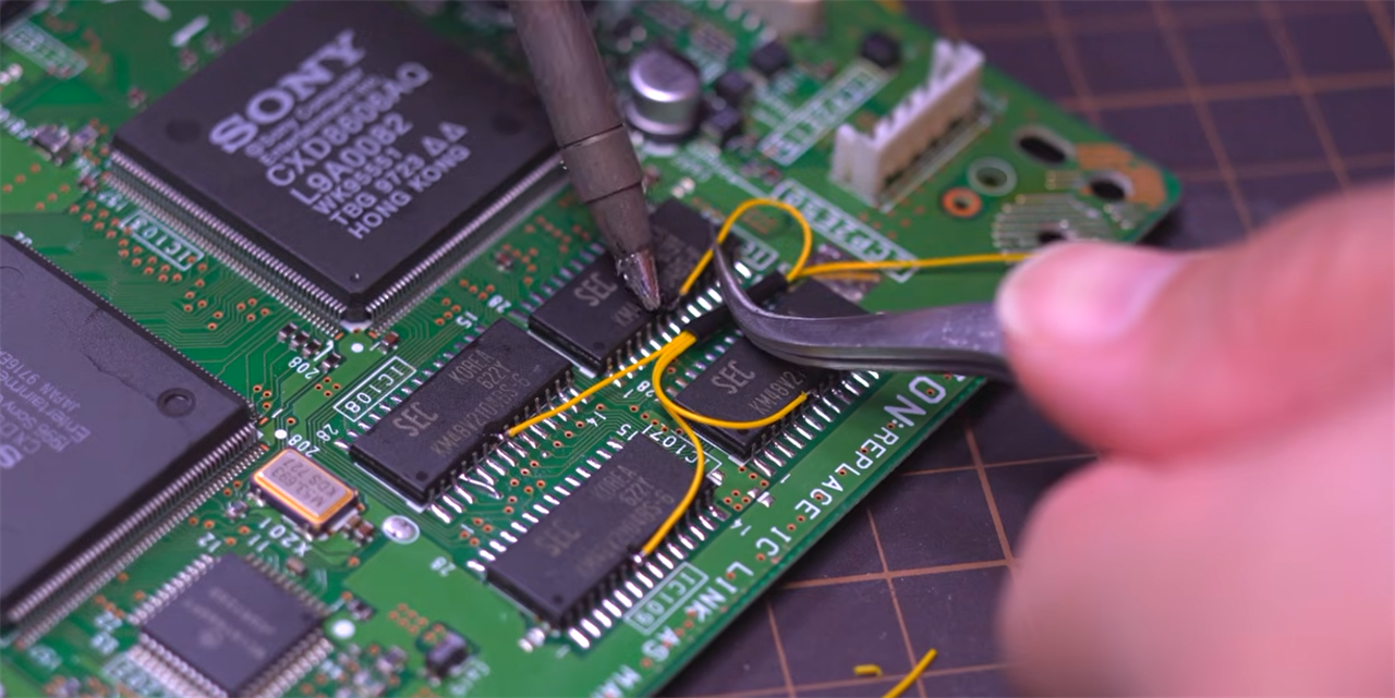

The modder removed the four 512KB EDO DRAM chips in the PS One, replacing them with eight 2MB chips taken from legacy EDO memory modules. Since the motherboard has space for four chips, he installed those before stacking the other four on top. Several motherboard signals were then rerouted using a custom quick solder board.
After he installed the RAM chips, a diagnostic program verified that the console recognized and accessed the 16MB RAM. This matches the configuration in some PlayStation arcade hardware. It only works on PU-8 motherboards, similar to those in SCPH-5500 consoles.
Wiring to route the signals. (Image Credit: Macho Nacho Productions/YouTube)
