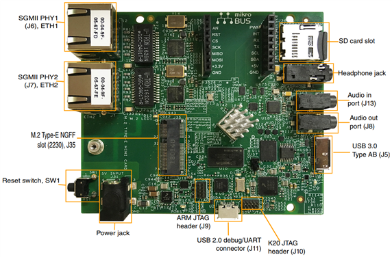

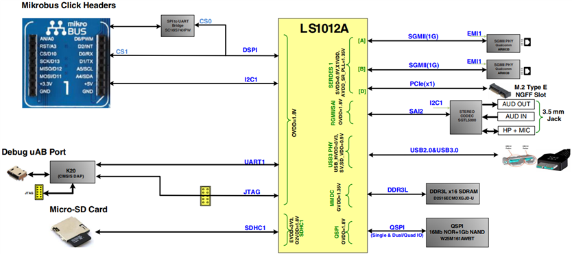

I received the Layerscape FRWY-LS1012A board from the attendance to an E14 webinar, and I will write on my experience with the board. It will be written in an informal style, where I'll post my journey exploring the board as I try different aspects of the board. This is my first experience with a Linux based board, so there will be a lot of trial and error during the testing of the board.
The LS1012A is an entry level processor that belongs to the Layerscape family, which are processors meant to be used for networking applications. As Tareq Bustami (senior vice president and general manager of NXP’s Digital Networking business) puts it:  “The groundbreaking combination of low power, tiny footprint and networking-grade performance of NXP’s LS1012 processor is ideal for consumer, networking and Internet of Things applications alike, including comprehensive IoT Gateway solutions which integrate low power 64-bit ARM based processors together with BLE, ZigBeeRegistered & Thread wireless technologies,”.
The Layerscape FRWY-LS1012A board is a small (83x90 mm) development platform for the LS1012A processors built on a single core Arm CortexRegistered-A53. It features:
  • A rich Linux development environment will be available initially via an early access release and will be included in the Layerscape SDK release
  • LS1012ASE7KKB MCU – 1000 MHz CPU, 1GT/s DDR3L, 212 FC-LGA
  • 16 MB serial NOR + 1GB serial NAND QSPI
  • 512 MB DDR3L SDRAM
  • VR5100 Power Management IC
  • SGTL5000 Audio ADC / DAC with 3.5mm microphone and headphone jacks
  • Dual 1000Base-T Ethernet interfaces with RJ-45 connectors
  • USB2.0/3.0 OTG Micro A/B connector
  • MicroSD card slot
  • M2 connector to enable Wi-Fi and NFC applications
  • mikroBUSTm Click expansion connectors with I2C, SPI, UART and GPIO connectivity
  • USB2.0 Micro A/B connector for debug
  • Additional debug via Cortex 10-pin JTAG connector and CMSIS DAP through a K20 microcontroller
(https://www.nxp.com/docs/en/reference-manual/FRWY-LS1012ARM.pdf )
