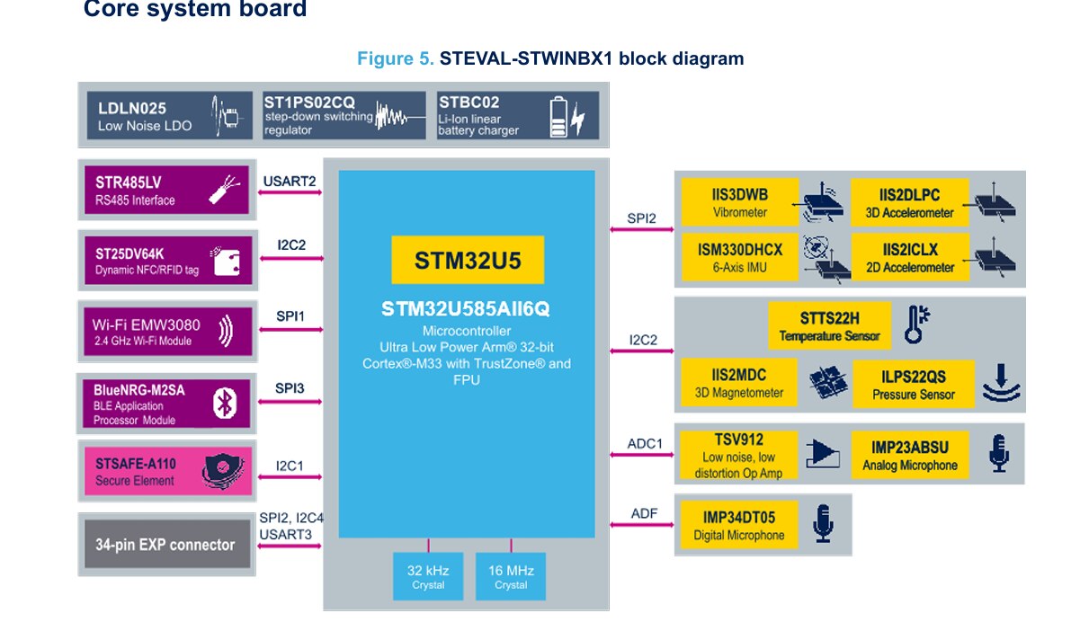

So, if you look at the following diagram, most of the sensors I am using, are connected on SPI2 and I2C2 bus.
After build I can check which bus is enabled or disabled in the final build and they are all enabled correctly. Even if they are not, I would get error to initialize the sensor, the device_is_ready() will let me know.
If say sensor/s is damaged, then also it will not init. I have verified from the code that the channels that I am using are correct channels. i.e. SENSOR_CHAN_AMBIENT_TEMP, etc.
Even the Bluetooth is working that is connected on SPI bus. Most other modules are working. Sensors are being initialized, and their address is printed. But the values are not.

Here is the board.dts file
