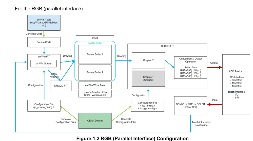

Below is a diagram that shows how the software stack works together, specific for the colour depth that I'm using.
https://www.renesas.com/us/en/document/apn/rx-family-emwin-v634-module-using-firmware-integration-technology

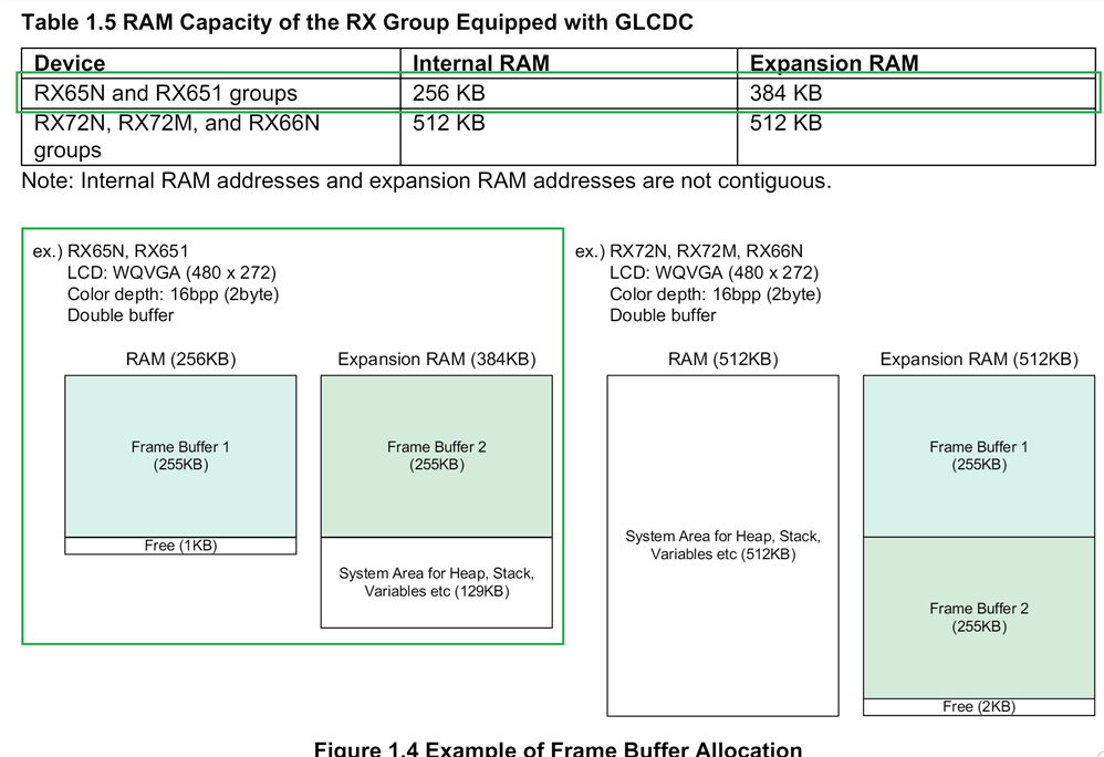

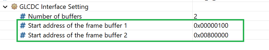

Frame Buffer Configuration
This is the part where I don't have a correct setup yet.

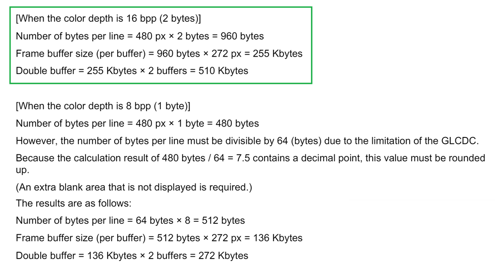

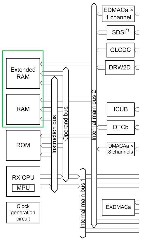

The RX65N memory is split in RAM and extended RAM. Both chunks are not big enough to contain both frame buffers. Careful memory layout is required. emWin works best with 3 buffers, but that's not possible with the available RAM. Two buffers is a working compromise.
Sizing of the two frame buffers:
I'm using 16 bits per pixel (bpp) colour depth.

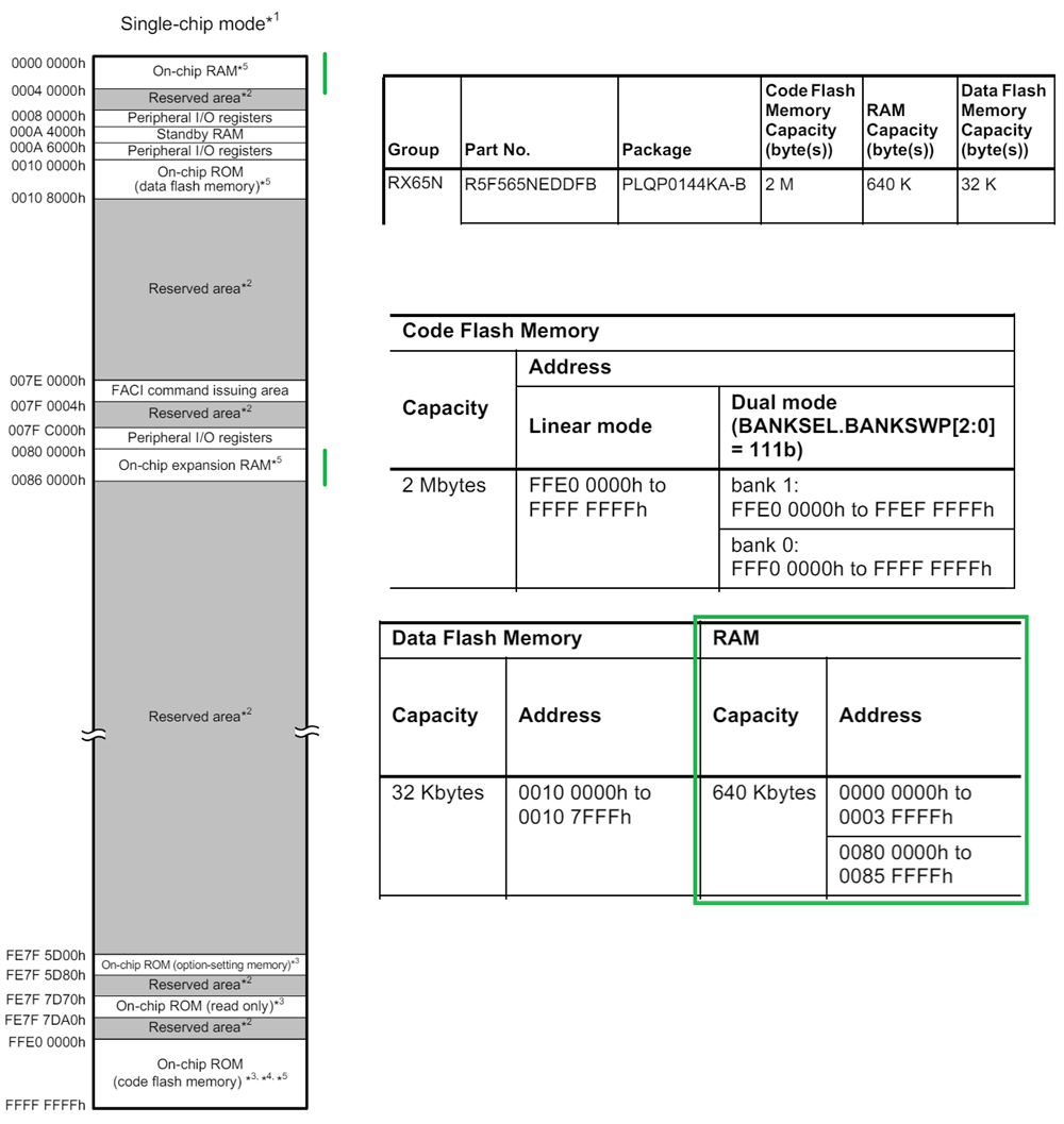

Available RAM areas for the Renesas controllers that have an LCD driver below. The RX65N specs are on the first row, and the layout in the diagram on the left.

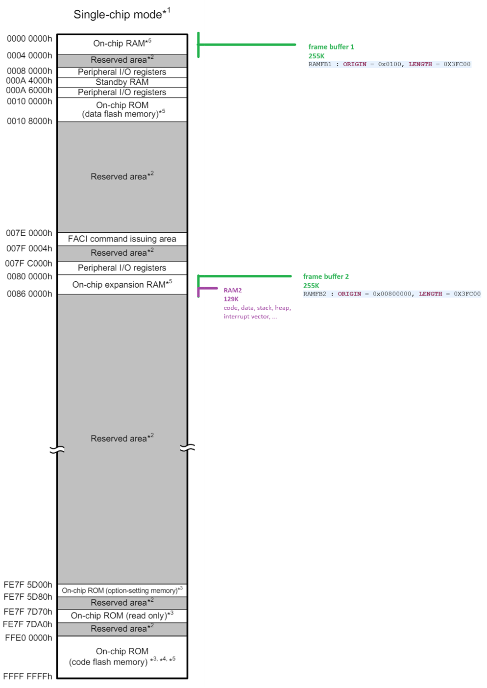

The 2 RAM areas can each contain one buffer with 16 bpp. They are physically distinct RAM blocks:
source: https://www.renesas.com/us/en/document/dst/rx65n-group-rx651-group-datasheet
The addresses are not contiguous:

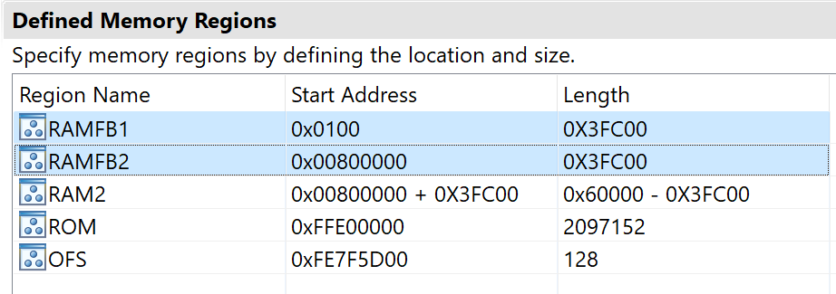

Proposed loader settings:
MEMORY
	RAMFB1 : ORIGIN = 0x0100, LENGTH = 0X3FC00
	RAMFB2 : ORIGIN = 0x00800000, LENGTH = 0X3FC00
	RAM2 : ORIGIN = 0x00800000 + 0X3FC00, LENGTH = 0x60000 - 0X3FC00
	ROM : ORIGIN = 0xFFE00000, LENGTH = 2097152
	OFS : ORIGIN = 0xFE7F5D00, LENGTH = 128

In the previous section, I reserved 2 memory sections for the 255K frame buffers:
buffer 1: 0x00000100
buffer 2: 0x00800000

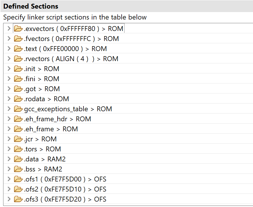

The linker script is defined in a way, that all data , code, buffers, heaps, ... are now placed in the extended memory area, after buffer 2. And both buffer areas are reserved in the linker script. No section is placed in the 2 areas.
Full loader script:
MEMORY
SECTIONS
	.exvectors 0xFFFFFF80: AT(0xFFFFFF80)
		"_exvectors_start" = .;
		KEEP(*(.exvectors))
	"_exvectors_end" = .;
	} >ROM
	.fvectors 0xFFFFFFFC: AT(0xFFFFFFFC)
		KEEP(*(.fvectors))
	} > ROM
	.text 0xFFE00000: AT(0xFFE00000)
		*(.text)
		*(.text.*)
		*(P)
		etext = .;
	} > ROM
	.rvectors ALIGN(4):
		_rvectors_start = .;
		INCLUDE ../src/smc_gen/r_bsp/mcu/all/linker_script_rvectors.inc
		_rvectors_end = .;
	} > ROM
	.init :
		KEEP(*(.init))
		__preinit_array_start = .;
		KEEP(*(.preinit_array))
		__preinit_array_end = .;
		__init_array_start = (. + 3) & ~ 3;
		KEEP(*(.init_array))
		KEEP(*(SORT(.init_array.*)))
		__init_array_end = .;
		__fini_array_start = .;
		KEEP(*(.fini_array))
		KEEP(*(SORT(.fini_array.*)))
		__fini_array_end = .;
	} > ROM
	.fini :
		KEEP(*(.fini))
	} > ROM
	.got :
		*(.got)
		*(.got.plt)
	} > ROM
	.rodata :
		*(.rodata)
		*(.rodata.*)
		*(C_1)
		*(C_2)
		*(C)
		_erodata = .;
	} > ROM
	gcc_exceptions_table :
	    KEEP (*(.gcc_except_table))
	    *(.gcc_except_table.*)
	} > ROM
	.eh_frame_hdr :
		*(.eh_frame_hdr)
	} > ROM
	.eh_frame :
		*(.eh_frame)
	} > ROM
	.jcr :
		*(.jcr)
	} > ROM
	.tors :
		__CTOR_LIST__ = .;
		. = ALIGN(2);
		___ctors = .;
		*(.ctors)
		___ctors_end = .;
		__CTOR_END__ = .;
		__DTOR_LIST__ = .;
		___dtors = .;
		*(.dtors)
		___dtors_end = .;
		__DTOR_END__ = .;
		. = ALIGN(2);
		_mdata = .;
	} > ROM
	.data : AT(_mdata)
		_data = .;
		*(.data)
		*(.data.*)
		*(D)
		*(D_1)
		*(D_2)
		_edata = .;
	} > RAM2
	.bss :
		_bss = .;
		*(.bss)
		*(.bss.**)
		*(COMMON)
		*(B)
		*(B_1)
		*(B_2)
		_ebss = .;
		. = ALIGN(128);
		_end = .;
	} > RAM2 AT>RAM2
	.ofs1 0xFE7F5D00: AT(0xFE7F5D00)
		KEEP(*(.ofs1))
	} > OFS
	.ofs2 0xFE7F5D10: AT(0xFE7F5D10)
		KEEP(*(.ofs2))
	} > OFS
	.ofs3 0xFE7F5D20: AT(0xFE7F5D20)
		KEEP(*(.ofs3))
	} > OFS
	.ofs4 0xFE7F5D40: AT(0xFE7F5D40)
		KEEP(*(.ofs4))
	} > OFS
	.ofs5 0xFE7F5D48: AT(0xFE7F5D48)
		KEEP(*(.ofs5))
	} > OFS
	.ofs6 0xFE7F5D50: AT(0xFE7F5D50)
		KEEP(*(.ofs6))
	} > OFS
	.ofs7 0xFE7F5D64: AT(0xFE7F5D64)
		KEEP(*(.ofs7))
	} > OFS
	.ofs8 0xFE7F5D70: AT(0xFE7F5D70)
		KEEP(*(.ofs8))
	} > OFS
.r_bsp_NULL :
		. += 0x100;
		"_r_bsp_NULL_end" = .;
	} >RAM2 AT>RAM2
.r_bsp_istack ALIGN(0x4) (NOLOAD) :
		KEEP(*(.r_bsp_istack))
	} >RAM2 AT>RAM2
.istack :
		"_istack" = .;
	} >RAM2
.r_bsp_ustack ALIGN(0x4) (NOLOAD) :
		KEEP(*(.r_bsp_ustack))
	} >RAM2 AT>RAM2
.ustack :
		"_ustack" = .;
	} >RAM2

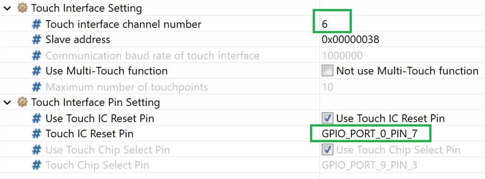

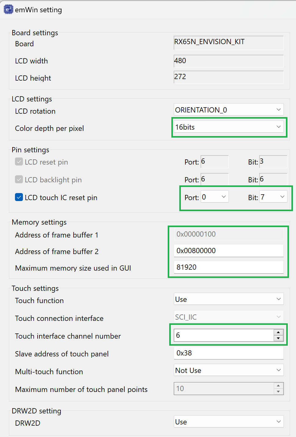

Let's now adapt the default wizard and config settings, with this info. In the screen captures below, I focused on the configuration that's different than the proposed wizard values, or the QE-How-To instructions.
QE for Display wizard:
emWin FIT module:

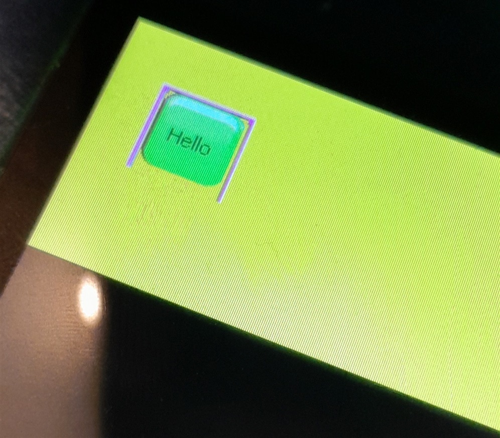

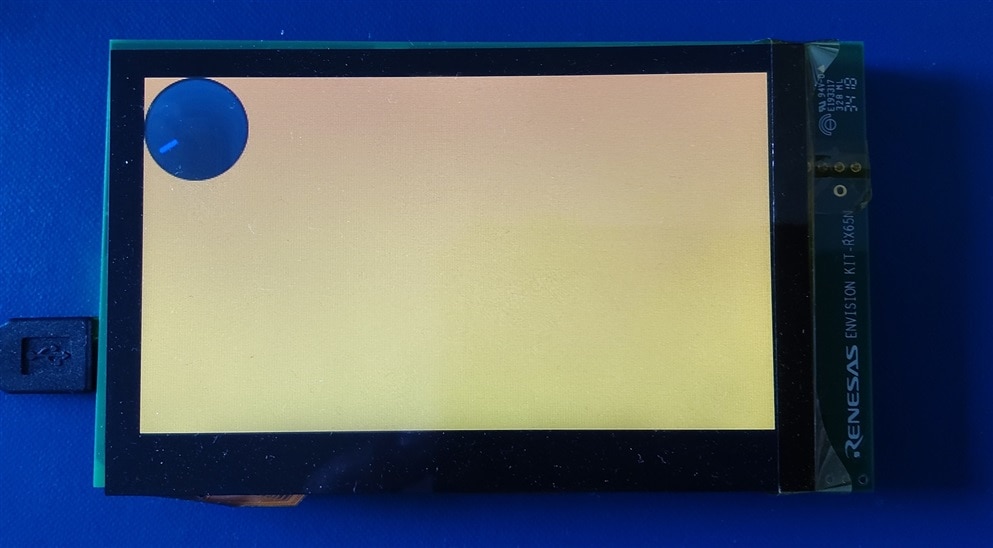

Result:

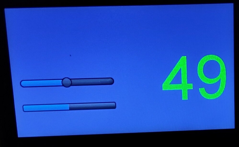

* my road test screen was physically damaged on arrival and didn't show all lines. It held up for a while, but kept losing lines. I dis- and re-assembled it. That reverted the display to more-than-half-working. But I was unable to get the full screen. Now that I have Andrew J 's screen , I can proceed with my endeavours.
I also have a bigger LCD screen (present from shabaz ). That works perfectly, but doesn't have a capacitive touch layer. I purchased a touch front end for that. But it's not a drop-in unit. I'll need to learn how to get that working in this environment. Food for a different blog chain.

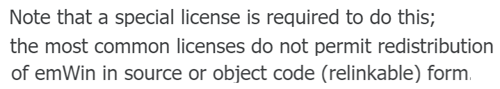

I did not attach the project due to emWin licensing restrictions:
The AppWizard generates a set of source codes, libs and executables in the project structure. Maybe, if I have time, I will create a project without these objects, and an explanation on how to generate the dependencies that I can't include.

    Mostly all good.
    I found that using the hardware drawing accelerator (D/AVE) does not give a reliable display. It's faster, but there are drawing errors. The photo above is without the accelerator. Crisp.

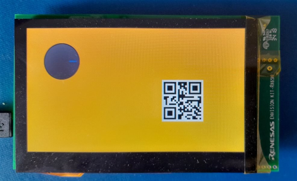

    Jan Cumps over 2 years ago
    The adaption path was steep, but all is behaving well now
    Below animation is the result of doing Segger's blog Extending AppWizard-generated GUIs with emWin Widgets.
    I got it working.
    changes to do after creating a GCC project, with the QE-for-LCD wizard:
    • fix touch display reset pin to P07
    • change the loader file. Reserve 2 255K blocks of RAM
    • adapt the QE and FIT attributes to let the buffers point to those 2 RAM blocks
    The first sections of the post above are investigations. The required changes (including loader script source) are in the last section: Software Configuration
