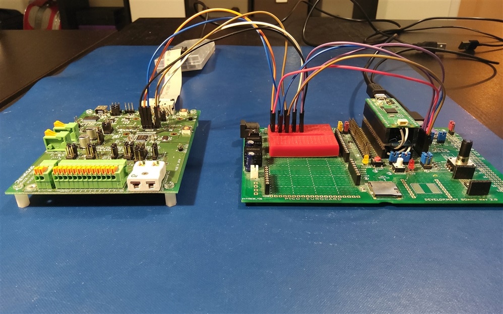

I have an evaluation board from Road test: Renesas Solution Starter Kit for RX23E-A. It has options for USB, CAN and RS-485/profibus. Out of box, it doesn't expose SPI. But it has the capabilities to do so. This blog shows a few modifications I did to get at the SPI signals.
The application note for this kit shows what I can get at without needing bodge wires. The connector J3 exposes a number of communication lines. Including ones needed to use the SPI peripheral. But several of them are connected to the SPI and profibus ICs. So i need to do a few little changes.
I've been checking all options for the SPI signals:
and here's what I selected:
On the PCB, I need to mount J3, and remove R90 and R28. The resistors are 0402 and 0603. Doable when careful.
Before:
After:
Not so difficult with this kit. The two resistors have enough space to work on them. I used a decent flat solder tip and shoved them off their pads. J3 is a standard pin header. Easy to solder, if you use enough power for the pins that are connected to the power planes. I taped the resistors on a piece of paper and put them inside the kit's box. In case I want to restore it to its original configuration.

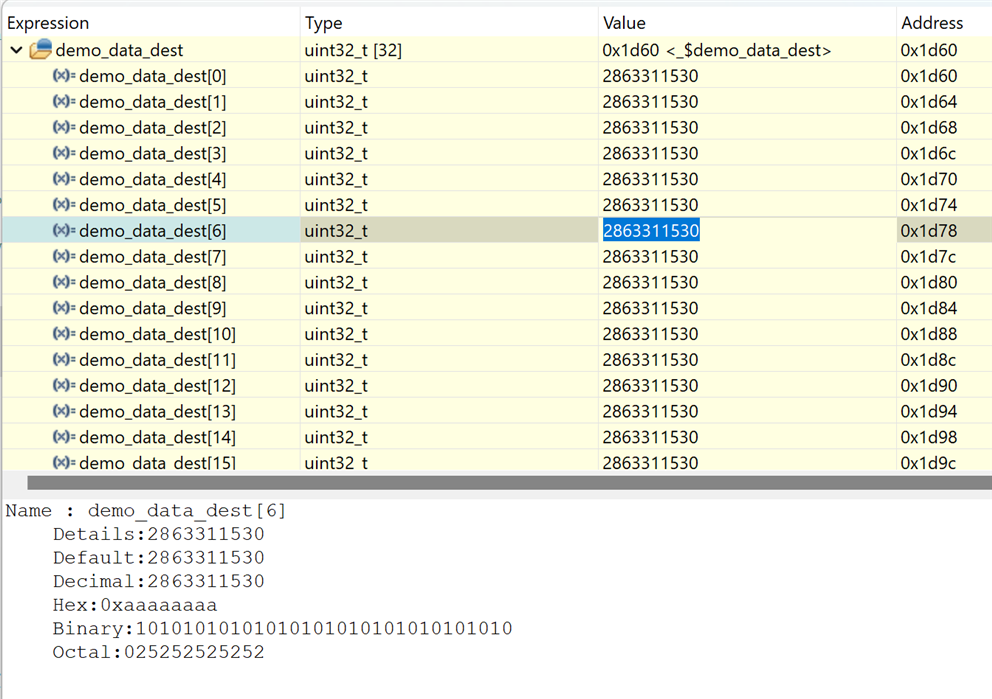

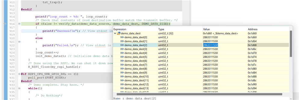

    It's working now.

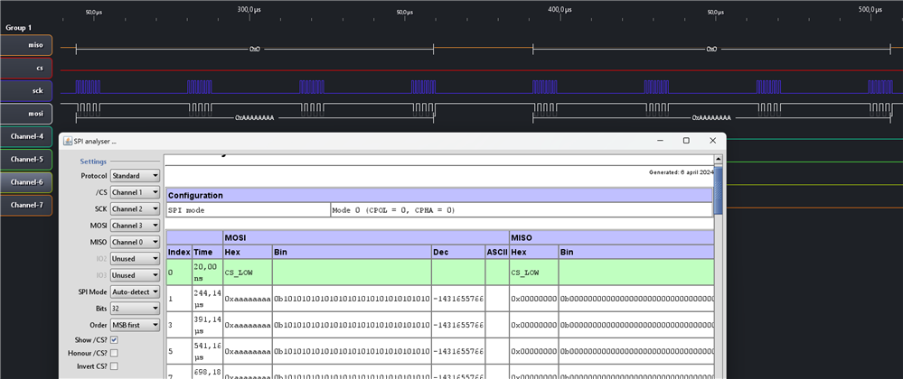

    I'm sending it 32 32-bit values  (0xaaaaaaaa), and they appear
    The full example program expects 5 batches of 32 32-bit values. It checks each batch against a set of expected data, then loops.

    It doesn't want to work yet. I've set up a bus pirate to send data out, and my protocol analyser indicates that it's correct
    (I had posted this 2 days ago but forget to submit :) )

    I ported a SPI client example to the RX23E-A kit, and connected it up with a Pico. Next step is to program the Pico with some SPI master code and see if data is exchanged ....
