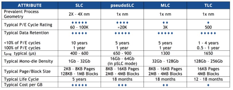

When evaluating NAND flash-based devices as the storage medium for an embedded application, factors such as the host interface(s), power consumption, physical space, performance, capacity, environment and cost will often dictate the selection.
Endurance requirements are also a major part of the decision, and as we will discuss, the program/erase (P/E) cycle rating of the raw flash die is only one piece of the puzzle.  How the device is written to – in terms of both the controller technology and the application workload – have a significant impact on the TBW1 and resulting life of the drive.
Table 1: Comparison of Raw Flash Types2image
1TBW (or Terabytes Written) is a measure of SSD endurance as defined by JEDEC in the JESD218A standard, but more broadly applied to other types of storage devices.
2For a comparison of these flash types, and other factors than can contribute to the overall life of a device, check out this endurance white paper https://www.delkin.com/technology/flash-endurance/
