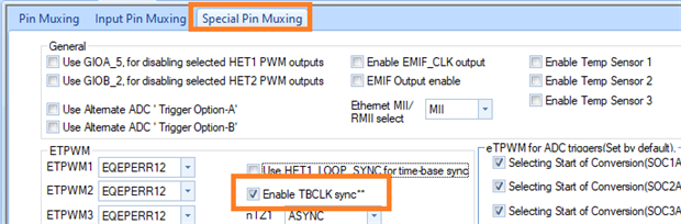

Setting up de Peripherals
You need to enable the PWM driver, because that's the one that 'll be used both for detecting the sync pulses and generating the PWM.
This is done vie the HALCoGen application for Hercules controllers.
Then in the PWM settings, enable the 1st one, and set its behaviour.
Then the Pin Multiplexer. This is different for the RM46 and 57 (and the same image different for their TMS570LS12 TMS570LC43 twins).
RM46:
RM57:
That's it. Let HALCoGen generate the project code.
