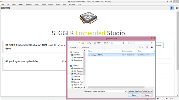

Open Segger Embedded IDE and go to "File" >> "Open Solution" to open sample project from nRF52 SDK. Yes, the sample project is needed to even blink an LED in Taiyo Yuden BLE EYSNSNZWW module. There is a truth behind this. Taiyo Yuden manufactures the smallest BLE modules based on  nRF52811 by Nordic Semiconductor. But, their architecture is not completely the same as Nordic's since there are some add ons and peripherals. Neither they have their own IDE nor they completely support nRF5 SDK. With some tradeoffs, this Taiyo Yuden module can be programmed with segger studio using nRF SDK examples. Several support files, libraries come together with nRF52 SDK which makes programming this kit handy. Of course, accessing GPIO's is much easy since no Soft Devices are needed which comes into picture while using BLE feature.
Install "CMSIS-CORE Support Package" and "nRF CPU Support Package" form "Tools" >> "Package manager" before continuing. To open sample project, navigate to "File" >> "Open Solution" and  Browse to the / examples / peripheral / blinky / pca10040e / blank / ses.
Again, only PCA10040e version (category of development board by Nordic) is compatible with Taiyo Yude BLE  EYSNSNZWW KIT since it is nRF52811 based. There are several examples in nRF5 SDK which won't support  PCA10040e version but of course, those can be ported to make supportable with Taiyo Yude BLE  EYSNSNZWW by deep exploration and hacking on drivers and libraries.
After opening the above file, a sample project will pop up with blinky code for Nordic PCA10040 development board as selected. But.......wait! I am not having that board.

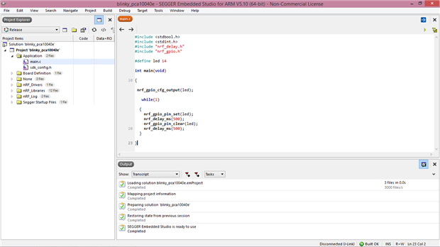

The ready opened code will get successfully debugged and even loaded to Taiyo Yuden EYSNSNZWW but nothing works. Its because that code has declarations made as for  Nordic PCA10040 and its respective files. (I wondered at this point "am I not even able to blink an LED with this?"). But, thankfully realised and went through nRF52811 documentation and libraries to come up with following code which successfully enters into the MCU core and toggles GPIO. (suggest better idea if any)
#include <stdbool.h>          //standard headers
#include <stdint.h>
#include "nrf_delay.h"
#include "nrf_gpio.h"
#define led 14                // GPIO subjeced to change as per
int main(void)
 nrf_gpio_cfg_output(led);    //configure LED as output
   while(1)
    nrf_gpio_pin_set(led);    //Turn on
    nrf_delay_ms(500);
    nrf_gpio_pin_clear(led);  //Turn off
    nrf_delay_ms(500);
Build, Verify, Upload.........and........there it goes!
