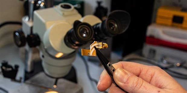

The new terahertz quantum cascade laser could enable high-speed transfer of up to 100 gigabits per second. (Image Credit: University of Leeds)

Instead of relying on external electronics, the team used acoustic waves to vibrate the quantum wells in the terahertz quantum cascade laser. They produced sound waves by projecting a pulse from another laser onto an aluminum film. This resulted in the film’s expanse and contraction, which sent a mechanical wave through the quantum cascade laser.
"Essentially, what we did was use the acoustic wave to shake the intricate electronic states inside the quantum cascade laser," said Tony Kent, professor of physics at Nottingham. "We could then see that its terahertz light output was being altered by the acoustic wave."
