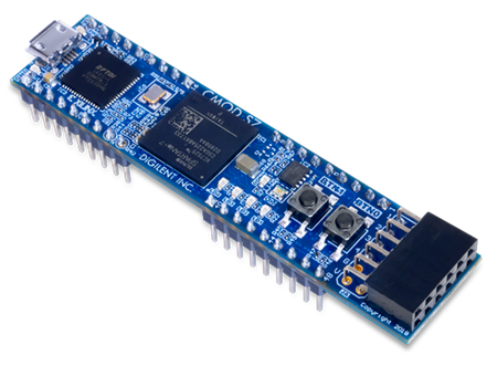

In this example project, you will learn how to use the Cmod S7-25's Spartan 7 FPGA's analog-to-digital core with a Microblaze processor. Xilinx Vivado 2018.2 SDK is used to program the bitstream onto the board and to build and deploy a C application.
Digilent Cmod S7Digilent Cmod S7 is a small, 48-pin DIP form factor board, populated with 36 pins, built around a XilinxRegistered SpartanRegistered-7 FPGA that brings FPGA power and prototyping to a solderless breadboard. The board includes a Quad-SPI flash for programming, as well as a USB-JTAG programming circuit and USB-UART bridge. The Cmod S7 also features a clock source, Pmod port, and onboard I/O with LEDs and pushbuttons.
