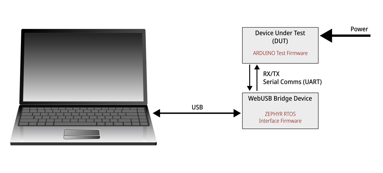

3.2. Practical Application (Functional Circuit Test Interface)
3.2.1 Embedded Device Firmware
If your PCB undergoing a FCT includes a microcontroller then it's quite likely that you'll use test firmware to handle various test scenarios. In my demonstration below, I used an Adafruit Metro RP2350 as my DUT and the test firmware was developed on the Arduino IDE. In my Arduino Code I simply used keywords to control the different tests. The two test cases included were copies of existing Arduino library examples.
