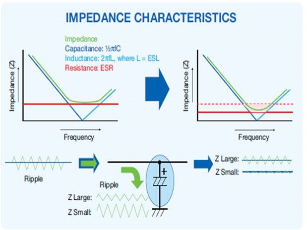

The Polymer technology offers fantastic Frequency Characteristics.
Thanks to their ultra low ESR values, polymer capacitors have a low impedance neartheir resonance point (see Image Below). And lower impedance reduces AC ripple in power circuits.
Panasonic testing has revealed as much as a fivefold reduction in peak-to-peakvoltage changes when comparing polymer capacitors to conventional low-ESR tantalum capacitors.

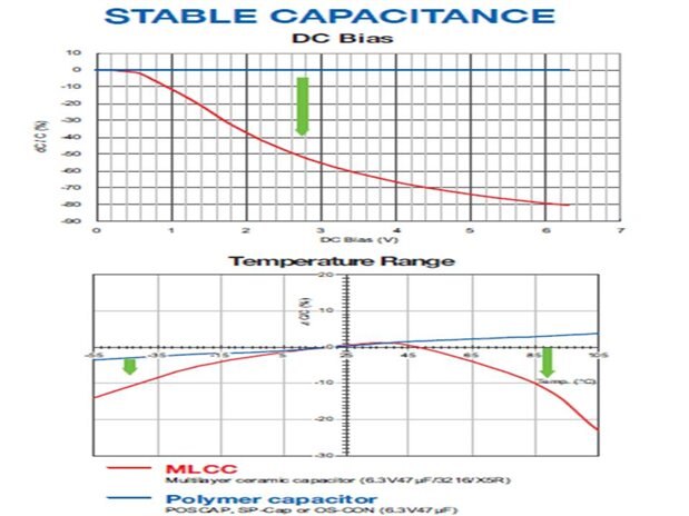

Stable capacitance
With ceramic capacitors, capacitance drifts in response to temperature changes and DC bias.
Polymer capacitors have no such problem and remainstable over time .This stability is particularly important in industrial and automotive applications, which tend to experience fluctuations in operating temperatures. We’ve seen cases where elevated temperatures caused an effective capacitance loss of 90% or more for ceramic capacitors, meaning that the conventional capacitor.
