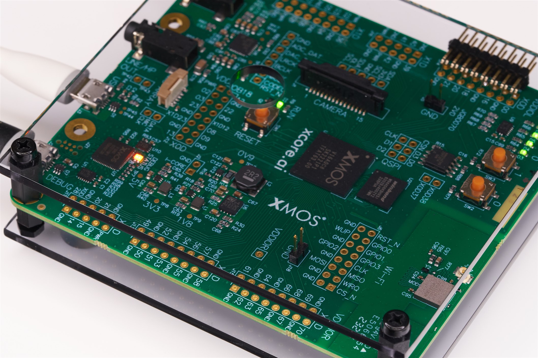

But first, the photo snippet here shows the heart of it, the main processor system, containing the XMOS device, the SPI Flash, and power supplies. The SDRAM chip visible in the photo (north of the XMOS part) would not be needed for all applications but would be useful for storing (say) large amounts of data captured for processing or transmission. To put it in perspective, it could easily support several hundred times more RAM storage than a conventional microcontroller might have built in. It’s very unusual to have such a powerful memory interface for a microcontroller, and it’s only available if you’re using the BGA-packaged XMOS part as this board is using, instead of QFN or TQFP variants (and all packages have a decent amount of RAM, 1 Mbyte, internally, and internal throughput is very high if code is designed to allow many cores to access it; each core can access 256 bits, i.e. 32 bytes! per clock cycle).
A 24 MHz crystal and all decoupling capacitors are on the underside. The core power supply is 0.9V, and the evaluation board also contains 3.3V and 1.8V supplies for input/output signals.
If you wanted to make a minimal XMOS system for (say) a 3.3V system, then the main things you’d need are the XMOS microcontroller, a 0.9V core, and a 3.3V I/O supply, and an SPI Flash chip. You’d also ideally purchase a (cheap) XTAG-4 debugger tool, although that can be worked around, having it will make life a lot easier for the developer.
Building a minimal XMOS system will be the subject of another blog, so if you have ideas, it would be great to hear them.

The board is well thought out, and I liked it. It breaks out loads of GPIO to the left and right side (these are at 3.3V logic levels but can be switched to 1.8V logic), and there is a central portion of GPIO, which is set to 1.8V only on the eval board.
You can also see that there is a built-in audio codec, connections for an optional microphone, and a Raspberry Pi camera.
There are some LEDs and buttons on the board, plus an 802.11 (wireless) module.
Power and computer interfacing is at the bottom of the board, using two micro USB connectors.

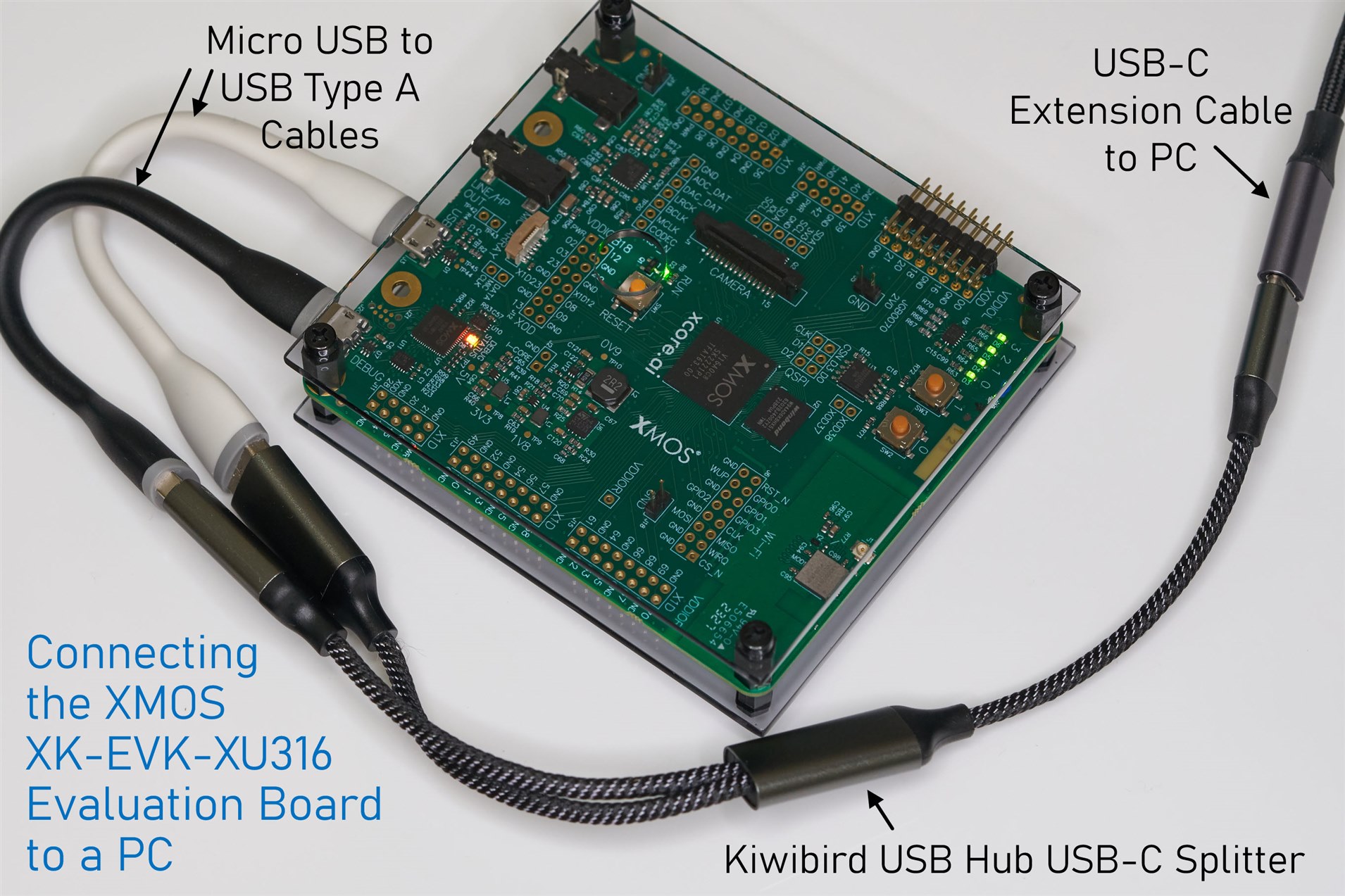

Getting Started with the Hardware
Minimally, you’d use two micro-USB cables to power up the board and access the on-board debugger via USB. To simplify connections to the PC, you could use a USB hub. I used a little splitter cable with built-in hub functionality. Don’t plug it into the PC just yet however; first the software needs to be installed, as discussed below.
You might also want to purchase pin headers to make accessing the GPIO easier. Also, some audio cables and headphones/earphones could be handy for trying out digital signal processing (DSP) applications. There is a different XMOS evaluation board, incidentally, for those more focused on audio applications for the devices.

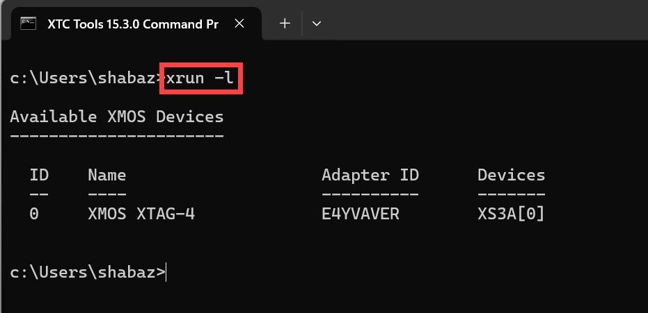

Next, you’ll need to plug the XMOS Eval Board into your PC. Both USB connectors on the board need to be plugged into the PC (because one connector is used for the debug interface, and the other is used for power and USB access for user applications running on the microcontroller). As mentioned earlier, you could use a little USB hub, to reduce the connections to the PC.
With the USB cables plugged in, the four LEDs in the corner of the board blink in a particular sequence by default. I could see in Windows Device Manager that an XMOS XTAG-4 device had appeared under Universal Serial Bus Devices. I launched the XTC Tools Windows Command Prompt and then typed:
xrun -l

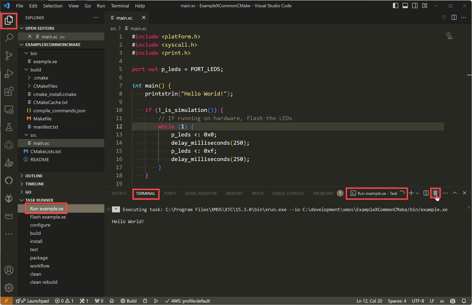

Run the code In VS Code, select the Explorer icon, and then under Task Runner, you can click on either Run, or Flash (depending on if you want the code to run temporarily on the board or stored in the on-board SPI Flash)

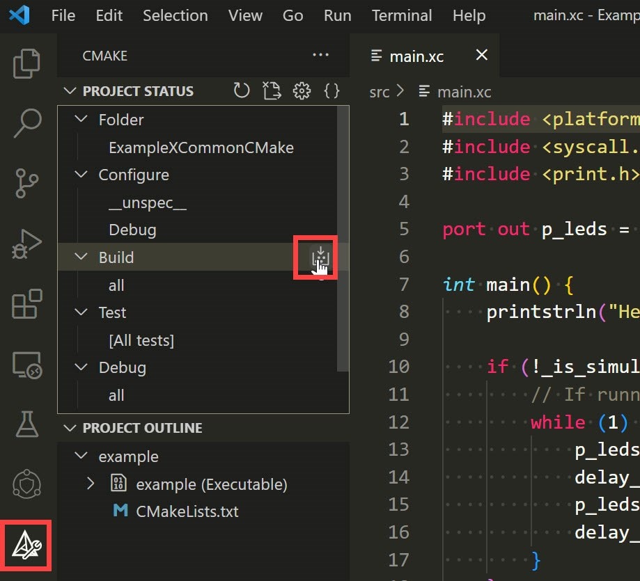

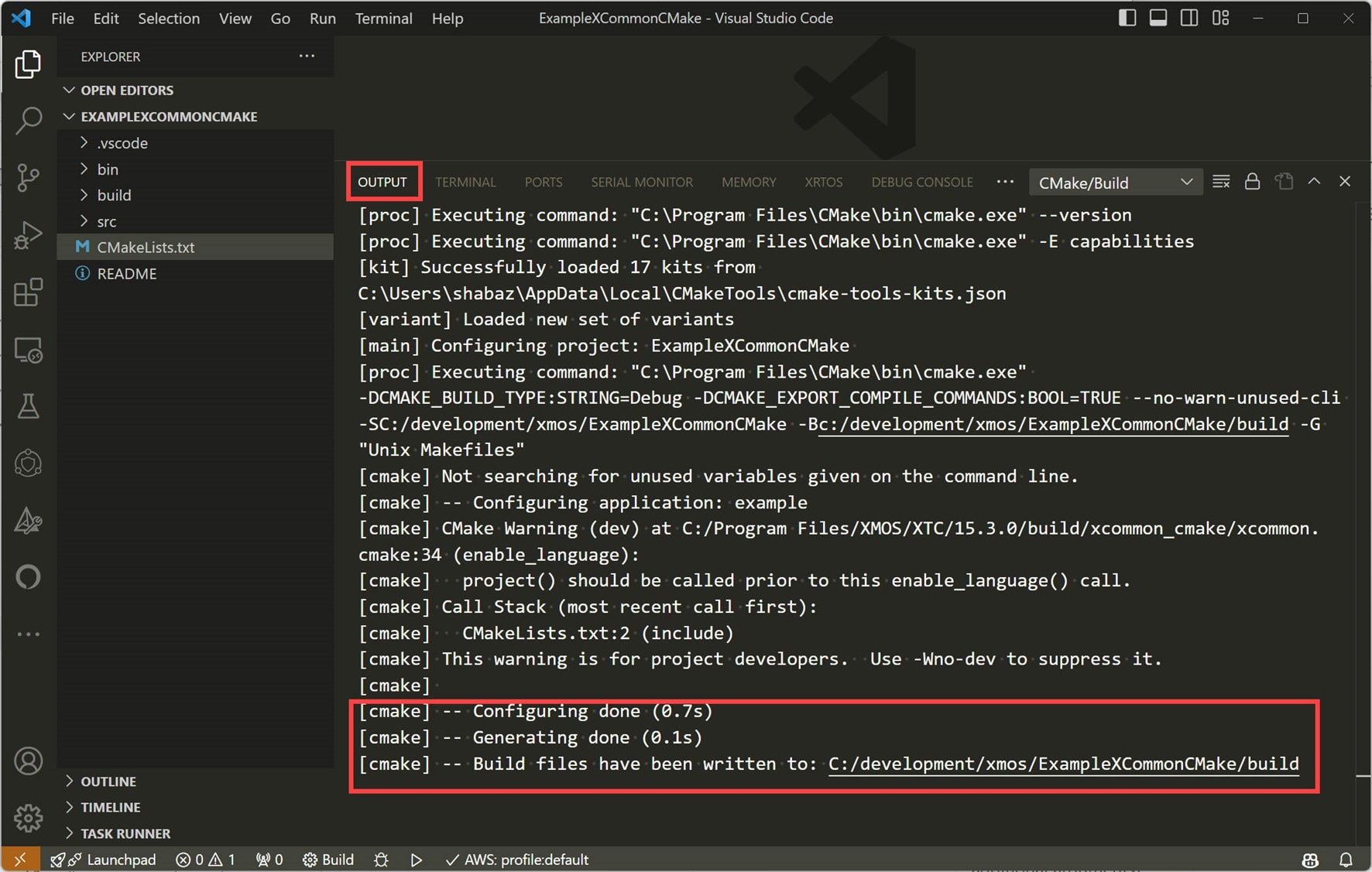

Once launched, there’s a step that needs to be done, which concerns selecting CMake in the left-side icons, and then under Configure, click on [No Kit Selected] and then choose “unspecified”. Note that you may automatically be prompted at startup the first time, so you can simply select “unspecified” if prompted.
Once you do that, then you should see the following output. If you don’t see it, close and restart VS Code (using the same “code .” command as before), and give it a second or two, and the output should appear.
If there’s an error and you don’t see that, then that could be because either the CMakeLists.txt file is missing from your project folder where you launched VS Code from, or perhaps the VS Code user settings JSON file needs correcting (there is a cmake.cmakePath setting there, which needs to point to the full path and filename for cmake.exe, which should usually be:
"cmake.cmakePath": "C:\\Program Files\\CMake\\bin\\cmake.exe",
If all has gone well, then build and bin folders will have been created within the project folder.
Now the code can be built!

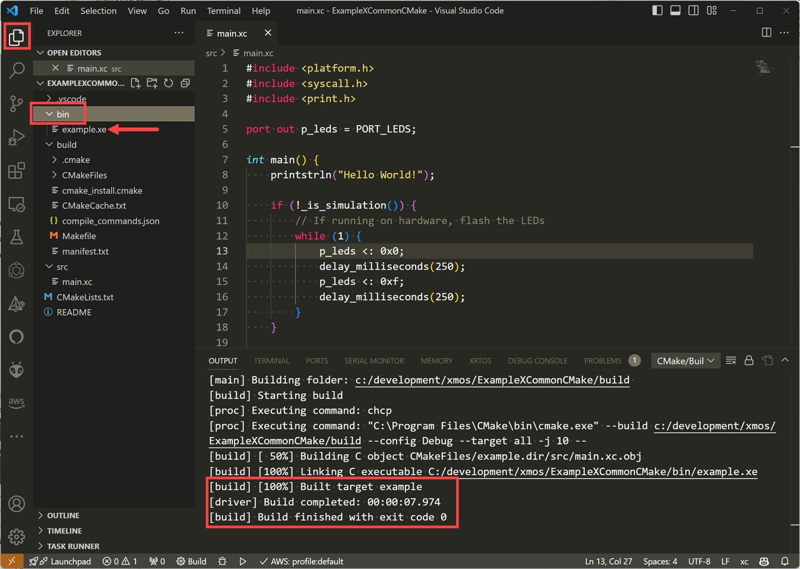

Click on the CMake icon in the left side panel, and then hover next to Build to see the little icon to click on.
If all goes well, you should see the output shown below. The bin folder should now contain a .xe suffixed file! This file contains the built firmware, which will be uploaded to the XMOS board.
To run the code, click on the Explorer icon in the left pane, and then expand the Task Runner if it’s not already expanded. There are Run and Flash options there. During development, you could select Run, and the code will be temporarily uploaded to the board, and start running. Once you’re done, press the trashcan icon shown in the screenshot below, to kill the terminal view. To place the code into the QSPI Flash chip on the board so that it persists after reboots, select Flash from the Task Runner.

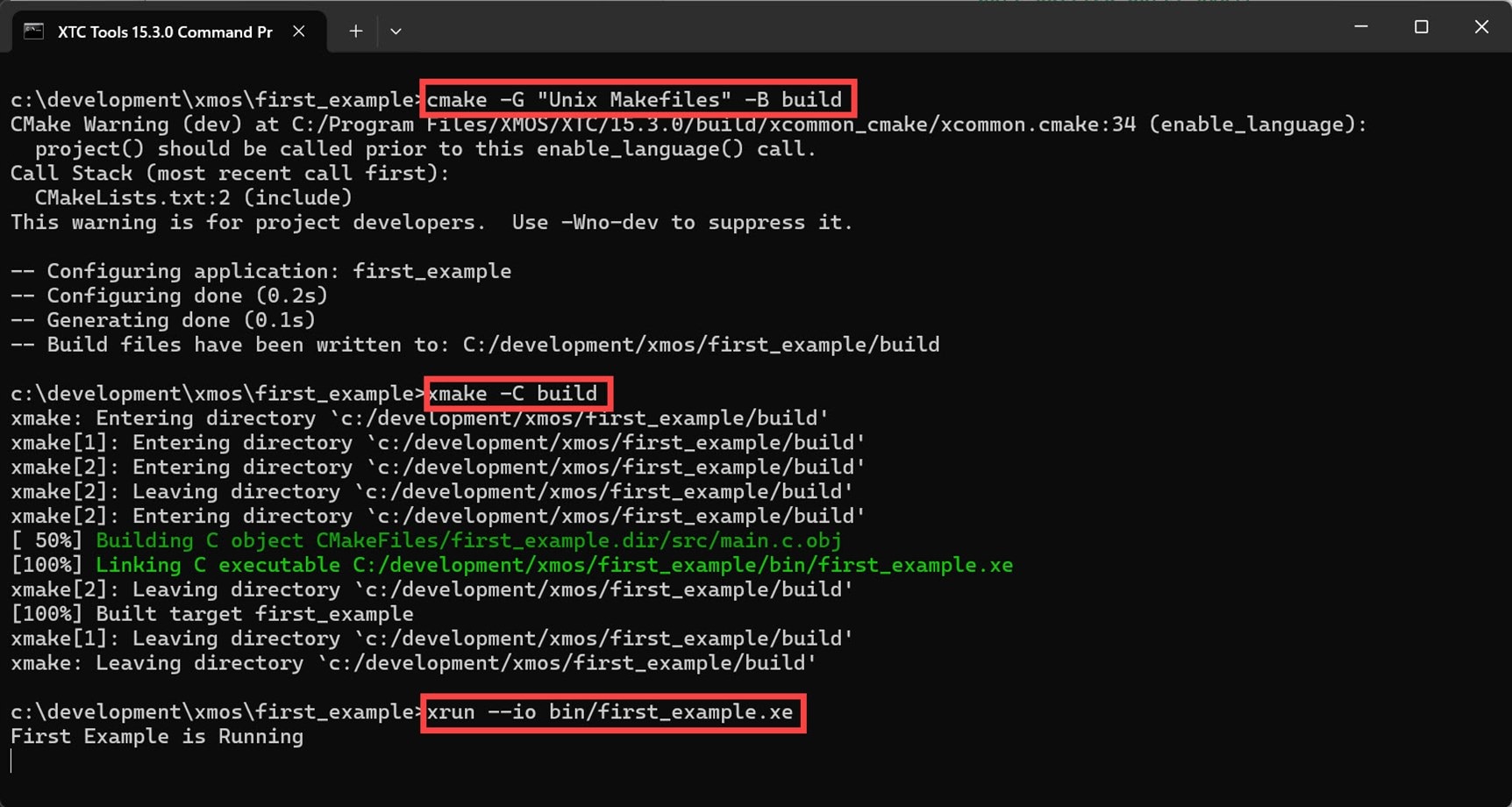

If you’re more of a command-line interface (CLI) guru, or if you wish to automate tasks, then the code can indeed be built and run from the command line instead. Typically, you’d type the following in the XTC Tools command prompt:
cmake -G "Unix Makefiles" -B build
xmake -C build
xrun --io bin/my_project_name.xe

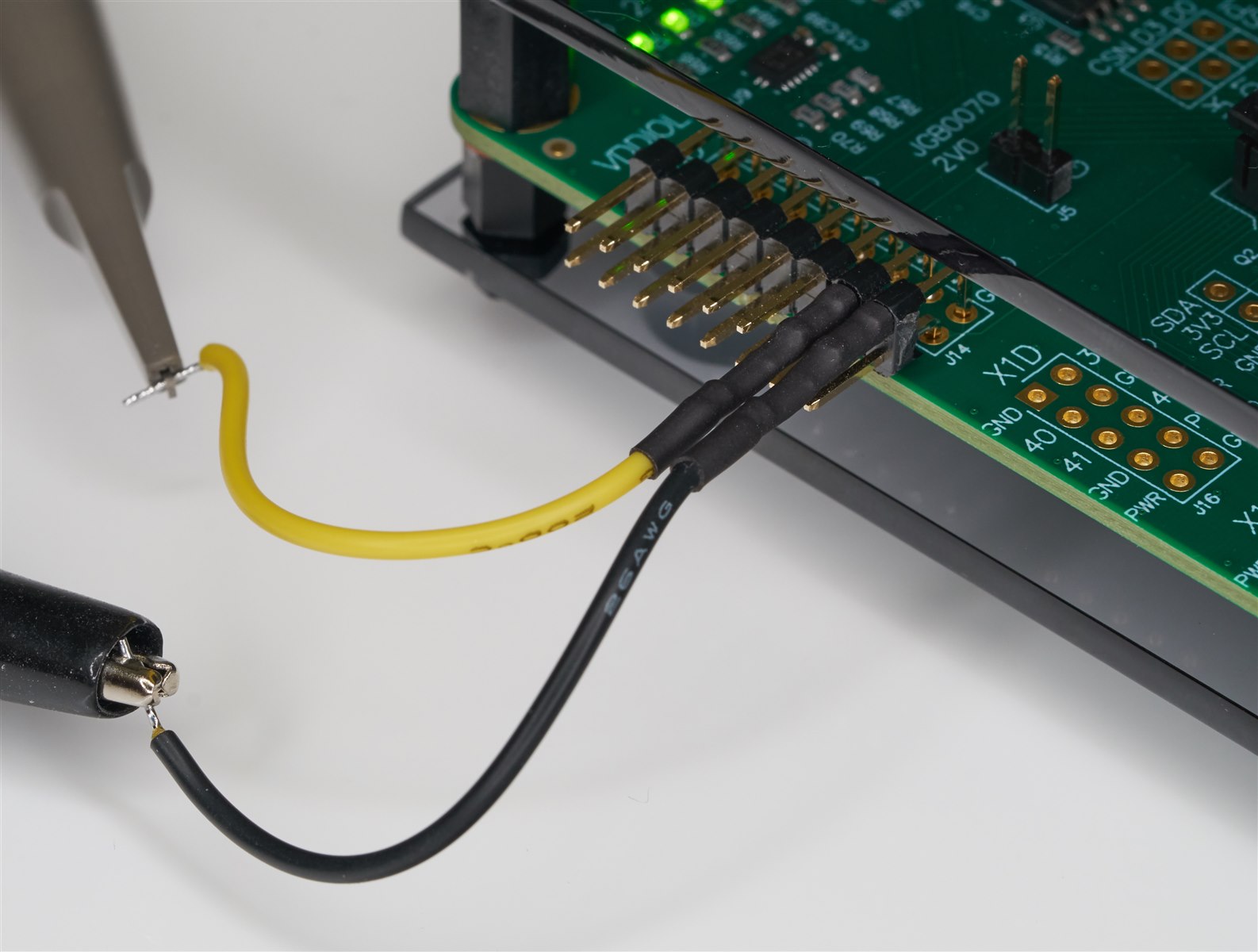

Anyway, back to the example, I wired up an oscilloscope to one of the GPIO pins, as shown in the photo here. There are four LEDs in a row on the evaluation board, and those connections are also present on the DIL header, and I connected up the oscilloscope to one of those connections.

The end result is a stable, precise 100 kHz signal, as expected. As mentioned earlier, any jitter is purely an artifact of the clock circuitry used (including PLL). You could, if desired, reduce this further by attaching an additional clock oscillator to the circuit, and using that as the clock source to the port counter.
