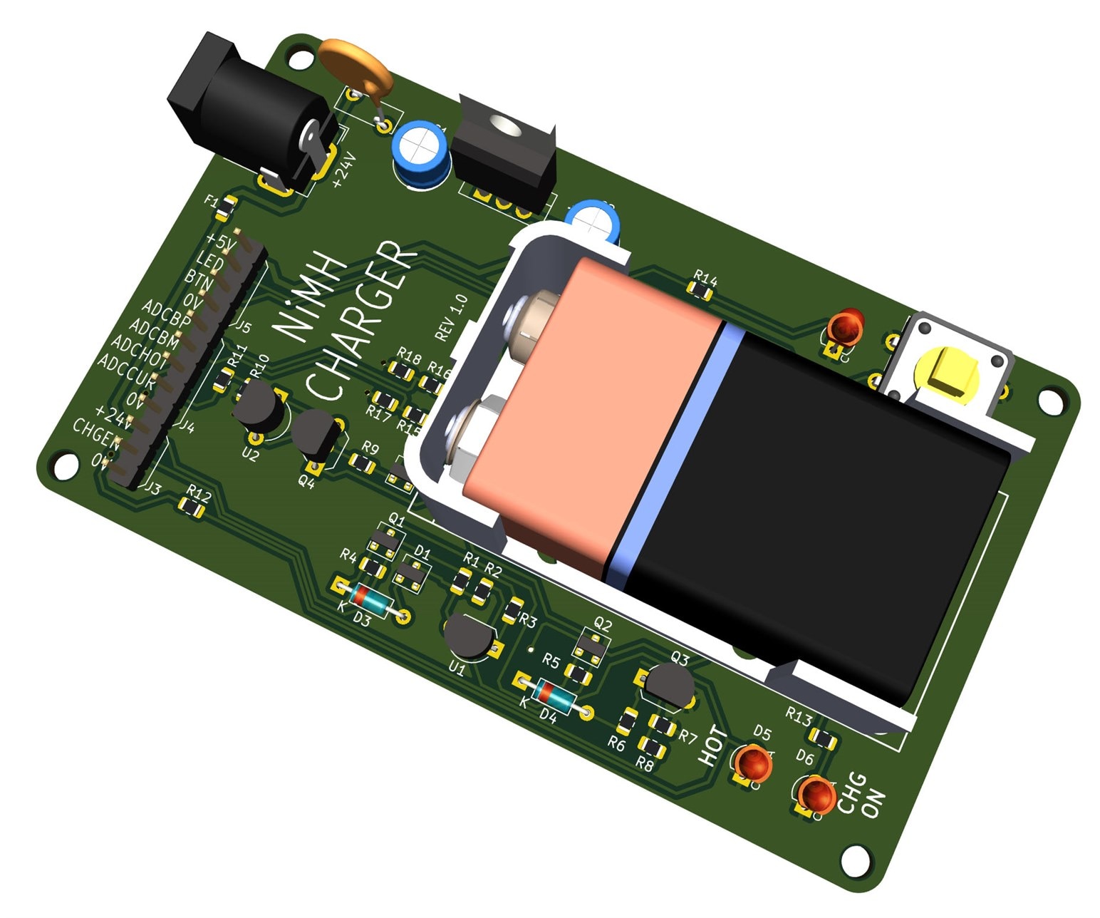

    I had some time, to lay out the PCB. This board is 100 x 60 mm and several different PP3 battery holders will fit. All parts are jellybean. The optional microcontroller is connected to the row of pin-headers…

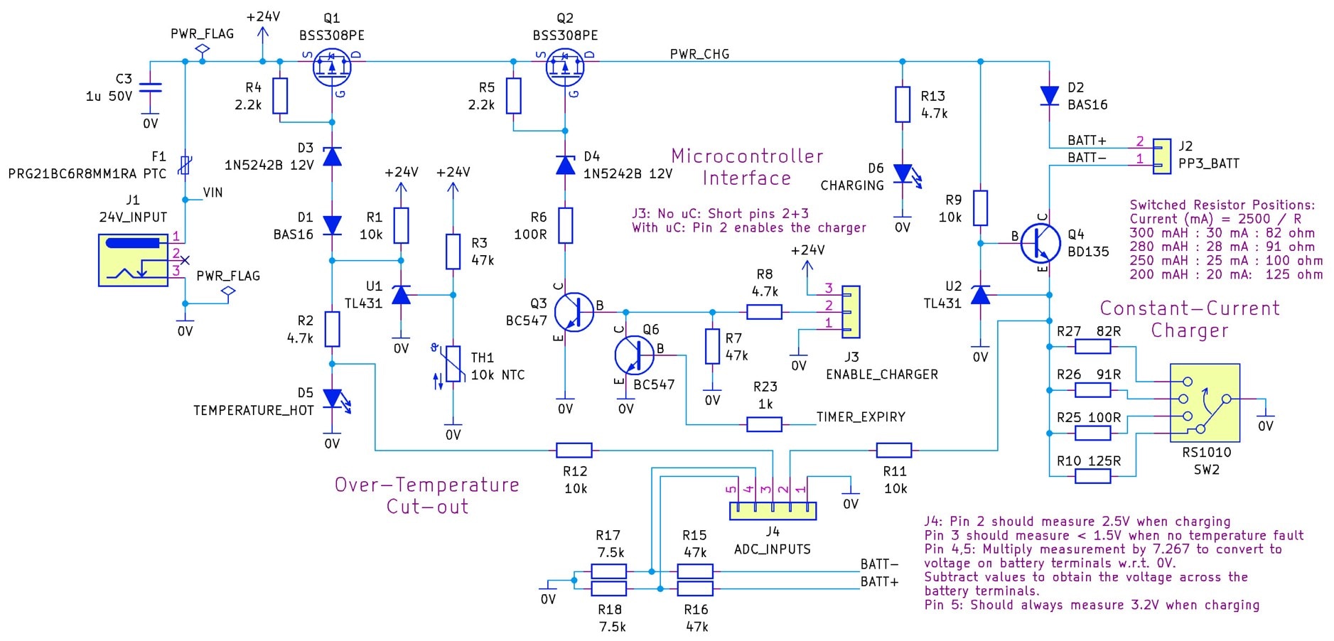

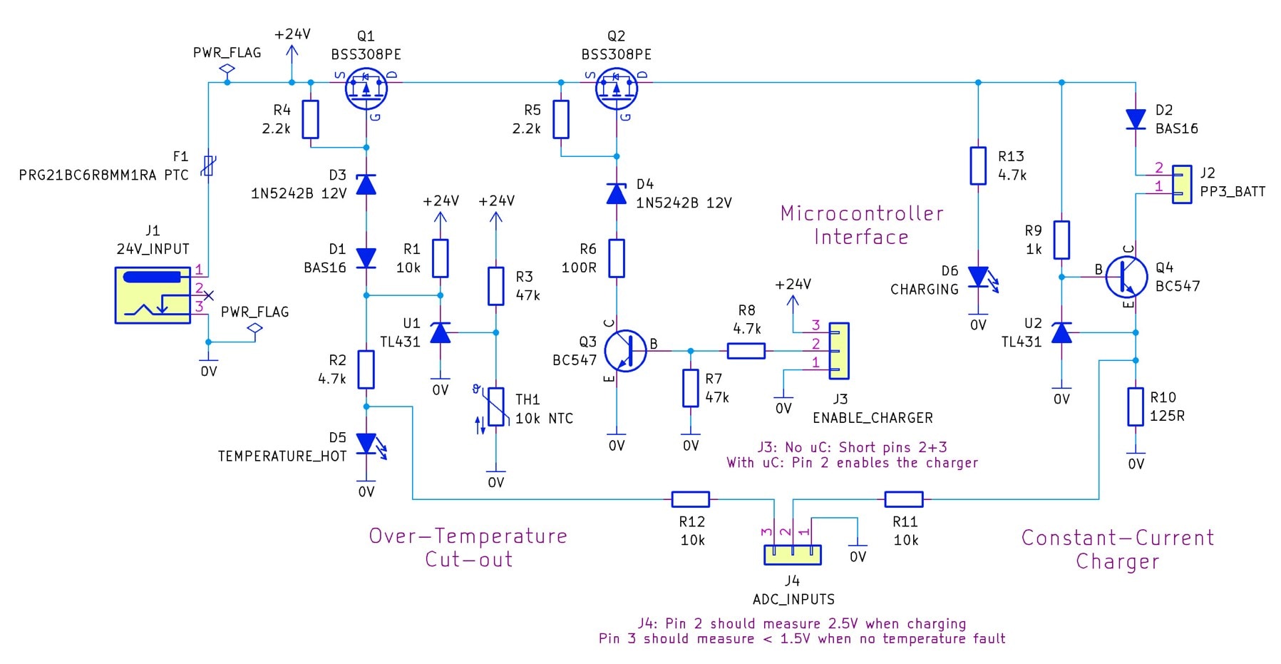

    I think the circuit below would do it. It's based off of a simpler charger here: Smart Doorbell System – Part 6 – Chime Module Complete Circuit Design and based on information from a battery mnfr PDF doc…

    I think the circuit below would do it. It's based off of a simpler charger here:  Smart Doorbell System – Part 6 – Chime Module Complete Circuit Design  and based on information from a battery mnfr PDF doc which specifies that it should be OK to charge at 0.1C for at least a day.
    This circuit charges at 20 mA, and would take 15 hours to fully charge the battery. The battery would need to be manually disconnected within 24 hours.
    However, there is also a microcontroller interface, so that you could turn it on/off based on a timer if desired (or any other logic circuit that can perform the timing).
    Without the microcontroller, you'd need to remember to disconnect after a day of charging. If you need a PCB for this, let me know (it's fairly easy for me to convert to a PCB, since I've already created the schematic in the same CAD software that would create the PCB).
    There's no guarantee that it will work, but it would be easy to test and then that would provide reasonable confidence with it (I'd trust this more than a cheap charger).

    I had some time, to lay out the PCB.  This board is 100 x 60 mm and several different PP3 battery holders will fit. All parts are jellybean. The optional microcontroller is connected to the row of pin-headers on the left side of the photo (without it, the user would need to disconnect after 24 hours as mentioned above).

    I'll wait a day in case anyone spots any errors/major problems, and then I'll generate the Gerber files and place the project on GitHub. There's no guarantee it will work, but if anyone tries the circuit, please report back with any feedback/mods!

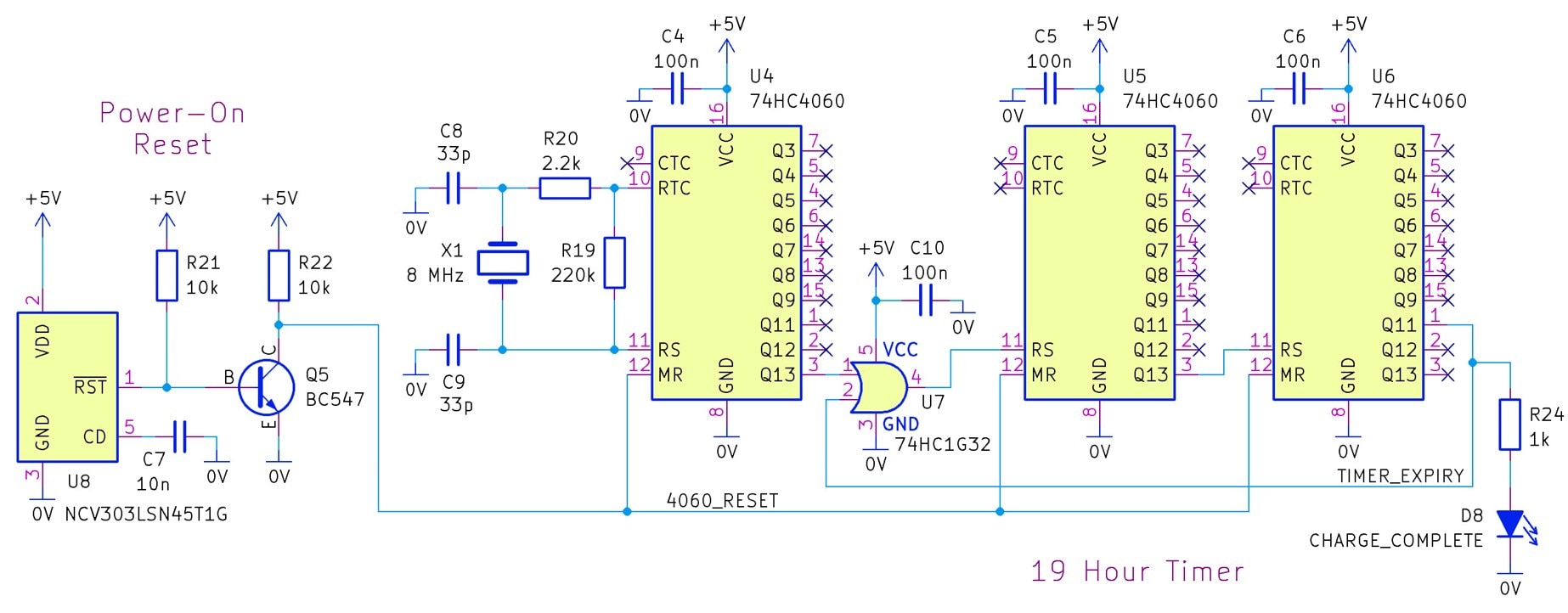

    It was bugging me that there wasn't a timeout. I've been in the position where I've forgotten to unplug a charger.
    The timer needs to be somewhere in the region of 16-24 hours. The design below (untested) uses a load of divider chips. It looks a lot, but 74HC4060 are cheap (and probably there's no size restriction). All parts here shouldn't cost more than a few $ total.
    The crystal output is just divided loads, and when 19 hours is reached, the TIMER_EXPIRY signal goes high, and that also prevents any more counting.
    The timer isn't essential, and if there's a microcontroller attached, then it's redundant (unless such a hardware timer is preferred).

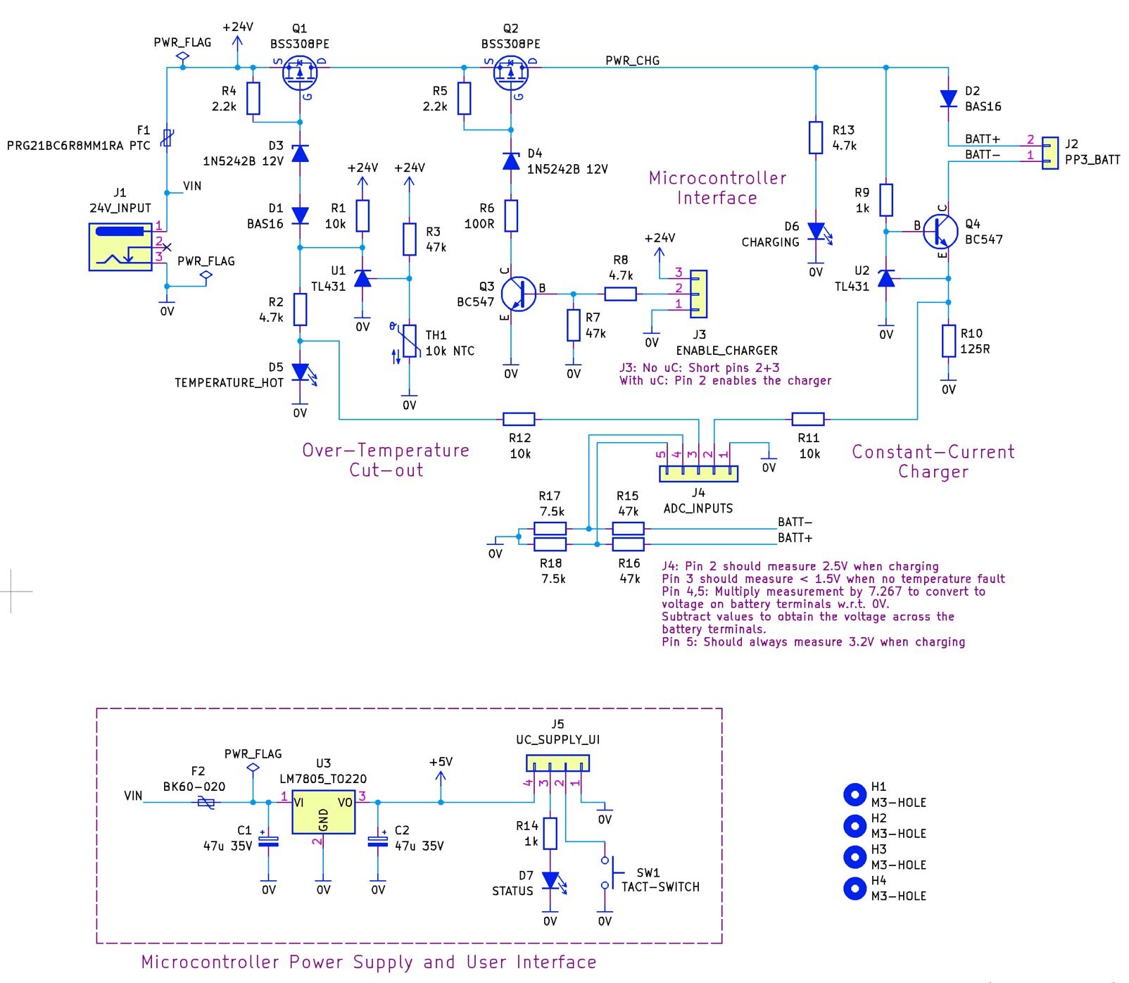

    The main circuit is tweaked to add the TIMER_EXPIRY connection as an input:
    Also, while I was at it, I replaced the constant current resistor with a rotary selector, since it appears there are PP3 batteries with a range of capacity. Probably overkill to have such granularity, but the rotary switch could be replaced with a wire link to permanently set a current if desired.
