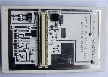

For years I've been looking for a way to make some simple PCBs at home. Getting boards fabricated just for a single layer was a waste of money for me. And most at home PCB etching was extensive, used a lot of chemicals, or I needed a CNC router. And now, I found a way to do it using a desktop printer, laminator, and a bucket. I plan on trying the below tutorial and print my own single layer PCB for a surface mount 10F222 based project I have been tinkering with lately. The tutorial seems straight forward, and apparently it takes about 1 hour to complete. Sounds better than waiting for a fab house to make some PCBs.

    Hi, I didn't look at the tutorial but I use the same technique with pretty good results. Be careful, some toners work better than others. I had a Brothers laser printer at home and it didn't really work…

    I didn't look at the tutorial but I use the same technique with pretty good results. Be careful, some toners work better than others. I had a Brothers laser printer at home and it didn't really work. Take a look at http://www.pulsarprofx.com/ for toner transfer paper and other useful products. Probably not the cheapest you can find, but it works.
    You might need to experiment a bit, but once you find a good recipe, you get consistent results. Have fun!

    I have never tried the toner on copper clad board approach, i use my laserprinter to print the artwork on transparant sheet (overhead project sheet). I always print 2 and put them on top of each other with scotch tape (2 layers of toner is blocking the UV-light more). I have an UV-unit (self build) and some chemicals (Natronlog). If use use the natronloog heat it to let's say 30C and use a brush to fasten the development process (most important!).
    But i come back to the toner on PCB appoach. I was always looking for a way to make service printing (it helps for assambly and looks more professional). The toner on glossypaper is most usefull to make the top layer silk screen (service printing). Most CAD tools have the 'mirror text' option, you have have to carefull how to print the text. It is better to make a logbook to write all the step done to make a good PCB, because you will do it once a while and these details are not easy to remember.
    O bye the way. The service printing step is almost the last step (even after drilling).
    Best regards, Enrico

    I use a Canon MP270 Inkjet printer on standard print settings, print circuit from Eagle CAD ( double sided ) onto HP Premium Inkjet Transparency.
    I then make a sandwich, double sided pre sensitized pcb between top and bottom layer artwork. Then sandwich all between 2 layers of thin glass to hold everything in place.
    Expose for 2 mins either side in a UV exposure unit (home made).
    Then straight to etching in a bubble etch tank for 5-10 mins.
    Using this method it is possible to make a board with very fine pitch IC's in about an hour, at very minimal cost.
