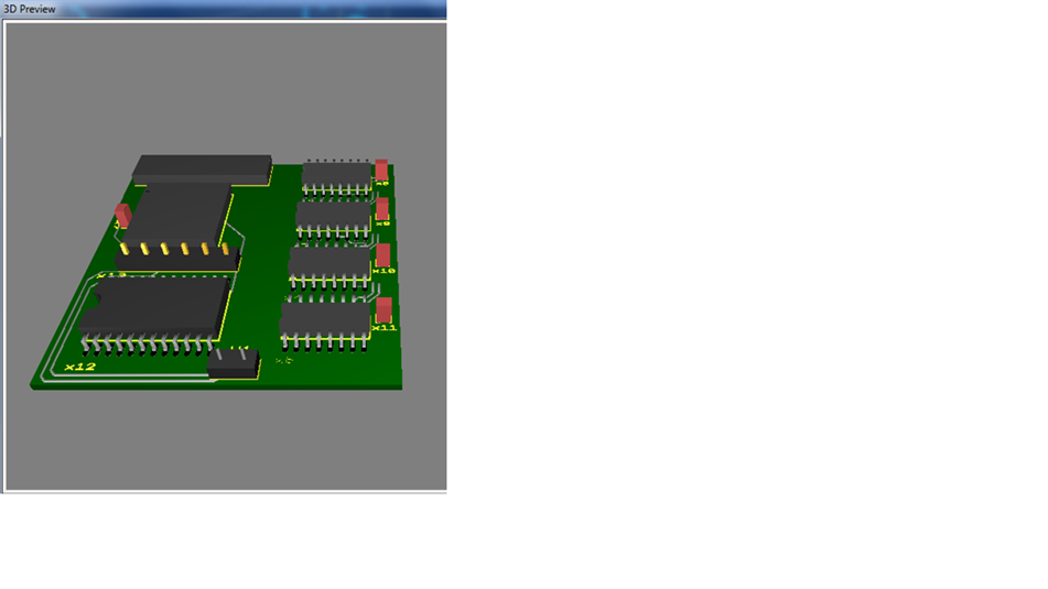

    I started designing the PCB, I like NI's Electronic workbench 3D representation, all fits on a 4cm x 4cm board (needs a few connectors on there and a few op-amps): image
