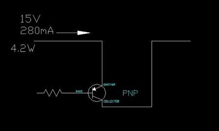

When I power the base, I am cutting off the current flow through the Collector and Emitter.
However, when the base is off, I will need to conduct 4.2W through the transistor.Now, I am having trouble sourcing a transistor for this situation.
This is for a automotive part, in the end. So, if anyone has ever worked in that industry, what % do you go over the bare minimum ratings per transistor? No one here at this job seems to want to help me. The curse of being a contractor.

  • Jorge_Garcia
    Jorge_Garcia over 15 years ago in reply to Catwell
    Cabe,
    This transistor is going to a load right? If that is the case the transistor is not dissipating all 4.2W of power otherwise there would be none left for the load. Maybe you're doing it as a safety margin sort of thing, but you need to be specific because in the long run overspecing can cost you money.
    Looking at the datasheet the VCE saturation voltage for this transistor is not specified, however a CONSERVATIVE assumption of 1V VCE drop (most transistor have a Vce drop 0.2-0.6 in saturation), you can determine how much power is lost the the transistor as heat.
    In your case 1V x 280mA= 280mW of power lost in the transistor. Looking at the NTE397NTE397 data sheet, it says that maximum power dissipation at 25C is 10W, it specifies to derate this value by 57mW/C therafter. I don't know how hot a car can get but assuming (Extreme Case, I know) the transistor was operated with at 125C(257F) ambient the transistor could still dissipate 4.3W (10W- 100C*57mW/C) so you're golden.
    You can safely use the NTE397NTE397, and you'll still have plenty of margin.

  • enrico.migchels
    enrico.migchels over 15 years ago in reply to Catwell
    Hi Cabe,
    Probably you are better off driving a N-channel mosfet in the negative rail of the power supply. This has several advantages: N-Channel has lower RDS(on) and the drive circuit is more simple. The FET can even be driven from a normal uc-output.
    Best regards, Enrico Migchels

  • Catwell
    Catwell over 15 years ago in reply to enrico.migchels
    Enrico,
    You are always one step ahead of me in your suggestions. I just found that an N-channel Mosfet would be best for my design, and then I read your reply. If, I only read it first.
    I want to use it to cut the power to a LED. My plan is to activate it with a inverting transistor.
