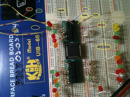

Hello,
please , i want to program AD75019 , an analogue Cross point Switch from analogue devices 16x16, with FPGA, ad75019 have a serial interface, i'have to shift 256 bit into 256 bit shift register , once the register is full i apply a PCLK pulse to to transfer the register to latch (like it's mentionned in the datasheet) my problem is, that i can'T close or open any switch image
please , anyone could help, thanks in Advance
this my configuration:
VDD:11V
VCC:5V
VSS: 0V
SCLK: 1MHZ
this how i did the spi interface : a shift register of 256 bit with a state machine for controlling PCLK signal:

    I note also that after a while like 30 minute SCLK =0 V !
  • michaelkellett
    michaelkellett over 14 years ago in reply to e14 Contributor
    Hello Hachani,
    Obviously something is wrong !
    Check that you have a good earth (0V) connection between your scope, FPGA and the AD75019.
    Are the pulses nice and square ?
    Are the low voltages all close to zero ?
    Can you post a picture of the setup ?
    Michael Kellett
    e14 Contributor over 14 years ago in reply to michaelkellett
    HI Michael,
    i tried every solution that i know, but it still not working imageimage , i join a picture for my setup , you will see many diode, i put them just for testing in case my signal is driving to another output, my input could be any one of them
    i used oscilloscope for triggering a single sequence,  and i found that my sclk, pclk and sin are well sending (time diagram is respected ) , for the SOUT i don't receive any signal image, don't you think that there is some initialisation like sending a number of bits for initilazing ?
    AD75019 has a digital ground, since there's a capacitor the potentiel on dgnd is 3.3V
    since all switch are closed, the potentiel of the rectangular pulse, become less than before
    for the low voltage, i have just Vss and DGND, so i connect Vss directly to the ground so Vss=0v and DGND is connected to the ground through a 0.1uf capacitor so DGND=3.3V
    thanks for your help Michael
  • michaelkellett
    I have to rush now so I'll think about it again tomorrow but I'm sure the problem is that digital ground must be at the same potential as analogue ground.
    Michael Kellett
    ok thanks Michael
  • michaelkellett
    Hello Hachani,
    It would be nice to see an circuit diagram but I am sure that you need to connecto 0V to DGND directly, not with a capacitor.
    The 75019 logic is like a big shift register so you won't see your input data coming out of it until the 256th clock pulse.
    Michael Kellett
    Hello Michael;
    good news image , the AD75019 works finally , thanks to your recommendation ; it was about the DGND , when it's connected directly to the ground  it works correctly, i'm very grateful to you imageimage, can you tell me please why you was sure about it ?
    thanks a lot Michael

    I'm very happy it's working now. Almost any chip with multiple grounds needs them all to be at almost the same voltage. The AD75019 is a bit odd in that it doesn't have an AGND connection on the chip but it still needs the DGND to be at the right potential relative to the the three power supplies and the only way you can make this happen is if the supply 0V (AGND) is directly connected to DGND.
