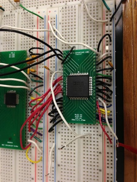

    I am working on a project with the AD75019 and have been facing some problems. I read your post and discussion and figured that you might be able to help me out a little bit.
    I am trying to program the AD75019 using at PIC32 microcontroller. I am currently testing the chip for a single input single output configuration. Before I get into the programming part I'd like to know if my connections are right. Must the PCLCK pin be from a clock pin of the microcontroller or can it be any digital output from the microcontroller. I have currently connected it to a digital output pin from the microcontroller and after entering data into the serial buffer register of the microcontroller I output a logic low on the o/p pin and a logic high to represent an active low pulse. I am not sure if that is the right way to go about it.
    Also, the power supply connections. I have connected the Vdd to +10V; Vss = Grnd, Vcc = +5V. and as for the DGND pin, should it be grounded or left open or bypassed with a capacitor?
    Sorry to bombard you with so many questions but then I have been trying to program this chip for a while now and there isn't a lot of resources or support for this device. Looking forward to your assistance.
    Thank you

  • michaelkellett
    michaelkellett over 13 years ago in reply to e14 Contributor
    @ Rudhram,
    Can you post a diagram showing all your connections.
    Normally I would expect you to connect  a 5V supply between DGND and VCC, a 12V supply between VSS and VDD and connect VSS to DGND.
    Watch out for the sequencing note in the data sheet (turn on the 12V supply first). Make sure you have some kind of current limiting in your power supplies while you are experimenting or you may fry a chip or two.
    Your connnection for PCLK sounds correct.
    MK
    e14 Contributor over 13 years ago in reply to michaelkellett
    Hello Michael
    Thanks for your response, I got distracted away from the AD75019 for a while and had to get used to programming the dsPIC33E and ads1298. However, I am now back to using the ad75019, and the problem still persists. only now, i am not sure if it is the hardware/connections or the code. I have attached an image of the switch, the top four pins on the left are PCLK, SCLK, SIN and Vss respectively and on the right side top, the second, third and fourth pins are the Vdd and Vcc and DGND respectively. I am using one input (X15) and one output (Y15), everything else has been grounded to prevent crosstalk.
    I have a feeling that the problem is associated with the power supply sequencing because after running the program, if I remove both the power supply connections (Vdd and Vcc) I get a distorted version of the input signal on the output.
    Looking forward to hearing from you.
    Thank you
    Cheers

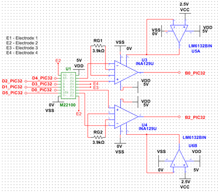

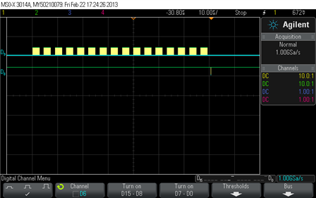

    e14 Contributor over 13 years ago in reply to e14 Contributor
    Hello Michael and Hachani
    I have moved forwar with the AD75019 and I just managed to obtain control of the switch. I was operating the switch at less than minimum power supply and my SPI communication was incorrect. I did not even notice that my code was incorrect and was sending 128bits instead of 256. This has fixed the problem and the switch works fine. It however, does not switch fast enough. The data sheet says the total time to be 52micro seconds, but anything short of 70 microseconds affects the output.
    That is the timing diagram for the switch communication (70microseconds). Anything shorter than this results in erroneous communication.
    That being said, I have a question regarding the settling time of the switch. Nowhere in the data sheet is there any mention of the Signal Settling time. Would you happen to know about the settling time.
    Michael, please find below my schematic of the circuit. Only correction is the Vdd for the switch (M22100) is +6.8V and Vss is -6.8V. Vcc is 5V.
    The switch works fine but just the timing that is not right, I wonder if it has anything to do with the power supply.
    . image
    Thanks
    Cheers
  • michaelkellett
    Hello Rudhram,
    First the easy bit:
    AD get the 52uS from a 5MHz sclock and 256 bits to send. Actually this works out to 51.2uS. From your scope trace it looks as if you are sending the data in 16 bursts with quite long inter-burst gaps. (I can't be quite sure because you don't say if the top scope trace is clock or data.) If you do have gap every 16 clocks this would expalin why you need 70uS to get the data into the switch.
    AD quote the PCLOCK to switch on/off time as 70nS, they don't describe exactly what they mean by on/off but since your INA129U needs 2.5uS to settle within scope trace width and 5mS to 0.1% (from the data sheet) I don't think the switch settling time is going to be an issue.
    MK
