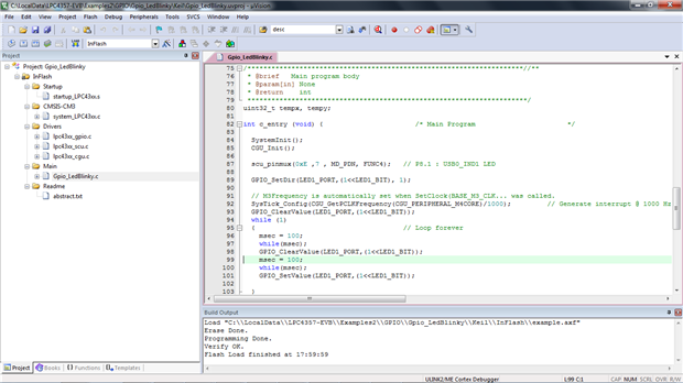

Hi all,
I recently bought a development board LPC4357 - EVB .
I can not so much regarding ARM programming or no experience when it comes ULINK2 , Keil and LPC4357 - EVB .
I have downloaded Examples2 \ GPIO \ Gpio_LedBlinky project .
When I program GPIO_ledBlinky in InFlash mode.
All goes well , I see that LED flashes.
But when I remove ULINK2 from the USB port when the LED stops flashing.
Should not be the code to be programmed into the LPC4357 chip when selecting " InFlash " ?
And why can not program in SPIFI mode (the flash is full chip Erased before i try flash in SPIFI mode)
DIP switch is
1. Down
2. UP
3. UP
4. UP
I get an error like this pop-up message "ERROR: Flash Download failed - "Cortex-M4"
in Keil Build Output windows
Load "C:\\LocalData\\LPC4357-EVB\\Examples2\\GPIO\\Gpio_LedBlinky\\Keil\\SPIFI 64MB Debug\\example.axf"
Erase Done.
Programming Failed!
Error: Flash Download failed  -  "Cortex-M4"
Flash Load finished at 14:32:41

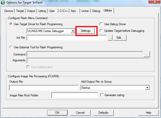

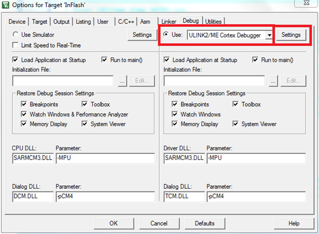

    I have selected the Inflash mode in Keil 5
    Here is my setup in Keil5
    Setup Option for Targets
    Setup for Utilities:
    Setup for Debug options
    Setup Debug Settings
    Setup Device Manager
    Video:
    ZyloTech

    zylotech over 11 years ago in reply to clem57
    Thank you for replying.
    I have succeeded image
    I removed ULINK2 JTAG connector from lpc4357 - EVB and then power off  and power on .
    Thanks a lot Clem Martins  image
    ZyloTech
