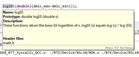

I'm using the Eclipse based ONSemi IDE for my RSL10 device.
I would class myself as a novice when it comes to using Eclipse IDE and the GNU / C compiler.
So this has me puzzled.
I've included math.h and it registers when I include the math function I want to use - in this case log10.

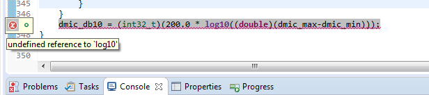

However, when I choose to build my project, I get an error "undefined reference to `log10'"
I'm sure it is something obvious.
Any idea?

    Can you post the whole source file and a copy of the build log?

    Have you instructed the linker to include the math library (linker options - Libraries)?

    With Eclipse there are occurances where the editor knows where the header file is , but the compiler not. This may be one of those ...

    probably math lib is not included in linker.
    -lm flag

    Thanks for the all the very useful replies.
    Yes, I had read online elsewhere that it might be related to linker but was not sure why, so very pleased to hear the same viewpoint.
    So after a bit of searching around I found the place for the "-lm" to be applied... and it works! Brilliant. Thanks so much for the help.

    Good news! This setting is configuration dependent. Setting it for the active debug config does not automatically set it for the release config.If you plan to build a release version, it’s handy to keep the settings in sync. If that’s not the plan, you can ignore it.
