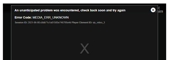

    The video seems to have errors:
    I can click this message away, bit it will not play.
