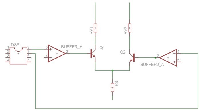

    I need to creat a fule tank simulater. A fule tank sensor is somthing like you can see in the picture below. The value for Rv and R1s is fix. My problem is that i need to crate a diceve that simulates the 2 resistor, R11 and R12. I don't have the permision to interfere whit the power supplay voltage. The only thing I can do is to get whit an ADC the electricity characteristics and uses the DAC to simulate the Resistor.
    When the tank is empty then R11 is 0 and R12 is 400ohm. also when the tank if full R12 is 0 and R11 is 400ohm.
    I macked some devices whit uC PIC16F PIC24F and i used the DAC and ADC in a realy simple way to pover a led ore somthing like this. I belive that it wold be more eficent to uses a DSP because it has more convertors and it's faster.

    In my opinion, the easiest way is to use 2 DACs for U11 and U12. Reading U voltage with an ADC, you can program DACs with very high resolution. PSOC1 fits the task.
    You only need to formally derive U11 and U12 as a function of R11, R12, with simple circuit analysis.

    I assume the Rv resistors are the coils of a crossed coil meter.
    This is a wheatstone bridge.
    Try this schematic. The pot has to be adjusted once for middle range. You can start with an other voltage source to drive the left transistor. If it works satisfactory, you can add the DAC and buffer circuits.. image

    0 e14 Contributor over 15 years ago in reply to jvdberg@ieee.org
    I cold use 2 DAC and buffers to control the tranzistors. Because the value for the input voltage may vary from 6 to 17v then I cold uses another ADC to monitorzate the input voltage. And if a variation ocures then to ajust the tranzistors. Because i need to check the software that evaluets the value of fule in the tank i need to control the value of bouth rezistors, in this cases tranzistors and set diferent values.
    I draw a quick schematic ... Sorry  i draw this schematic reali fest

    0 lpetacchi over 15 years ago in reply to e14 Contributor
    Just a suggestion:  close the op-amp feedback on Q1 (Q2) . This way you don't need a (matched) differential stage; remember to invert the connections to opamp inputs and check for stability.
