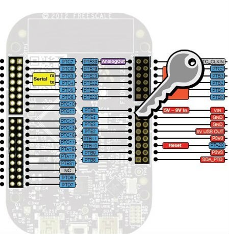

    You'll have to solder a switch between one of the inputs (here PTE4, across GND) and GND.

    In all honesty, I just used my house key to short between PTE4 and GND to test my program.

    Please read the basics; on this page the first sheets are on digital inputs. http://mbed.org/cookbook/Course-Note .
    I used PTE4 because GND is across, so it is easy to solder a switch between these points(see picture on this page: http://mbed.org/handbook/mbed-FRDM-KL25Z). In my program I used a pullup on PTE4, so it is high if nothing is connected, and if it is shorted to GND, the input is low.

    • As for the key: you can look up the pinning of the mbed on this page:https://mbed.org/handbook/mbed-FRDM-KL25Z
    • Here you can see that PTE4 is across GND.
    • This is how I made contactimage
    • I reccommend you to solder a switch and NOT be as ignorant as I was to use a home key. It was a simple trick, but very prone to shorting other pins.
