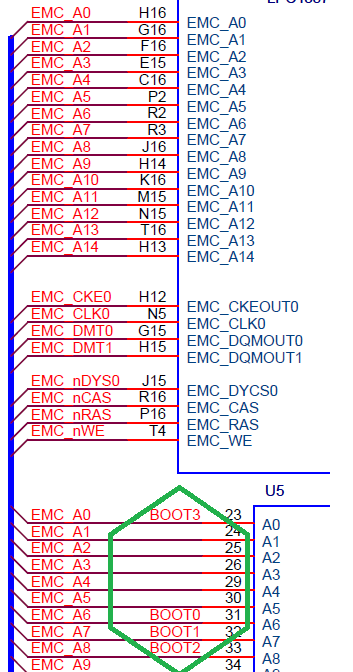

I have programmed my software into LPC4357-EVB board and it became totally unusable - can't use JTAG at all.
I suspect that PLL1 initialisation was incorrect so the micro simply locks up.
The question is: How can I reprogram the board?

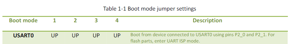

According to NXP spec, in order to get access to ISP I need to use USART0 or USART3.
However, on this board USART0 is hardwired to RAM and USART3 is connected to USB power protection chip.
Is it possible to reprogram the board without hardware modifications apart from soldering UART TX/RX pins?

    According to NXP LPC4357 User Manual (document UM10503) the following pins shall be configured for processor to enter ISP mode (to erase internal flash):
    For USART0 ISP access:
    P2_9 - LOW
    P2_8 - LOW
    P1_2 - LOW
    P1_1 - LOW
    P2_7 - LOW
    P2_0 - USART0
    P2_1 - USART1
    For USART3 ISP access:
    P2_9 - HIGH
    P2_8 - LOW
    P1_2 - LOW
    P1_1 - LOW
    P2_7 - LOW
    P2_3 - USART0
    P2_4 - USART1
    The whole process is described in sections 5.3 (Table 18) and 47.4 (Table 1065).
    Let's map these pins to the actual ball grid array outputs (see LPC4357FET256 datasheet for this):
    P2_9 - H16, connected to BOOT3 and EMC_A0.
    P2_8 - J16, connected to BOOT2 and EMC_A8
    P1_2 - R3, connected to BOOT1 and EMC_A7
    P1_1 - R1, connected to BOOT0 and EMC_A6
    P2_7 - H14, connected to EMC_A9
    P2_0 - T16, connected to EMC_A13
    P2_1 - N15, connected to EMC_A12,
    P2_3 - J12, connected to USB0_PPWR
    P2_4 - K11, connected to USB0_PWR_FAULT
    As you can see, none of the required pins go to the connector you mentioned.

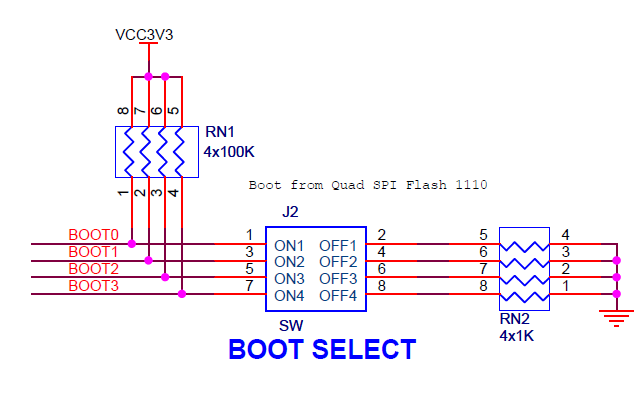

    The BOOTx pins are wired correctly and can be configured by the DIP switches. The P2_7 can be simply tied to ground or left as it is.
    It is the USART pins I have problem with.
    So far I can only think of two possibilities of how to use USART0/USART3 for ISP mode on these boards:
    1. Lift RAM address pins A12 and A13 for USART0 and lose external RAM in the process. OR
    2. Remove resistors R58 and R59 and also U18 for USART3 access.
    Please tell me I am wrong and there is a better way. Please.

    So setting the Boot dip switch before power up doesn't do what you need?
    http://www.farnell.com/datasheets/1682114.pdf

    Exactly!  image
    This is my problem. As these pins can not be accessed easily, I am unable to erase flash using USART0/USART3 ISP mode.

    Is there  a complete schematic for this board - the User Manual is just fragments?
    MK
  • aghogho
    0 aghogho over 11 years ago in reply to michaelkellett
    I am using an LPC-LINK2 and a J-LINK. Both of these cannot connect to the processor core and enable jtag debugging. I don't know if ULINK will work as well as a number of people have asserted that the only solution will be to put the processor core in ISP mode.
    There is a complete schematic available from element14 at http://www.element14.com/community/docs/DOC-51065/l/multimedia-evaluation-board-with-lpc4357?isRedirect=true#documents
