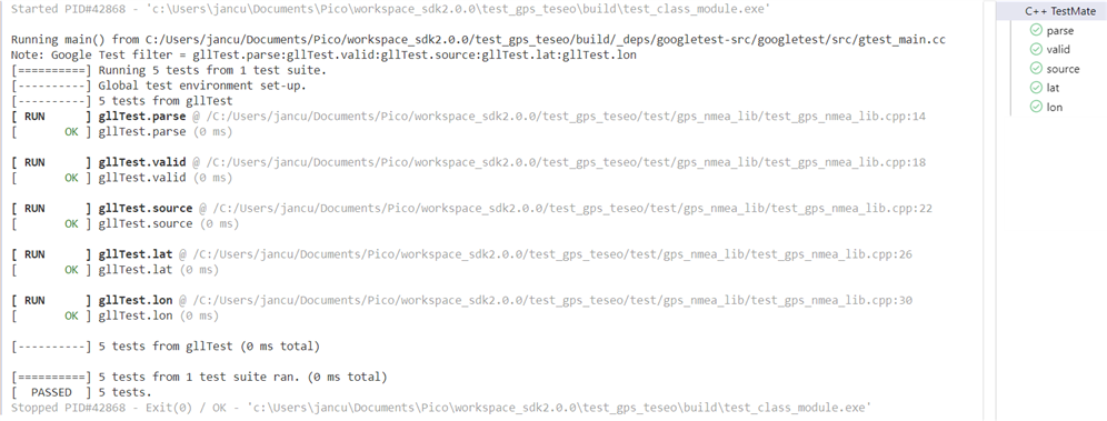

It's surprising how easy it is to define these tests. The test fixture, in combination with its SetUp(), takes care that each test can focus on validating one aspect of the class under test.
The library source didn't need any code change to make this work.
Output:
You can find the code on github. Check the CMake file in particular. It deals with some of the intrinsics of including GoogleTest, and dealing with potential link conflicts.
