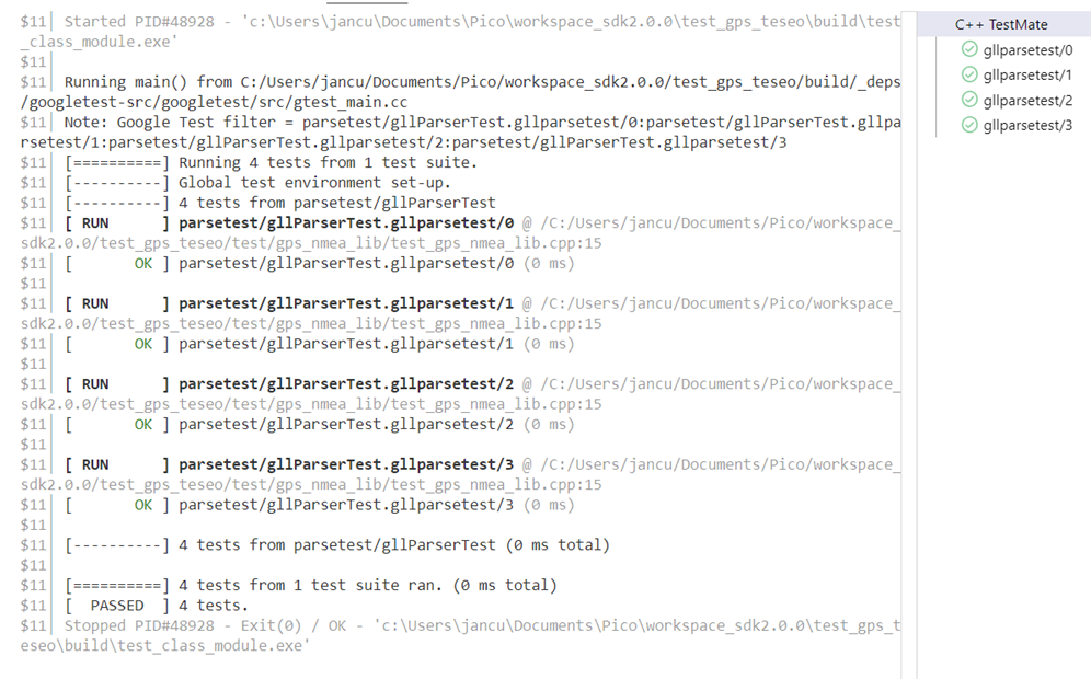

This week I'm going to learn GoogleTest for c++. Goals for day 4: test code with several data sets. In this case, I'm asking a GPS parser object (object under test) to parse sets of valid and invalid GPS payloads. The object should be able to report if the payload is valid or not (test condition).
The GTest WithParamInterface test fixture class allows that. I can write a single test case, and run that multiple times.
// generic template for NMEA parser unit tests
// base class for all test fixtures, parameterized or not.
template <class T>
class nmeaTest : public testing::Test {
protected:
    nmeaTest() {}
    T o;
// template for parameterised parser tests
// generic fixture that allows to test any nmea parser class' parser function
// with multiple data inputs
template <class T>
class nmeaParsersTest : public nmeaTest<T>, public testing::WithParamInterface<std::tuple<std::string, bool>> {
protected:
    nmeaParsersTest() {}
The class accepts two parameters each time it's executed:
  • a string. In my tests, that will be GPS payload data. Both valid and invalid data.
  • a bool: what is the expected result of this test. I'm expecting a true result only for valid payloads. My class under test should report false if the payload is not compliant
note: this test fixture also uses a template. You can ignore that for now. I'll review that in a next post.
Next, we declare the tests that we will do on the object under test:
TEST_P(gllParserTest, gllparsetest) {
    bool expected = std::get<1>(GetParam());
    std::string s = std::get<0>(GetParam());
    ASSERT_EQ(expected, o.from_data(s, o));
We retrieve the expected outcome and the test payload from the parameters. Then we ask the object under test to execute a parse test with that string, and compare its return value with the expected outcome.
Here is how to call this test with multiple data sets and expectations:
INSTANTIATE_TEST_SUITE_P(
    parsetest,
    gllParserTest,
    ::testing::Values(
        std::make_tuple("$XXXXXXXX", false), // invalid payload
        std::make_tuple("", false), // empty payload
        std::make_tuple("$GPGLL,5051.83778,N,00422.55809,S,185427.150,A,N*4F", true),
        std::make_tuple("$GPGLL,5051.83778,N,00422.55809,S,185427.150,V,N*4F", true))
Test 1 and 2 should check for a false return value, because the payload isn't compliant with the GPS payload definition. Test 3 and 4 have valid payload, and the object under test should return true.
Outcome:

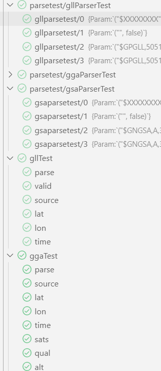

    Jan Cumps over 1 year ago
    The test script, showing testing with different sets of data at the first part. Then a set of detailed unit tests of 2 classes:
    #include <gtest/gtest.h>
    #include <string>
    import nmea;
    template <class T>
    protected:
        nmeaTest() {}
        T o;
    template <class T>
    protected:
    class gllParserTest : public nmeaParsersTest<nmea::gll> {};
        gllParserTest,
        ::testing::Values(
    class ggaParserTest : public nmeaParsersTest<nmea::gga> {};
    TEST_P(ggaParserTest, ggaparsetest) {
        ggaParserTest,
        ::testing::Values(
            std::make_tuple("$GPGGA,191237.000,5051.78066,N,00422.57079,E,1,05,3.7,027.26,M,47.3,M,,*65", true))
    class gsaParserTest : public nmeaParsersTest<nmea::gsa> {};
    TEST_P(gsaParserTest, gsaparsetest) {
        gsaParserTest,
        ::testing::Values(
            std::make_tuple("$GNGSA,A,3,15,18,,,,,,,,,,,4.7,3.7,2.9*2D", true),
            std::make_tuple("$GNGSA,A,3,73,65,81,,,,,,,,,,4.7,3.7,2.9*2E", true))
    // unit test for gll parser
    class gllTest : public nmeaTest<nmea::gll> {
    protected:
        gllTest() : parse_ok(false) {}
        void SetUp() override {
            parse_ok = o.from_data("$GPGLL,5051.83778,N,00422.55809,S,185427.150,A,N*4F", o);
        bool parse_ok;
    TEST_F(gllTest, parse) {
        EXPECT_TRUE(parse_ok) << "parse failed";
    TEST_F(gllTest, source) {
        EXPECT_TRUE(o.source == nmea::talker_id::gps);
    TEST_F(gllTest, lat) {
        EXPECT_FLOAT_EQ(o.lat, 50.8639641);
    TEST_F(gllTest, lon) {
        EXPECT_FLOAT_EQ(o.lon, 4.37596798);
    TEST_F(gllTest, time) {
        EXPECT_EQ((int)(o.t.hours().count()), 18) << "hours wrong. expected: 18. got: " << (int)(o.t.hours().count());
        EXPECT_EQ((int)(o.t.minutes().count()), 54) << "minutes wrong";
        EXPECT_EQ((int)(o.t.seconds().count()), 27) << "seconds wrong";
        EXPECT_EQ((int)(o.t.subseconds().count()), 150) << "subseconds wrong";
    TEST_F(gllTest, valid) {
        EXPECT_TRUE(o.valid);
    // unit test for gga parser
    class ggaTest : public nmeaTest<nmea::gga> {
    protected:
        ggaTest() : parse_ok(false) {}
            parse_ok = o.from_data("$GPGGA,191237.000,5051.78066,N,00422.57079,E,1,05,3.7,027.26,M,47.3,M,,*65", o);
        bool parse_ok;
    TEST_F(ggaTest, parse) {
    TEST_F(ggaTest, source) {
    TEST_F(ggaTest, lat) {
        EXPECT_FLOAT_EQ(o.lat, 50.86301);
    TEST_F(ggaTest, lon) {
        EXPECT_FLOAT_EQ(o.lon, 4.3761797);
    TEST_F(ggaTest, time) {
        EXPECT_EQ((int)(o.t.hours().count()), 19) << "hours wrong. expected: 18. got: " << (int)(o.t.hours().count());
        EXPECT_EQ((int)(o.t.minutes().count()), 12) << "minutes wrong";
        EXPECT_EQ((int)(o.t.seconds().count()), 37) << "seconds wrong";
        EXPECT_EQ((int)(o.t.subseconds().count()), 0) << "subseconds wrong";
    TEST_F(ggaTest, sats) {
        EXPECT_EQ(o.sats, 5);
    TEST_F(ggaTest, qual) {
        EXPECT_EQ(o.qual, nmea::quality::q1);
    TEST_F(ggaTest, alt) {
        EXPECT_FLOAT_EQ(o.alt, 27.2600002);
    TEST_F(ggaTest, geosep) {
        EXPECT_FLOAT_EQ(o.geosep, 47.2999992);

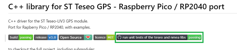

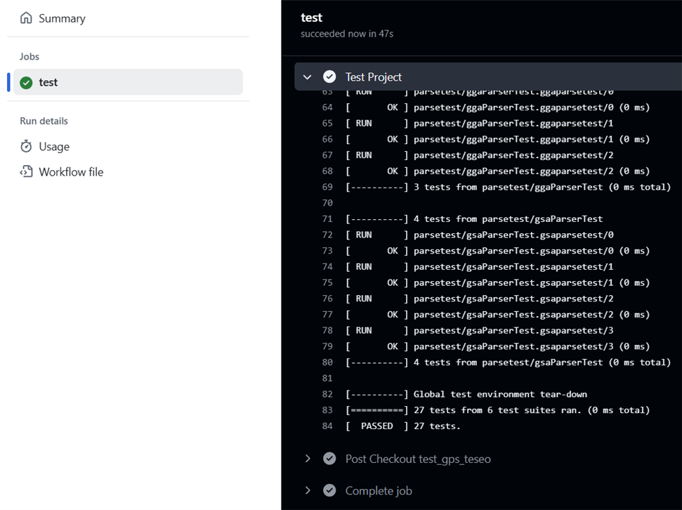

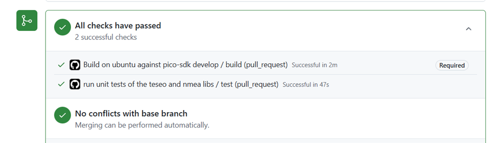

    integrate the unit test execution as an action after pull requests creation in github:
    Showing the test result in the pull request, as info for the approver. You can also make success a requirement
    outcome can be shown as a badge:

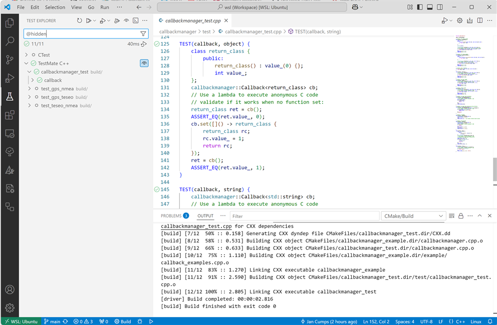

    When you use the TestMate extension in VSCode, there is an option "run continuous tests"
    When you enable that, the plug-in will execute the unit tests, each time a "binary covered by tests" is modified. Usually when you build.
    Below, you see that the callbackmanager_test has run. This happened after I built the project. The blue "eye" icon visible in the left area, switches this auto-execute on or off.
    If a test fails, you 'd get a badge with the count of failed tests in the left toolbar. So you don't have to keep this view active. It 'll draw attention when something failed:
    Also note the handy pointer that highlights the line(s) of code where validation(s) failed.
