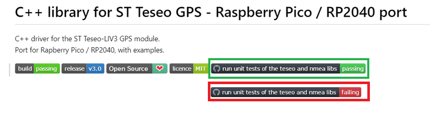

This week I'm going to learn GoogleTest for c++. Goals for day 5: use the tests in a GitHub project that depends on the GPS libraries that I created the unit tests for.
In the previous 4 posts, I created unit tests for two GPS libraries: A NMEA GPS payload parser, and a driver lib for the Teseo GPS IC. In this post, I will run those unit tests in a Raspberry Pico project that relies on these libs: https://github.com/jancumps/pico_gps_teseo.

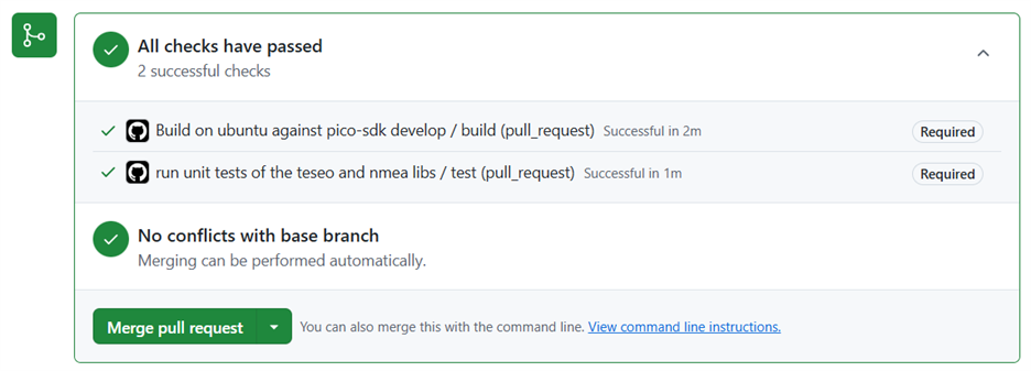

Goal: each time you create a pull request for that project's development or main branch, an action will run. That action will check out the google unit tests, and the sources of the Pico GPS project. It will then run the test cases over that project's version of the libraries. Only if that succeeds, you can approve the pull request and merge the code.
The GitHub Action
Here is the GitHub action script. It 'll
  • first commission a fresh Ubuntu Linux session
  • then install dependencies (such as the required gcc toolchain and CMake versions),
  • then check out both unit test sources (main branch) and the code of the project (version that's contained in the pull request).
  • Next step is to build the test suite, based on those two sources
  • and finally execute all unit tests.

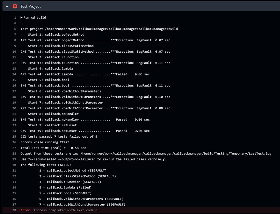

      - name: Test Project
        working-directory: ${{github.workspace}}/test_gps_teseo
        shell: bash
        run: |
          cd build
          chmod +x ./test_class_module
          ./test_class_module
          cd ..
If the unit tests fail, the action run will fail too.
Test execution
If you have rights to view action logs of the GitHub repository, you can see the log of all activities. Here's part of the test job:

The Badge
GitHub can create a badge for actions. They can be placed on a website, in the readme, or other places that accept markdown.
Here's an example where the badge appears on DoxyGen generated documentation pages.
Why?
Automatically run unit tests on pull requests to protected branches, allows that:
  • developers can check-in their code as often as they want. even if it's broken
  • they can run the unit tests on their code if they want to. Either from GitHub or from a VSCode plugin
  • they can only successfully complete a pull request of their changes to the protected branches if the unit tests succeed. Failed test blocks pull requests and notifies repository followers.
  • the project can publish latest pull request status using badges.

    Today I learned that the combination of unit testing and GitHub actions can reveal defects. I was making test scenarios for an object oriented callback manager ( C++ callbacks and templates ). The tests…
    I was making test scenarios for an object oriented callback manager ( C++ callbacks and templates ). The tests succeed on my Windows install with gcc 14.
    When I run it on an ubuntu test runner, I see that it throws memory segmentation faults:
    A good opportunity (and tools setup) to validate my callback manager design ...

    Jan Cumps over 1 year ago in reply to Jan Cumps
    I installed a fresh linux on a laptop here, with the same toolchain. I found out that my callbackmanager works when compiled with debug config, but not with release config.
    cmake .. -G "Ninja" -DCMAKE_TOOLCHAIN_FILE=/home/jancumps/develop/cmake/toolchain-gcc-14.0.2.txt -DCMAKE_EXPORT_COMPILE_COMMANDS:BOOL=TRUE -DCMAKE_BUILD_TYPE=Release
    cmake --build .
    ./callbackmanager
    Segmentation fault
    cmake .. -G "Ninja" -DCMAKE_TOOLCHAIN_FILE=/home/jancumps/develop/cmake/toolchain-gcc-14.0.2.txt -DCMAKE_EXPORT_COMPILE_COMMANDS:BOOL=TRUE -DCMAKE_BUILD_TYPE=Debug
    cmake --build .
    ./callbackmanager
    Value: 9
    Value: 9
    Value: 9
    Value: 9
    Value: false
    void gets num1: 4, num2: 5
    void with no parameters
    hello, world!
    hello, world!
    I'm going to check what construct I'm using, that's causing this. I suspect that the linker optimises out the callbacks, because they are indirectly called.
    Narrowed down to COMPILE optimization level.
    Code works from -O0 to -02. Fails at -03
    Here is how I can set the optimisation level in CMake. Now I need a way to find how I can only do that for Release compilation:
    target_compile_options(${CMAKE_PROJECT_NAME}_example
            PUBLIC "-O2"
    Once I have that working, I'll check how I can prevent -O3 from culling the callbacks ...
    I found a way to solve that the compiler optimizes out callback functions when optimization is on:
    Put this compiler directive in front of the function that sets the callbacks:
    __attribute__((optimize(0)))
    example:
    void setCallbacks() {
        gps.writer().set([](const std::string& s) -> void { write(s); });
        gps.reader().set([](std::string& s) -> void { read(s); });
        gps.resetter().set([]() -> void { port_pico::reset(); });
    int main() {
        initialize();
        setCallbacks();
    This takes care that the code makes it to the object file, and to the executable in the end.
    I'm not too happy with this. I believe I have something wrong in the definition of my Callbackmanager code, or in the template definitions. If I don't use templates, but a fixed function definition, that function isn't optimized out by the compiler.
    I got this fully solved. I changed my callback manager to a have data member that holds the std::function. In the original design it was a pointer to a std::function.
    For code that uses the manager, nothing changes. C++ encapsulation saved the day :). Retrieve the new version, rebuild, fixed.
