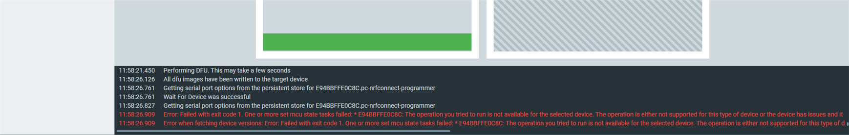

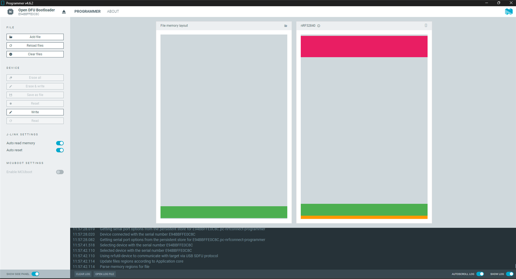

Good day,
I am trying to upload the OT firmare on my nRF52840 usb dongle, but unsuccessful. I am not sure why. FYI, i am using the nRF Connect Programmer to program the dongle. Below is the error that i am getting.
image  image
And after i try to write the firmware, this is the error that i am getting
Below is the log file

2025-10-30T03:24:01.863Z INFO Selecting device with the serial number E94BBFFE0C8C
2025-10-30T03:24:01.873Z DEBUG Sending event "programmer: running nrfutil device"
2025-10-30T03:24:02.483Z INFO Selected device with the serial number E94BBFFE0C8C
2025-10-30T03:24:02.483Z INFO Using nrfutil-device to communicate with target via USB SDFU protocol
2025-10-30T03:24:02.487Z DEBUG Sending event "programmer: device selected"
2025-10-30T03:24:02.487Z DEBUG Sending event "programmer: running nrfutil device"
2025-10-30T03:24:32.555Z INFO Parsing HEX file: C:\Users\meera.hussien\Downloads\ot-rcp-USB.hex
2025-10-30T03:24:32.563Z INFO File was last modified at 10/30/2025, 11:22:39 AM
2025-10-30T03:24:32.586Z INFO Update files regions according to Application core
2025-10-30T03:24:32.586Z INFO Parse memory regions for file
2025-10-30T03:24:50.491Z INFO Does not need to be reloaded: C:\Users\meera.hussien\Downloads\ot-rcp-USB.hex
2025-10-30T03:24:50.495Z INFO Hash is generated by SHA256
2025-10-30T03:24:50.499Z INFO Performing DFU. This may take a few seconds
2025-10-30T03:24:50.513Z DEBUG Sending event "programmer: running nrfutil device"
2025-10-30T03:24:54.792Z INFO All dfu images have been written to the target device

2025-10-30T03:24:55.587Z ERROR Error: Failed with exit code 1.
One or more set mcu state tasks failed:
* E94BBFFE0C8C: The operation you tried to run is not available for the selected device.
The operation is either not supported for this type of device or the device has issues and it cannot be recognized (NotFound)
Message: Failed to set mcu state on E94BBFFE0C8C, The operation you tried to run is not available for the selected device.
The operation is either not supported for this type of device or the device has issues and it cannot be recognized.
2025-10-30T03:24:55.587Z ERROR Error when fetching device versions: Error: Failed with exit code 1.

2025-10-30T03:36:15.880Z INFO Performing DFU. This may take a few seconds
2025-10-30T03:36:15.889Z DEBUG Sending event "programmer: running nrfutil device"
2025-10-30T03:36:20.503Z INFO All dfu images have been written to the target device
2025-10-30T03:36:21.142Z INFO Getting serial port options from the persistent store for E94BBFFE0C8C.pc-nrfconnect-programmer
2025-10-30T03:36:21.143Z INFO Wait For Device was successful
2025-10-30T03:36:21.143Z DEBUG Sending event "programmer: device connected"
2025-10-30T03:36:21.147Z DEBUG Sending event "programmer: running nrfutil device"
2025-10-30T03:36:21.211Z INFO Getting serial port options from the persistent store for E94BBFFE0C8C.pc-nrfconnect-programmer
2025-10-30T03:36:21.212Z DEBUG Sending event "programmer: device connected"
2025-10-30T03:36:21.287Z ERROR Error: Failed with exit code 1.
2025-10-30T03:36:21.287Z ERROR Error when fetching device versions: Error: Failed with exit code 1.

2025-10-30T03:39:59.003Z INFO Selecting device with the serial number E94BBFFE0C8C
2025-10-30T03:39:59.011Z DEBUG Sending event "programmer: running nrfutil device"
2025-10-30T03:39:59.583Z INFO Selected device with the serial number E94BBFFE0C8C
2025-10-30T03:39:59.584Z INFO Using nrfutil-device to communicate with target via USB SDFU protocol
2025-10-30T03:39:59.586Z DEBUG Sending event "programmer: device selected"
2025-10-30T03:39:59.586Z DEBUG Sending event "programmer: running nrfutil device"
2025-10-30T03:39:59.588Z INFO Update files regions according to Application core
2025-10-30T03:39:59.588Z INFO Parse memory regions for file
2025-10-30T03:40:12.687Z INFO Device connected with the serial number E94BBFFE0C8C
2025-10-30T03:40:12.691Z INFO Update files regions according to Application core
2025-10-30T03:40:12.691Z INFO Parse memory regions for file
2025-10-30T03:40:13.409Z INFO Getting serial port options from the persistent store for E94BBFFE0C8C.pc-nrfconnect-programmer
2025-10-30T03:40:13.409Z INFO Device connected with the serial number E94BBFFE0C8C
2025-10-30T03:40:13.410Z DEBUG Sending event "programmer: device connected"
2025-10-30T03:40:13.465Z INFO Getting serial port options from the persistent store for E94BBFFE0C8C.pc-nrfconnect-programmer
2025-10-30T03:40:13.465Z DEBUG Sending event "programmer: device connected"
2025-10-30T03:40:27.466Z INFO Selecting device with the serial number E94BBFFE0C8C
2025-10-30T03:40:27.475Z DEBUG Sending event "programmer: running nrfutil device"
2025-10-30T03:40:28.037Z INFO Selected device with the serial number E94BBFFE0C8C
2025-10-30T03:40:28.038Z INFO Using nrfutil-device to communicate with target via USB SDFU protocol
2025-10-30T03:40:28.040Z DEBUG Sending event "programmer: device selected"
2025-10-30T03:40:28.040Z DEBUG Sending event "programmer: running nrfutil device"
2025-10-30T03:40:28.041Z INFO Update files regions according to Application core
2025-10-30T03:40:28.041Z INFO Parse memory regions for file

2025-10-30T03:57:28.019Z INFO Getting serial port options from the persistent store for E94BBFFE0C8C.pc-nrfconnect-programmer
2025-10-30T03:57:28.020Z INFO Device connected with the serial number E94BBFFE0C8C
2025-10-30T03:57:28.020Z DEBUG Sending event "programmer: device connected"
2025-10-30T03:57:28.082Z INFO Getting serial port options from the persistent store for E94BBFFE0C8C.pc-nrfconnect-programmer
2025-10-30T03:57:28.082Z DEBUG Sending event "programmer: device connected"
2025-10-30T03:57:41.518Z INFO Selecting device with the serial number E94BBFFE0C8C
2025-10-30T03:57:41.526Z DEBUG Sending event "programmer: running nrfutil device"
2025-10-30T03:57:42.110Z INFO Selected device with the serial number E94BBFFE0C8C
2025-10-30T03:57:42.110Z INFO Using nrfutil-device to communicate with target via USB SDFU protocol
2025-10-30T03:57:42.113Z DEBUG Sending event "programmer: device selected"
2025-10-30T03:57:42.113Z DEBUG Sending event "programmer: running nrfutil device"
2025-10-30T03:57:42.114Z INFO Update files regions according to Application core
2025-10-30T03:57:42.114Z INFO Parse memory regions for file
2025-10-30T03:58:21.447Z INFO Does not need to be reloaded: C:\Users\meera.hussien\Downloads\ot-rcp-USB.hex
2025-10-30T03:58:21.448Z INFO Hash is generated by SHA256
2025-10-30T03:58:21.450Z INFO Performing DFU. This may take a few seconds
2025-10-30T03:58:21.461Z DEBUG Sending event "programmer: running nrfutil device"
2025-10-30T03:58:26.126Z INFO All dfu images have been written to the target device
2025-10-30T03:58:26.761Z INFO Getting serial port options from the persistent store for E94BBFFE0C8C.pc-nrfconnect-programmer
2025-10-30T03:58:26.761Z INFO Wait For Device was successful
2025-10-30T03:58:26.762Z DEBUG Sending event "programmer: device connected"
2025-10-30T03:58:26.766Z DEBUG Sending event "programmer: running nrfutil device"
2025-10-30T03:58:26.827Z INFO Getting serial port options from the persistent store for E94BBFFE0C8C.pc-nrfconnect-programmer
2025-10-30T03:58:26.828Z DEBUG Sending event "programmer: device connected"
2025-10-30T03:58:26.909Z ERROR Error: Failed with exit code 1.
2025-10-30T03:58:26.909Z ERROR Error when fetching device versions: Error: Failed with exit code 1.
Appreciate the help on this matter.

    It's been a good while since I last flashed a dongle. Two things spring to mind.
    1. There's 2 versions of nRFconnect - 3.7 and 4.6. It might be a version issue. Can't remember it's been that long ago.
    2. Looking at the screenshot you uploaded. The rectangle on the right is what nRFconnect is seeing when reading your device memory. The rectangle on the left is an illustration of what your hex file looks like. As such, you may have to reconfigure the memory regions when creating the hex file as it looks like you are trying to overwrite the orange/yellow section, which might be write restricted.
  • BigG
    0 BigG over 1 year ago in reply to meera_hussien
