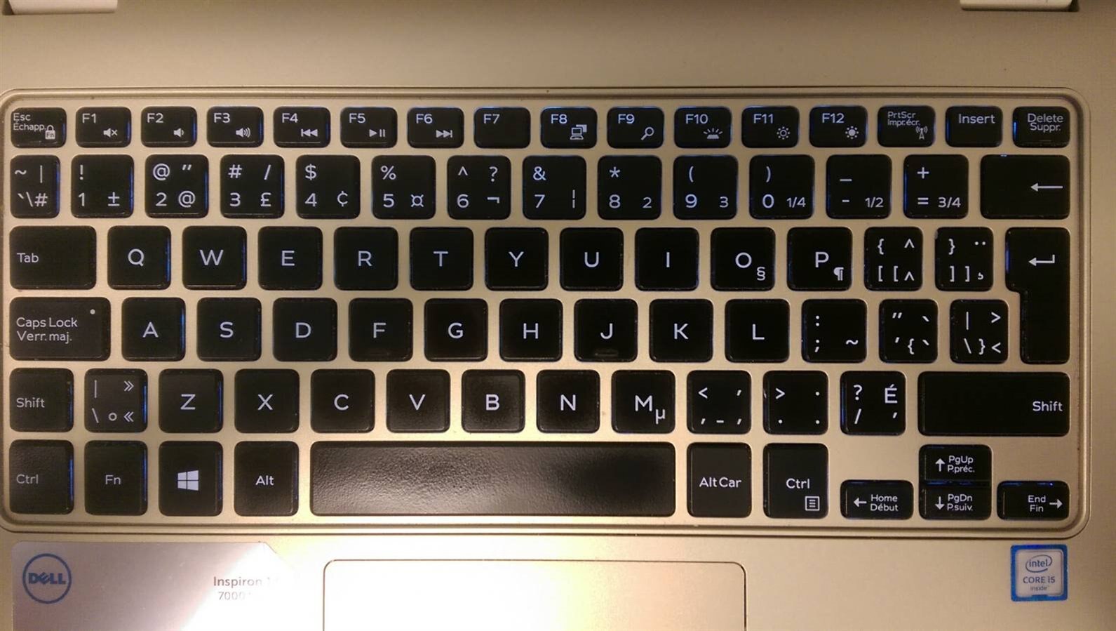

I've been having some issues with a Dell 7359 keyboard and have some assumptions I'd like to check with people who know more about electronics than me. My issue is that that some of my keyboard keys on right side of keyboard are not working. These include the right key, down key, delete key, right square bracket ], and I believe the insert key. Here is a picture of my keyboard.
A couple really interesting things I've noticed: A couple keys will work sporadically. These include the down key, and the right bracket.
Even more interesting: at one point the square bracket key ] wouldn't work, but if I hold shift, this key works, meaning that I can make the } key work easily but not the ] key.
My question: Can anyone give me a quick understanding of why a base key might not work but it's SHIFT+key combination might work? Does the shift key route the key press signal to a completely different location on the circuit board? Like some sort of analog multiplexing?

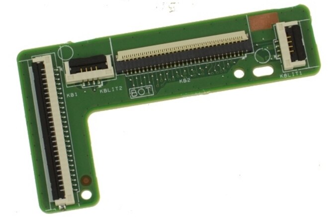

I am really wondering if my physical keyboard is perhaps in working order, but the so called "keyboard daughter board" and associated cables may have some damage or loose connections. Here is a picture of a Dell Daughter Board. From what I can see in videos, the two small connectors power the keyboard backlights. One big connector goes to the physical keyboard, the other goes to the motherboard.

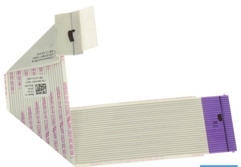

Another Question: Does anyone have any intuition with these problems and a recommendation? If you have any guides on how to troubleshoot connections in these connectors and cables, I would be very grateful. I am thinking of doing continuity checks of the keyboard hardware, ribbon cables, and this keyboard daughter board to try and isolate the problem. Below is a picture of a Dell ribbon cable I may buy to try and fix issues. Although I barely now how to get confident readings out of the cable. I guess maybe I should try it first when it's docked into the connector to make things easier?

    jdlui
    Is this a Windows OS loaded laptop, if yes, then try booting into "safe mode" and go to the command line. test those keys in particular that according to you, are giving you problems.
    If they still do, then it is probably a Hardware issue,  else it could be an installation configuration issue with corrupt windows drivers for some reason or the other.
    You could also try downloading a bootable Linux flash Live CD image and boot with it into a total different environment just to see if it is a software and not hardware related issue.
    If the keys still does not work in a different environment then it definitely is a Hardware related issue.
    Please try this and let me know.....

    jdlui over 9 years ago in reply to volly
    volly
    Thanks for the quick reply!
    It should definitely be a hardware issue because I have tested keyboard in a Linux Live boot and installed Ubuntu as a dual boot. The same keys are not working in these situations.
