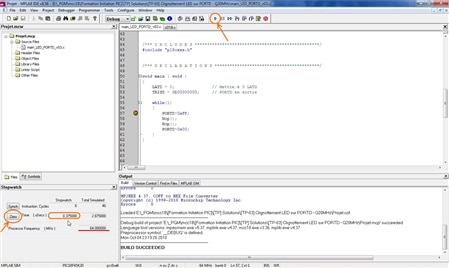

    Question, if the PIC has been set to 64Mhz and then you put this in main:
    while(1)
    PORTD=0xFF;
    Nop();
    Nop();
    PORTD=0x00;
    what is the port d frequency?, I am getting just under 4Mhz?

    e14 Contributor over 16 years ago in reply to JohnDSiviter
    Hi,
    If the PIC has been set to 64Mhz then the PORTD frequency is about 2,6MHz (1/ (375 ns x 6 instruction)) or 1/(62,5e-9*6)= 2,6MHz
    Do you no that PIC18F25K20 do not have PORTD ?
    Arnauld

    Hi sorry posted out of context I know these are similar to the one I am using PIC18F45K20-I/MLPIC18F45K20-I/ML, did you get the 375ns from the datasheet?, ok I can see 6 instructions in total, 4 within the While loop and 2 hidden (thats why I had to include 2 Nop()'s in the on time due to the 2 instruction delays caused by the loop back to the start of the while loop).
    A simple example simulation : choose the correct value of the clock frequency in Debugger Settings > Osc/Trace
