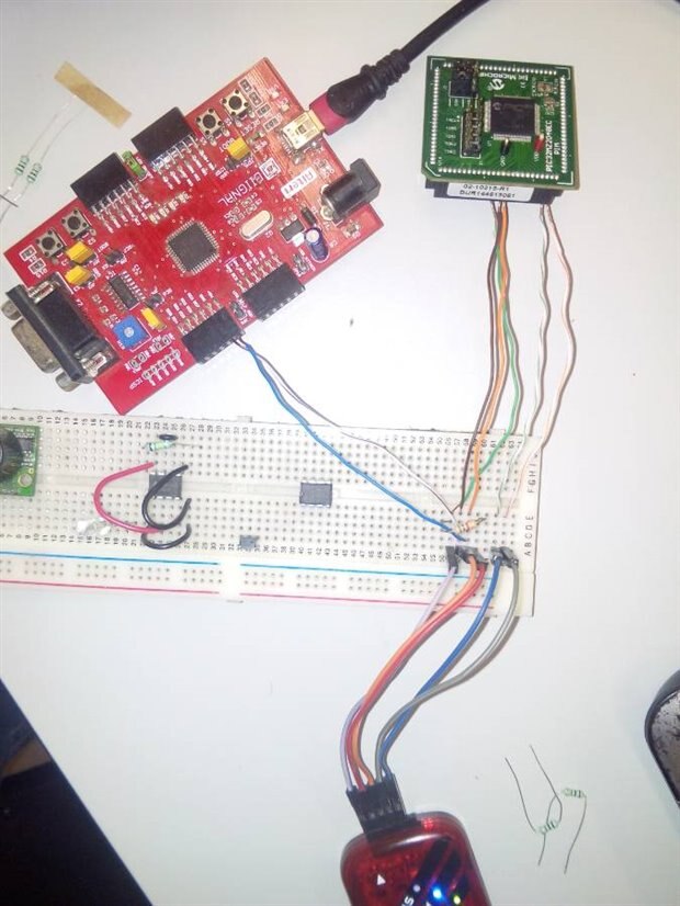

Hello!
I've been using up to PIC18, but I'm new using PIC32. I thought that it would be the same process, but I'm having a hard time making it work.
I'm developing a board for my graduation proyect with this PIC32MZ2048ECH100
PIC32MZ EC Processor Plug-In Module (PIM) - MA320012 | Microchip Technology Inc.
The thing is that I can't seem to make it work with the programmer.
I'm Using the PICKIT3
Application Version: 3.10
Device File Version: 1.62.15
OS Frimwater Version: 2.00.05
When I try to manually select the PIC32MZ only PIC32MX family appears.
Do I need to download or update something else?
I have to implement an external circuit?
Are my connections correct?

    Brandon,
    Looking at your picture, it does not appear that you have the board powered up, while you are attempting the programming.  I believe that it is necessary to power up the board/chip first, then attempt programming.

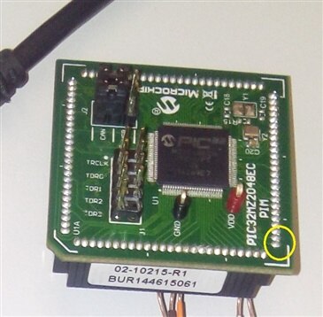

    Hi Brandon,
    I'm not familiar with that module or the PIC32 but I pulled up the datasheet and I think you may have the wrong pins connected?
    He's my thinking:
    Pin 1, taken when looking at the PIC component side, is the first anti-clockwise from the notched corner.
    The Pickit3 uses the following pins:
    1     MCLR (pull to Vdd with 4k7)
    2     Vdd
    3     Vss
    4     ICSPDAT
    5     ICSPCLK
    6     PGM (often not connected)
    I think from your photos you have:
    White/Orange          Pin_1               to ICSPDAT
    White/Green            Pin_2               to ICSPCLK
    Orange                    Pin_10             to VDD
    Brown                      Pin_11             to Vss
    Green                      Pin_13             to MCLR
    You need something like:
    White/Orange          Pin_25 or Pin_27               to ICSPDAT
    White/Green            Pin_24 or Pin_26               to ICSPCLK
    Orange                    Pin_14                               to VDD
    Brown                      Pin_13                               to Vss
    Green                      Pin_15                               to MCLR
    Please don't just copy the above without thinking it through - it's just my initial thought image. I'm also not sure why there are two ICSP ports nor how you select between them. I would also double-post your question into the Microchip Forum as, with no disrespect to Element14, they probably have a larger user base .
    Rod

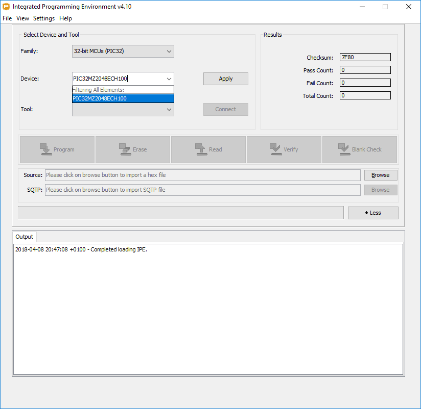

    What program are you using to download the HEX to the PIC? The PIC32MZ2048ECH100 shows up under Microchip's MPLAB IPE (v4.10) software (which gets installed when you install MPLAB X IDE) - you can download your HEX file with PICKIT3 from that.
    regards,
    Rod

    I managed to Update the firmware!
    Thats a Start
    1.- Go to PICKIT3 v3.10
    2.- Tools > MPLAB MODE
    It will quit the app and I'll be almost ready to use.
    3.- Select the Device, tool, and press connect.
    This will make it update the PICKIT3 so that it can program the selected device.
    At first it took about 4hours in the downloading section.
    Had to restart the MPLAB IPE to make it work.
    Now I'm stuck here

    0 brv64 over 8 years ago in reply to 14rhb
    I thought that too!
    On the PIM diagram it's more like
    PIN_25     PGEC
    PIN_24     PGED
    PIN_16     VCC
    PIN_15     GND
    PIN_13     MCLR
    I used a 56K resistor (I had it around) to use it as a pull up but no luck. I'll get a 4K7.

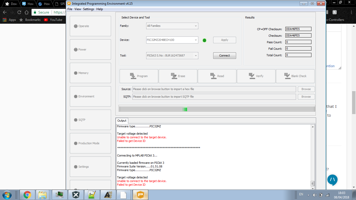

  • brv64
    This is what i got now.
    I keep switching ICSPD and ISCPC but no luck
    D:
    I tried the pull-Up with 5 resistors in series that gave a total 4560 Ohms and no luck
    :c
    I get this from the MPLAB IPE
    Connecting to MPLAB PICkit 3...
    Currently loaded firmware on PICkit 3
    Firmware Suite Version.....01.51.08
    Firmware type..............PIC32MZ
    Target voltage detected
    Unable to connect to the target device.
    Failed to get Device ID
