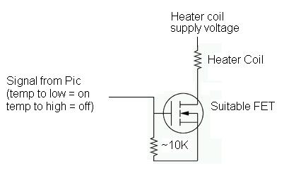

I am designing a heating control system using a PIC, using a number of thermistors and coils of nicrome wire to heat up various parts of a machine. I am looking for a method to switch on the nicrome wire coils - I understand that this could be done with a transistor but am unsure of exactly how and what components to use?

    Without more details on the coil and how it is to be powered, it's difficult to give you a complete answer, but assuming that you are using a relatively low voltage dc power supply for the coils, then a suitable N-type MOSFET arranged as below should do the trick.
    What is the resistance of the coils?
    What is the supply voltage?
    What is the max current drawn?
    Answering the above will help you choose an appropriate FET.

    The resistance of the nichrome wire is 4.68 ohms, and will be powered with a 5V supply, using a 5V rail from a computer PSU. The PIC will also be powered with the same 5V rail. I think that the max current that the supply can provide at 5V is 30A (the supply is Akasa AK-P460FG).
    It is likely that other heating coils will be implemented at a later stage, so if you could let me know how the necessary calculations should be carried out for a given resistance, that would be very useful indeed.

    Well it should just be ohms law
    Volts = Current * Resistance
    If it's a 5 volt supply and an approx 5 ohm load then it will draw approx 1 Amp.
    Power = Volts x Current ~ 5 * 1 in this case, so 5 Watts.
    So a FET that can handle 5W @ =>5V (ideally a bit more) and turn on at Vgs 5V or less should be fine.

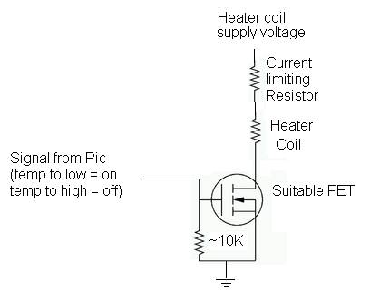

    One thing I am wondering though is if the resistance of the heater wire will drop as it gets hot, I suspect it will, so you may need to introduce a resistor in series with it to limit the current, but you will need to experiment abit to see how this goes.

    Surely the resistance will increase with temperature, making the circuit somewhat self-regulating.
    As temperature increases, current will decrease, resulting in less electrical energy being converted to heat.

    Yes your right, clearly wasn't concentrating there.
