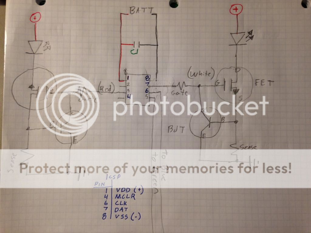

Hey guys first off not only am I new here I'm also new to PIC (coming over from AVR), I hope I've included all info you guys may need to help me but let me know any other info you need.
I have several different uses for 12F617's (digikey is shipping 6171's) and in all the previous boards the chips can be programmed ISP but for this newest project I have only been able to program off the board (not a big issue at all) however also with this new project I'm getting an error trying to verify. I've went back to multiple other projects and have tried this very chip (actually tried several chips) and they all work fine so I think it must be code related however I sent my buddy the code and he assembled it and emailed the hex back and that flashes (in a new project) and it verifies just fine, what the heck!?
I've been searching for a couple days while I remembered my login here and waited on my verification email and the closest thing I have found was this thread at microchip's forum (I'm not aboe to post a thread there, some crazy forum issue that lots of people are having) but its not the same issue and there wasnt much to use, it did lead me to check my config bit's and I made sure code protection was off but now I'm lost. Just to be clear the device is running, its just having a seemingly random issue where it gets stuck I believe to be a memory issue related to this.
MPLAB IDE v8.92
windows vista business x32 (running on a dell laptop from 2008)
picKIT3, making the connection with an SOIC clip with leads from the pickit <6", again programming with the chip free in the air...

This is a controller for a 4 channel RGBW LED driver and sometimes (quite often) the light will get stuck in one particular loop or even more specifically at one random output level, the program has memory threw power cycles so it will be stuck there till I erase the chip and reflash (it has wear leveling so I'm thinking it runs fine when it writes to different bit's but when it writes to that one spot it locks up). Other than those random times when that happens the device runs as programmed, thats why I think the issues are one in the same. As I mention I've tried several different chips and all of them run perfectly in other similar devices (but with totally different code), its ONLY this project they do this issue.
I dont know what more info you guys might need, I can post the instructions file I'm using if you need that, just let me know.

    Hi,
    Can you post your electronic circuitry ?
    Do you have a 10K pull-up resistor on MCLR ?
    Do you have a dedicated power supply or do you supply your board through Pickit3Vdd

    1) yes, see images ( I can post gerber's too if that will help)
    2) no, is that for programming or while running (or both)?
    3) it runs off 1 4.2v 18650*
    *When I hook the clip to the chip with it on the board and the driver all wired up (but NOT powered from the cell) connecting the clip will power up some of the emitters and that gives me a short of VDD or MCLR warning and doesnt even try to connect anymore but I have verified there are no shorts anywhere (except i guess the ones when the FET is on by the nature of how this circuit works)
    12F617
    gate resistors = 470ohm  (I've tried a huge range)
    RSET = .22ohm
    BJT = 2DD2656DICT
    FET = AO3400A
    LED's are CREE XP-E2's for the RGB and an XP-L for white,
    edit: the LED-'s are coming from the top's of the FET's going to the right, batt+ comes in from just above C1 left of the uC. sorry the pic's arnt bigger, if you cant make them out let me know and I'll see what I can do.

    Hi,
    Sorry but your schematic is unreadable...Could you post a black on white background version  (PDF)
    Regards

    Hello thank you sir, I'm sorry but I dont know how to make PDF's, hopefully this will help, I would gladly email you my .sch and .brd files if you use eagle, all the hardware if open source stuff so you can view the renders on oshpark
    (link to pic for larger)
    the blue and green channels are exactly the same, if this doesnt help I'll have to see about making a PDF but I definitely dont have any app for that on this old girl. Note that a resistor get's stacked on the C1 cap (2.2uf & 150kohm), thats how the light reset's back to the memorized mode (if cap is drained that means the light has been off a while and it should reset back to memorized level, if not drained that means the light hasnt been off very long and it should advance to next mode)

    Hi,
    Can you please add the ICSP connector ? I don't see it on your schematic.
    With PICs, it is compulsory to connect all the 5 signals : Vdd, Vss, MCLR, PGC, PGD (look at the nice poster you got with Pickit3)
    As far as I can see the MCLR pin (reset) is floating...Please make sur to attach a 10K pull-up resistor to this pin. MCLR is an essential signal for the PIC as well as the programming as Vpp voltage (13V) is applied on that pin
    With Pickit3 you must select power target or not depending if your circuit is powered or not. I recommend alsways to use the board power supply because some issues are due to power supply and it is better to see them early in the development.

    sure, sorry On the board both pin 2 (GP5) and pin4 (MCLR) are floating, I will add a 10k pull up ASAP
    I got my pK3 off the bay sans poster, is that info somewhere on microchip's site?
    Since I'm programming the chip off the board I have to power it from the PK3...

    Hi,
    You can find all the Pickit3 documentation here : http://www.microchip.com/pickit3
    The poster is here .
    Regarding GP5, a pull-up is not necessary. Just program this pin as output and put a logic 0
    BTW : PIC12F617 is a very old device. There are much more powerful 8 pins PIC12/PIC16 which have lots of PWM and are particularily suited for led driving
    e.g PIC12F1572
