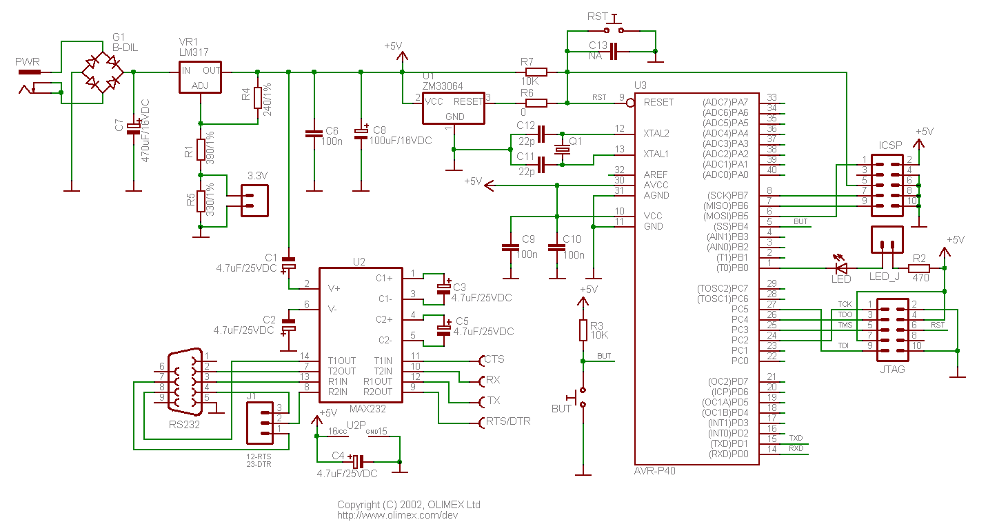

AVR-P40-8535 is a simple board which uses the MCU AT90S8535 from Atmel. With its button, and variety of interfaces such as RS232 (in two variants – 4 pins and DB9), JTAG, ISCP, etc. this board is suitable for different embedded systems applications.
Key Features
  • STK200 compatible ICSP 5x2 pin connector for in-circuit programming with AVR-PG1 or AVR-PG2
  • JTAG 5x2 pin connector for in-circuit programming and debugging with AVR-JTAG-USB and AVR-JTAG-L
  • RS232 Tx, Rx interface with MAX232 IC on socket
  • 8 MHz crystal on socket (user can replace with any value)
  • Reset IC ZM33064
  • Reset button
  • General purpose push button
  • Status LED connected to PB0 via removable jumper
  • DIL40 microcontroller socket
  • Power plug-in jack
  • Selectable +3.3V / +5V power supply voltage regulator
  • Extension pin headers for each uC pin
  • Four mounting holes 3.3 mm (0.13")
  • GND bus
  • Vcc bus
  • FR-4, 1.5 mm (0,062"), green soldermask, white silkscreen component print
  • Dimensions 100x80 mm (3.9x3.15")
