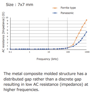

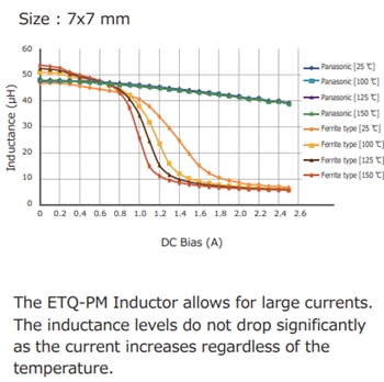

Metal Composite (MC) Core Technology: Panasonic’s Fe-based MC cores use uniformly insulated iron particles to create a distributed air-gap structure, delivering controlled permeability, reduced flux concentration, and superior saturation performance compared to gapped ferrite cores. They deliver high saturation flux density (typically 1.5-1.6 T compared to 0.4 T for ferrites), offering higher energy storage than ferrites and enabling smaller footprints or higher current capability. Their distributed‐gap structure ensures predictable inductance with 70–85% retention under DC bias, while high-temperature materials maintain magnetic stability up to 160°C with low TCL. Optimized particle insulation and binder systems minimize hysteresis, eddy current, and residual losses, ensuring low core loss from 300 kHz to 2 MHz.
Fig 2. Frequency characteristics of AC resistance and the effect of DC bias current on induction (source: Panasonic)

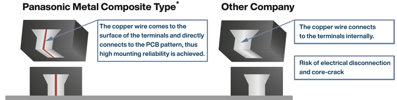

Dust Core Technology (Soft Saturation Characteristics): Panasonic’s dust-core technology delivers smooth soft-saturation, high ripple-current tolerance, and stable inductance under wide current swings—far superior to ferrite. This core provides a gradual saturation characteristic, meaning the inductance rolls off slowly as DC bias increases.  This is crucial for reliable operation in power factor correction (PFC) circuits, LED drivers, and DC-DC boost topologies where instantaneous current spikes are common. Combined with robust molded construction, hard-coat wire, caulking terminals, low-center-of-gravity design, and 50G vibration validation, PCC inductors offer exceptional durability for harsh, high-vibration power applications.
Fig 3. Panasonic vs others: Terminal coating design that prevents disconnection & core cracks (source: Panasonic)

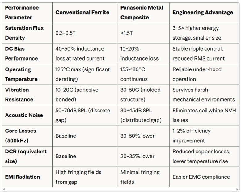

Table 1. Comparison chart: Panasonic PCC vs. Conventional Ferrite Inductors

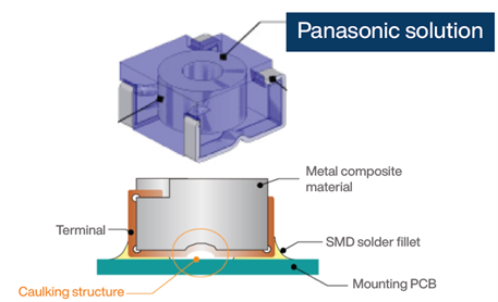

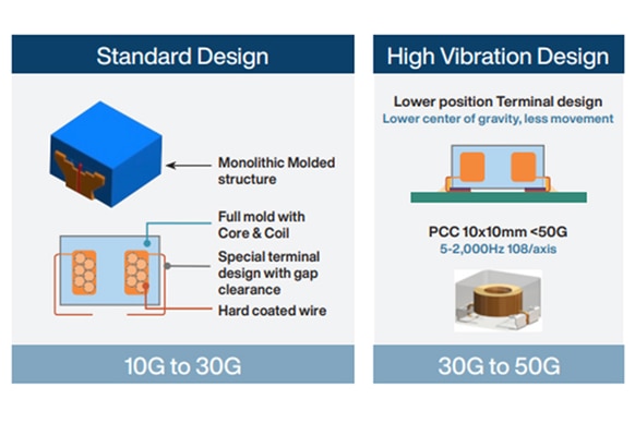

  • High vibration acceleration-resistant – MS series: The MS Series (PCC-M0854MS, PCC-M1050MS) is a robust surface-mount device (SMD) inductor engineered specifically for harsh automotive environments, featuring a metal composite core (MC) that delivers exceptional vibration tolerance of 50 G or higher, even at elevated temperatures up to 150°C. Key advantages include:
  • 50 G vibration acceleration resistance: Molded, integrated MC-core construction.
  • High heat tolerance: –40 °C to +150 °C (up to +180 °C short-duration) for under-hood reliability.
  • Excellent inductance stability: Maintains performance under high bias current and temperature rise.
  • Low audible noise: Gapless metal-composite magnetic structure.
  • Low DCR / low core loss: Ensures efficiency in high-frequency converters.
  • Shielded SMD design: Minimizes EMI in dense automotive power stages.
Its monolithic construction and terminal design, which includes a caulking structure, make it more resistant to vibrational forces than standard metal composite coils. This specialization makes it ideal for Engine Control Units (ECUs) and sensors that are mounted directly onto the engine or powertrain system.
Fig 5.  High-vibration automotive inductor design: Panasonic’s robust structure for 30g–50g performance (source: Panasonic)

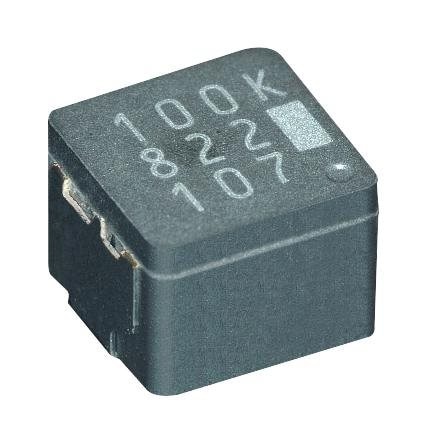

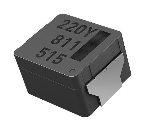

2) Large current power choke coil for automotive-MF series: The MF series (e.g., PCC-M1280MF, PCC-M150MF) is designed for applications requiring the maximum current handling capability within a compact surface-mount package. Additionally, it achieves superior inductance stability under heavy bias currents and temperature swings, as well as low eddy-current losses for enhanced efficiency. Its key features include:
  • Large current capacity: Up to 53 A (M1280MF) and 87 A (M15A0MF) without saturating.
  • High thermal endurance: Reliable continuous operation up to 160 °C (and 180 °C short-term) including self-heating.
  • Strong vibration resistance: Designed for 30 G automotive vibration, suitable for under-hood or engine-mounted ECUs.
  • Low loss and stable inductance: Ferrous-alloy core delivers stable inductance under heavy DC bias and broad temperature range, while the gapless MC structure avoids audible buzzing.
  • Surface-mountable and compact: SMD form factor enables direct mounting on space-limited automotive PCBs.
It is effective in high-power systems, such as 48V mild-hybrid systems, high-current DC/DC converters, and inverters for electric and hybrid vehicle powertrains.
Fig 6. Panasonic’s automotive-grade high-current inductors (source: Panasonic)

What makes Panasonic’s Metal Composite (MC) PCCs superior to traditional ferrite inductors?
Panasonic PCCs use Metal Composite (MC) and Dust Core technologies that deliver higher saturation flux (>1.5T vs ~0.4T for ferrite), gradual soft saturation for ripple handling, and superior thermal stability up to 180°C. Unlike ferrite inductors, PCCs maintain inductance under DC bias, reduce acoustic noise, and withstand extreme vibration (30–50G).
Which PCC series should I choose for high-vibration automotive environments?
For environments such as engine compartments, pumps, compressors, and chassis ECUs, Panasonic’s MS Series is optimized with reinforced molded structures and enhanced terminal strength. These inductors provide up to 50G vibration resistance, ensuring long-term reliability under mechanical stress.

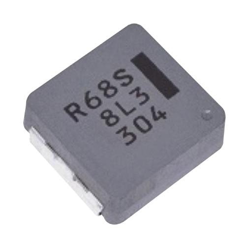

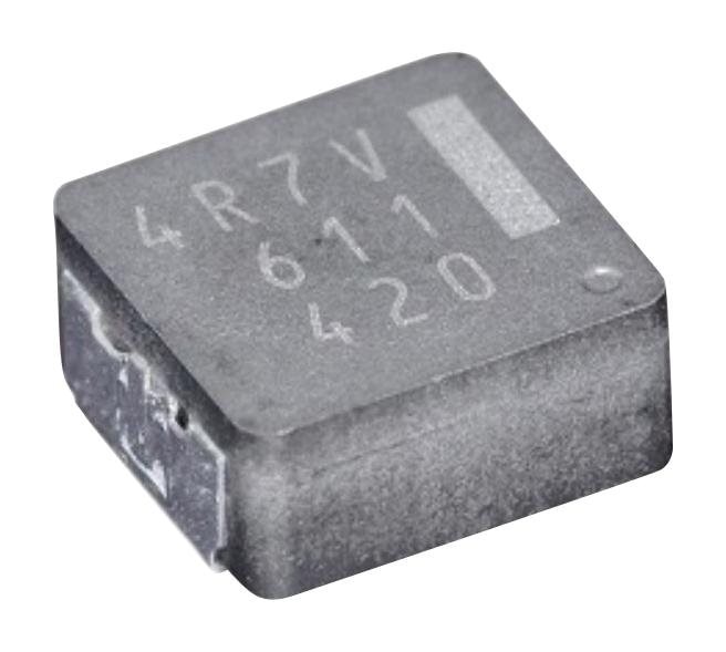

Featured Products
image image image
Large current Power Choke Coil for Automotive-MF High Vibration Acceleration-resistant Power Choke Coil for Automotive-MS Power Choke Coil for Automotive-H
image image image
Power Choke Coil for Automotive-LE Power Choke Coil for Automotive-LP Power Choke Coil for Automotive-M
