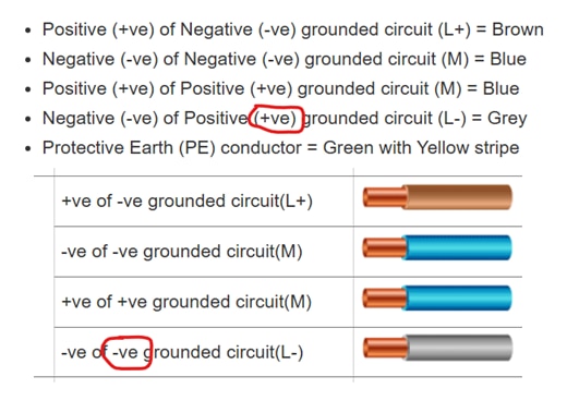

Two-Wire Grounded
  • Positive (+ve) of Negative (-ve) grounded circuit (L+) = Brown
  • Negative (-ve) of Negative (-ve) grounded circuit (M) = Blue
  • Positive (+ve) of Positive (+ve) grounded circuit (M) = Blue
  • Negative (-ve) of Positive (+ve) grounded circuit (L-) = Grey
  • Protective Earth (PE) conductor = Green with Yellow stripe

System Function UK (New Code as per IEC) UK (Old Code)
Two Wire Ungrounded Positive (L+) tan wire red wire
Negative(L-) gray wire black wire
Two Wire Grounded +ve of -ve grounded circuit(L+) tan wire red wire
-ve of -ve grounded circuit(M) blue wire white wire
+ve of +ve grounded circuit(M) blue wire white wire
-ve of -ve grounded circuit(L-) gray wire black wire

  • beacon_dave
    beacon_dave 3 months ago
    Perhaps need a continuity check here ?
