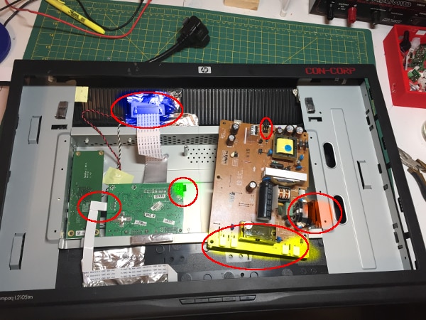

"How Would you Probe?" Challenge:
I had a mains 120V hot wire for a light fixture arc to the house ground wire.  Just a quick pop - nothing hurt but my pride.  It threw the breaker.  Perhaps coincidentally, a monitor on the same breaker circuit no longer worked.  It wasn't on at the time, but it was working before, then it was dead.
By dead, I mean when you press the power button on the front, nothing happens.  It has no lights when in the off state to let you see that there was at least power to an LED.
I pulled it all apart and did some probing.  I "spray painted" key parts in a picture below for reference.
The brown board on the right is the DC power converter and screen back light power.  It has a crapload of SMD parts on the back.
The green board in the middle is the monitor pixel data business end.  It takes input DVI or VGI and processes it out the top to the monitor.
The green board on the left is independent of the problem I believe - it is USB and amp for speakers.
Here's what I found probing:
Yellow - there are four two pin wire-to-board connectors here .  They connect to four cables on the monitor.  I suspect they are backlight connectors.  I read essentially 0 VDC on these.  AC gave 1.8V.  Is there such thing as a 1.8VAC backlight?
Red-on the very right is the cable for AC in (plug to the wall).  I probe for ohms at the fuse immediately off of it and it showed good with a closed circuit (0 ohms).  I didn't lift either leg on the fuse, though.  Its a through-hole packaged fuse.
Red Circle At Top of Brown Board - this is a 6 pin connector labeled 5V, 5V, Gnd, Gnd, O/F, BK.  Probing DC, the 5V's both showed about 5.2Vs.  The BK showed a -0.6V to ground.  I find that weird.  O/F showed no DC voltage.  This one plugs into the middle green board.  Don't know what O/F or BK mean.
Blue connector - this goes to the monitor screen.  It must be what tells it pixels info and to "turn on".
The ribbon cable on the left goes to the power and menu buttons.
At this point, I am uncertain as to which board would be the one to focus on.  However, since I have 5V's coming out of the brown board, I feel I should next be probing on the middle green board.
Thoughts?
Thanks,
Sean

    dougw over 6 years ago +3
    Stay on the power card for a bit....see if you can see why the power switch doesn't do anything... What is the power switch connected to? Does the power switch voltage change when it is pushed? Does the…

    It is super common for the caps to go bad on the power supply. Look for any of them to have slightly buldged tops.
    Does the power switch cause any other voltages to change?
    If the power switch has a reasonable voltage swing, does the device it is connected to do anything in response to that input?
    Keep tracing where power is going active but what it connects to does not respond.
    Look for components that are unusually hot.
    A close visual inspection may reveal bad solder joints, burnt components or cracked components.

    Ok...embarrassed about the timeline here and the fix:
    • 18 months ago, the monitor died
    • Within 2 hours, I started probing with little confidence as to what I was doing, but it was definitely dead.  Stored it in basement for a rainy day
    • Since, bought a book on how to fix anything electronic and got more confidence
    • Probe the power supply board and posted here - got even more confidence
    • When I reconnected the Power Supply back to the green board and hit the power button to begin probing as Doug suggested, the LED came on.  Didn't remember that.
    • Plugged back in the backlight cables, suddenly had a white screen.
    • Plugged the monitor ribbon cable back in and hooked it to a computer, looked like nothing ever was wrong with it to begin with.
    So, it works!  I believe that fuse might have some sort of thermal switch.  It didn't reset within the two hours of my initial check, but after 18 months, it finally cooled down and reset.  image
    The moral of the story is, never throw out anything.  You'll be able to fix it someday.  You'll just have to get some HDMI to DVI adapters so your new cords will work with it.
    Sounds very possible, although they are meant to reset within seconds I believe their resistance and reset time increases as they are successively activated e.g. like most things they get worn out even though not mechanical in nature. Your fault could have given it a very large jolt !
