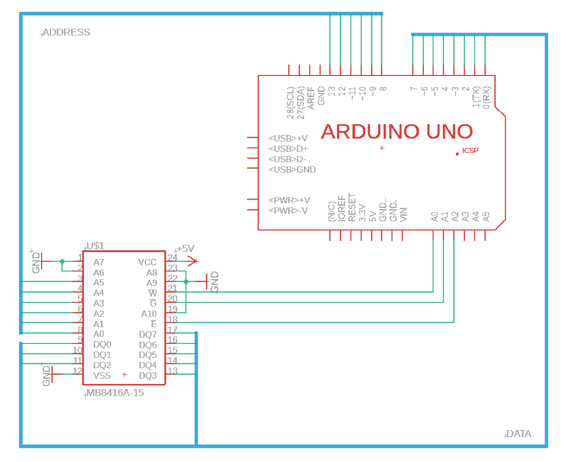

I'm trying to interact with SRAM (MB8416A-15) with my Arduino.
This is my schematic:
And my code:image

I'd expect an output of
10
10
20
10
20
30
10
20
30
40
but I get
10
20
20
30
30
30
40
40
40
40

    From the output that you get it appears that your address isn't working so that you are always writing and reading the same address. You should probably just do a static check to see if you are actually…

    There are three issues I see with your circuit and code:
    1) The input data is in the PIND register, you're just reading back what you wrote to the PORTD output register (this is why your last output is repeating).
    2) When you set the pins to be inputs the data register (PORTD) will be controlling the internal pull-up resistors (I didn't find a good Arduino page on this, but the behavior is described in the Atmega328p datasheet), so you have to write all zeros to PORTD before reading PIND.
    3) You're using PORTD for the databus while also using the serial ports (for monitoring your program), which is using two of the pins for RX and TX. You can't have both at the same time. When the serial port is enabled those two pins are no longer connected to the PORTD register.
    I'd suggest that you write a nibble (4-bits) to the SRAM and see if that works first, you can safely use the upper half of PORTD. You can also write to the SRAM in slow motion as ralphjy is suggesting. I'd probably go further and hook up LEDs to really see that the pins are actually doing what I'm expecting them too.
    For future improvements: If you're just reading the SRAM sequentially you can use a counter IC for the address lines.
