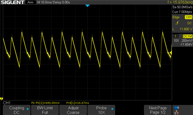

Hi folks, as my previous posts indicate, I am new to this stuff.image I bought a Siglent SDS1202X-E when it was on sale and have been trying to teach myself the basics of it (probably not very well).

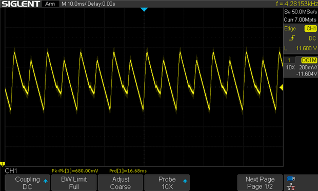

If I can, and I don't know if I am doing it correctly, I get what looks like varying frequency results without even adjusting the potentiometer that controls the drive speed.  When I hook everything up and hit "Measure", I get varying readings for the frequency as seen in screenshots below.  So,
  1. I am not doing something correctly with the scope (most likely) and/or
  2. I can't really use this scope to measure what needs to be measured (also likely) or
  3. the wild readings mean the potentiometer or something else is bad?

    genebren over 5 years ago +5
    Robert, Your setup is pretty close to correct. You might need to raise the trigger voltage level up a bit (Yellow triangle on the far right side of the screen). The level is currently set at 11.6 volts…
    shabaz over 5 years ago +4
    Also, I wonder if that's just a 12V rail, with no activity, because the 'scope says 680mV p-p, and the frequency looks close to mains frequency, if that's 10msec per division (I'm not familiar with Siglent…
    shabaz over 5 years ago in reply to fmilburn +4
    Hi Frank, I think it's likely just mains ripple, because the 'm' should mean milli - I hope!
    Also, I wonder if that's just a 12V rail, with no activity, because the 'scope says 680mV p-p, and the frequency looks close to mains frequency, if that's 10msec per division (I'm not familiar with Siglent 'scope displays). No idea why f= is in kHz though, might be a configuration issue? I think it might be supply ripple, which might or might not be normal.
    The 'scope just displays the voltage as it changes over time, however because you can zoom and level-shift, and end up looking at a magnified portion, it's good to know approximately what waveform you expect to see, so that you have that context to better understand what the 'scope is displaying compared to what it should be displaying.

    fmilburn over 5 years ago in reply to shabaz
    That is a good point.
    Robert, see if you can display the settings for the time divisions on the screen.

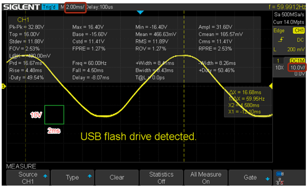

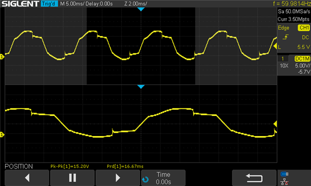

    Ugh..it would help if I read the service manual correctly.  "Use TP2 and 3".  I was on TP4.  When I use TP2 I get this:

    Ohhh, thank you. (Reading PDF manuals onscreen are a PITA btw ) I don't understand why frequency is showing in Hz and manual says it should be kHz?..
    shabaz over 5 years ago in reply to opalko
    Hi Robert,
    As mentioned, you shouldn't be looking at the automated measurements such as Frequency, until you're comfortable with what you're looking at visually, the oscilloscope trace. And you need to get comfortable with the X and Y axes.
    Take a look at your screen:
    The red highlighted bits indicate 2 milliseconds per division on the X-axis, and 10V per division on the Y axis. I've drawn a green box to show you one division, since they are faint lines on the screen.
    Now, you can look at the trace and do your own maths calculation for frequency. You can manually count how many divisions on the X-axis to go from one peak of the sinewave to the next. It's about 8 divisions.
    At 2 milliseconds per division, that means the period of the sinewave is about 16 milliseconds, which is 0.016 seconds.
    Now calculate the reciprocal of that (1/x) and you get 1 divided by 0.016 seconds which is 62.5 Hz. That's almost identical to what the automated frequency measurement at the top-right of your screen is indicating. So, in summary, without even looking at the automated frequency measurement, you can see for yourself that the signal is of approximately 60Hz simply by looking at the trace and counting squares on the X-axis, and doing a calculation with a calculator.
    I think you're going the wrong way about it if you expect the measurements to automatically indicate things. You need to first get the trace displayed as you expect. Then the automated measurement will be useful, because the measurement on it's own provides zero context. You have to look at the trace and see that it is what you expect to see, to get the context.
    Your signal is a 60 Hz sinewave. There is no reason for the 'scope to display it's frequency in kHz, because although you may have expected 60kHz or something else, that's not what is connected to the 'scope.
    Also, by looking at the Y-axis, you can see that the sinewave has a peak-to-peak span of about three squares, or 30V. That also agrees with the automated measurement. I'd conclude that you're looking at the output from an AC mains transformer perhaps, in a country with 60Hz mains frequency.
    There should be online video training on how to use oscilloscopes, and the manual should be read too. Otherwise, there can be a risk of damaging your 'scope unless you play safe and just explore low voltage battery-powered circuit for now. For example, build a 555 oscillator and use the oscilloscope to look at the signals from it. This is just an idea, others may have better suggestions.

    opalko over 5 years ago in reply to shabaz
    Thank you.  I did get the divisions figured out before you sent this..  image
    I have watched couple of them and how I got to this point image.  I am still working through the manual...
    I think this is what threw me off; I saw 60 and was thinking that was the correct 60.  My bad. It still doesn't show a change in frequency by varying R104 as the svc manual indicates on TP9 so something def wrong; unfortunately the "Yes" on the flowchart I think is supposed to be a "No" ..? which indicates replacing a chip that I don't think is available anymore: A100 or lCLM2917..
