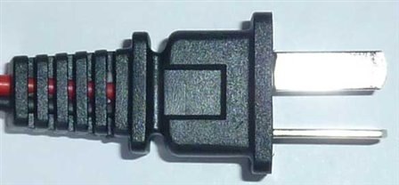

I've just bought a generator which has a 12V output, the plug which connects to this is below:
The blades are at 90 degrees and are identical: 6.25mm x 1.4mm x 18mm. The gap is 6mm, C/C (by eye) 10mm
I understand this is called a “T Plug” but I can’t find it on the Farnell web site. Can anyone identify the type or a manufacturer? image

    They're sold by recreational vehicle / boat dealers in Australia. WAECO makes a lot of these components.
    http://en.wikipedia.org/wiki/DC_connector
